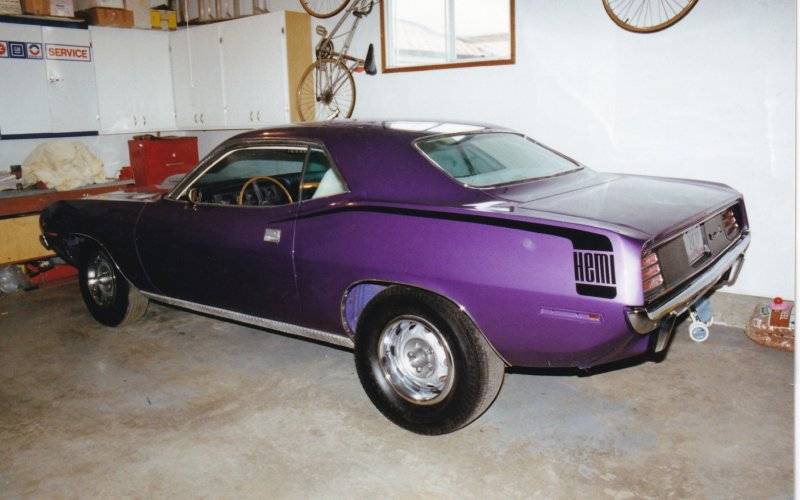

I can't remember what I paid for my HemiCuda roller when I bought it sight unseen. I think I paid $18k which was about $20k too much. I will never buy a car without laying hands on it again no matter what pictures look like. Looks good in this photo though right?
Left lock piller was shoved back about an inch and built up with bondo for a start. There was brass on the top of that quarter panel patching up a tear in the sheetmetal, POR15 covering up all the floors. That was just the start of it.
Was that car from SK ??
If that is the one you are referring to, I think it went from Sk to either Alta, or BC then maybe somewhere else.
Pretty sure it ended up in BC .. it was a 4 speed I believe?

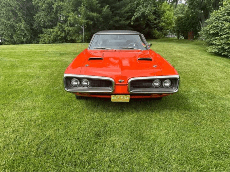

I just post the VIN from ads for possible future reference, or future searches. Also, among other reasons, I like to see ad pictures posted in case the car has changed if it is advertised in the future.
Upper one is from Facebook Marketplace ad and the lower one is a zoom-in on the license plate.
Michigan plate: NCF 534

Owner has the original numbers matching motor.
He needs to send pictures of the original block and include pictures of stamped numbers and casting numbers.
Is the block in the car an HP block or just a garden variety 383-2V from a C-body.
Is the trans numbers matching?
Are you in pursuit of a numbers matching car?
Numbers on radiator support (whatever it's called) match?
Numbers on trunk gutter match?
Ad pictures aren't good enough to assess quality of paint and body.
Were the floor panels patched or replaced?
Ditto trunk pan?
I don't like the shut lines / fit on the passenger door.
The fit of the driver's door, fender, and cowl looks odd to me. Closer inspection in person required.
The seats look like they don't have new foam underneath the new upholstery.
I would trash the exhaust pipes, tailpipes, and mufflers. Yeah, use factory hangers.
Battery cables. Ugh. Remove and replace as someone already mentioned. Make sure you route them correctly.
Sloppy work in the vicinity of the fender tag. Painted over the pitting as someone already mentioned. I almost mentioned this sloppy work the other day via pm.
I could barely read the fuzzy Broadcast Sheet, but this car came with the code J45 hood pins. Heavy duty brakes too. Maybe the seller can send you better pictures of the broadcast sheet.
How long has the seller owned this car?
He isn't mechanically inclined? That could explain some of the things we don't like, or are asking about like the floor and trunk pans.
Has the car always been in Michigan?
