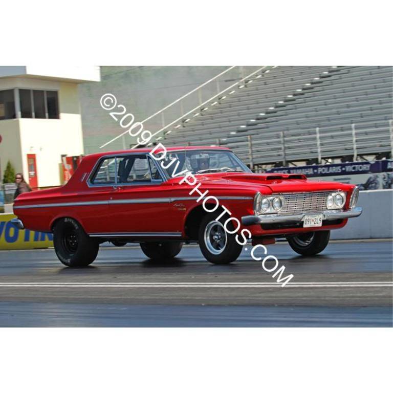

67-b-body your build is close to mine in my 63 Sport Fury but I have a 4.15 crank for 493 cubes. I use Indy EZ heads and have a dished piston for 10.6 comp. My cam is a custom grind thats close to the .590 as with 1.5 rockers it has .585 and .592 lift and its 264 and 270 at .050. But I am using 1.6 rockers. I run the Indy dual plane intake and use an 850 DP. 2" TTI headers and 3" pipes out to bumber. My converter is a 9.5 Dynamic unit that will flash about 4200 but on the line I foot brake it to 2200 to 2400. Much more and it will skid thru the lites. I have the stock power drum brakes on my car. But it launches nice as this weekend was only the second time I have run this combo and it pulled a 1.50 sixty ft leaving like I said with a 10.76 pass.
Also dont worry about not hooking on the street as my car dont hook on the street at all either. But at the track I always try to line up in the tread marks where everyone is launching and it hooks good enough to get about 6 inches of air like that. Ron
