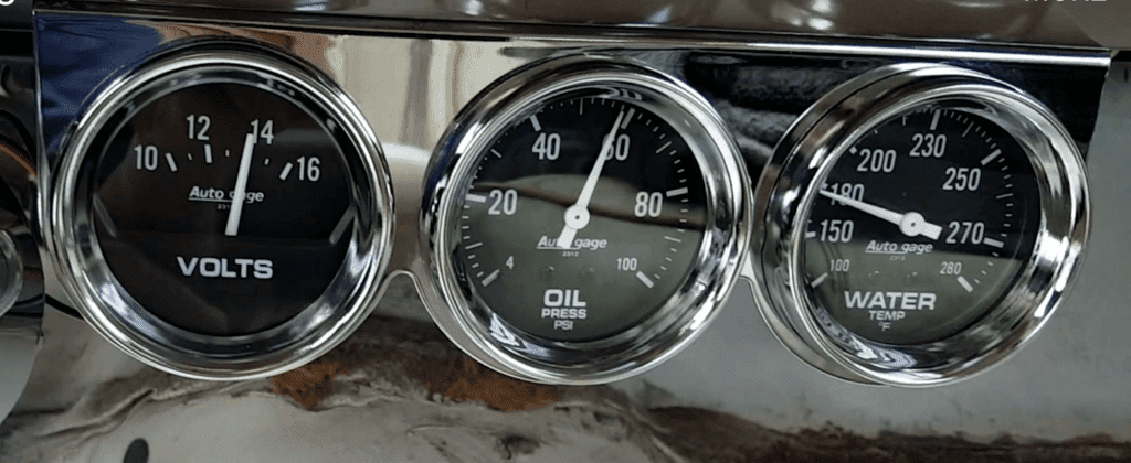

You get in it and run it a few minutes (after the engine re-primes on fuel, which it has to do every time it sits more than a day - thanks for the crappy gas EPA!), then take off after a little heat is in it (no choke, remember).
It goes down the highway really well and runs very cool (like less than 180F cool).
Once I'm stuck in traffic, that climbs probably 20 degrees or so; appears I need to do more work on the shroud/fan area, but it's nothing concerning.
