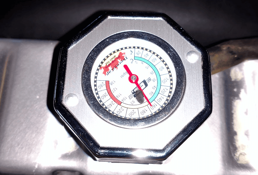

Jumped out and took this pic of the radiator cap immediately:
That says something like 160. That's probably low, too, but I'll take it as further evidence things are looking good.
(I marked the 180 with a pen smudge for reference).
