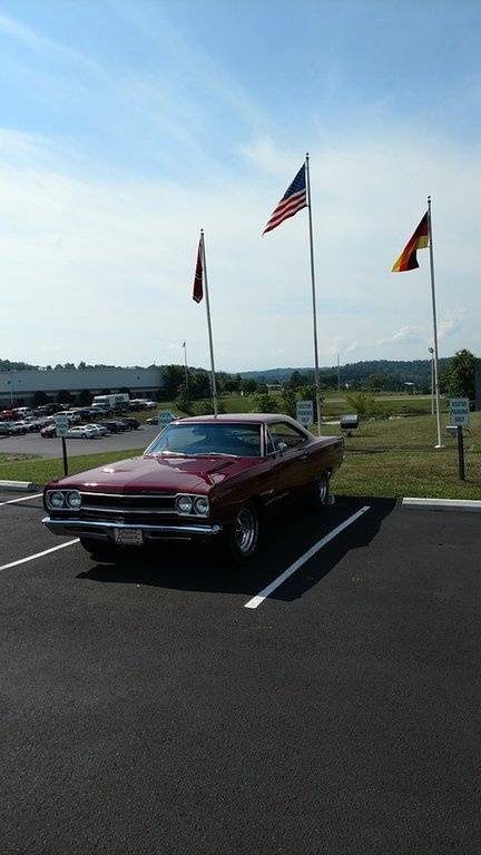

Longest so far was a couple hours last Thursday; it performed as my company vehicle for the day:
She did great all the way down there and back. :)
I made the company fill the tank, too. Hey, used for company business, right?

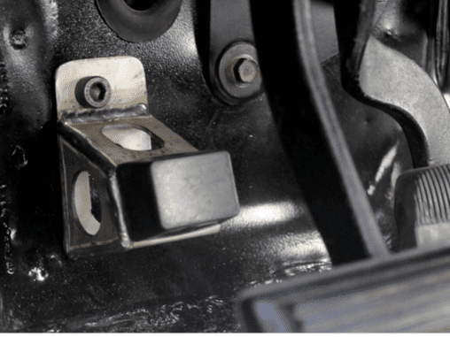

Took a lot of convincing, too, I admit. Still think the pedal level is wonky.
Don't know if I want to raise it any, though. The real danger to these (or any diaphragm type clutch, I'd imagine) is going too far past the release point and actually damaging the unit.
You (and others) sure did! :thumbsup:

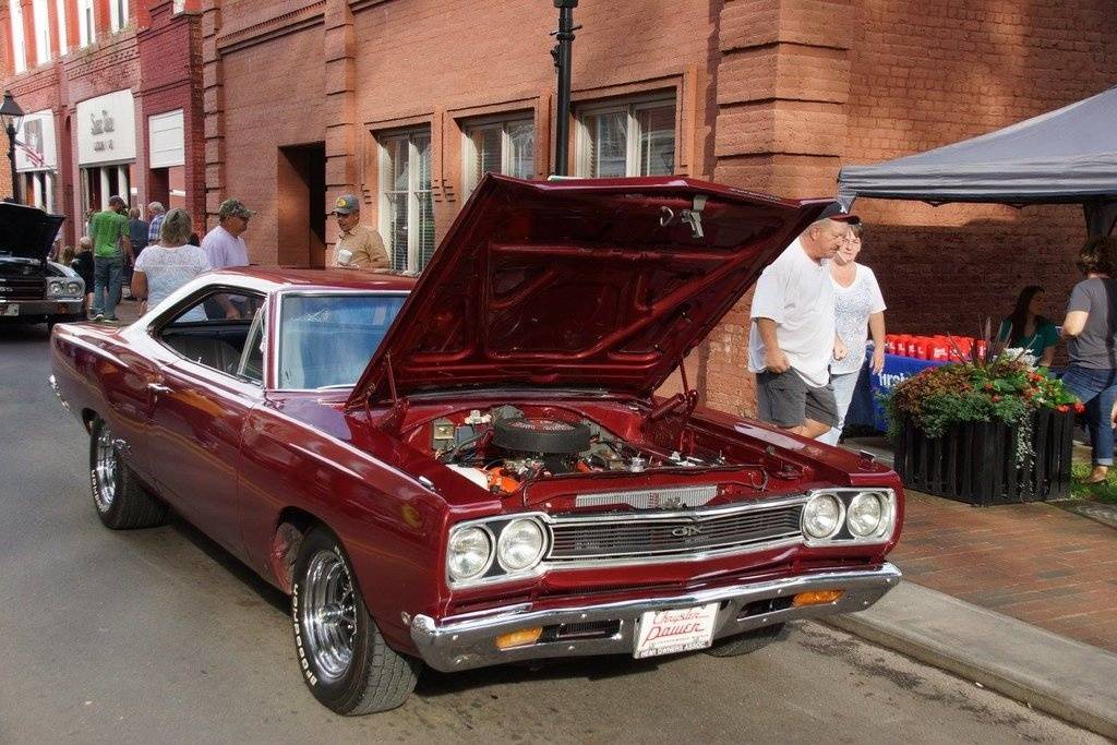

Last night at the local cruise-in:
She did great and I'm still upright. :)
