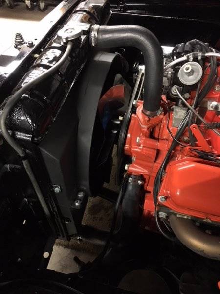

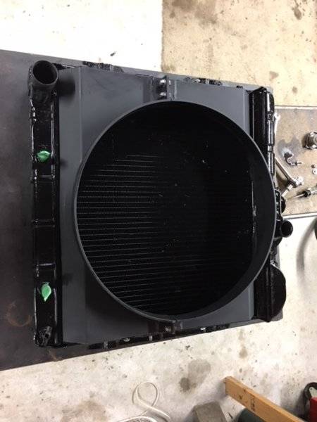

Khryslerkid...beautiful engine! I picked up a buddies old shroud from his '62 Chevy. He custom made it, but changed some things and didn't need it any longer. The pics are of the radiator and shroud last night. I plan to put on a second coat of paint today (if it ever stops raining) and give it a try. Results in a couple of days when it drys out.
The trick is to make sure about 1/3 of the fan blade is showing out of the shroud (toward engine). If the whole fan is inside the shroud it causes a turbulence that won't even pull air.

As a follow-up...I installed the modified shroud from above. I took the car for a drive and made sure to drive through traffic with lots of stops. The temp was much better controlled. It ran at 180 degrees while driving. I have a 180 t-stat. When stopped at a light, or idling, the temp climbed, but much slower than in the past. It never got above 195. Today isn't the hottest day we'll see, but it is likely mid 80's and humid. I'm going to run it this way for a while. If the problem persists, I may try my brother's fan. It has a more aggressive blade pitch. After that, high-flow water pump. Hoping this issue is done. Thanks for all the help.
