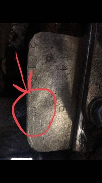

All good up to 2000 rpm. 2000 and above it’s making some noise. Std main and rod bearings? I thought that maltese cross means one or the other is undersized?

Maltese cross in theory is .001 undersize.. I've torn down upward of 50 big block Mopars... Plenty with Maltese crosses, I always have made a point of looking at the markings on bearings to see what was inside....
I've seen exactly one engine with .001 underside bearings... I'd bet the machinist measured your crank journals & decide they were Standard.... He makes more money if he turns the crank....I'm betting it's standard..

.001 or point .010? ..... .001 seems kind of insignificant
