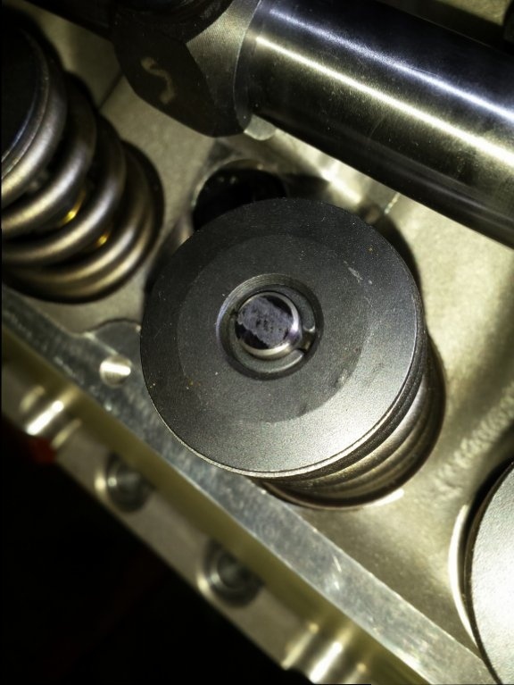

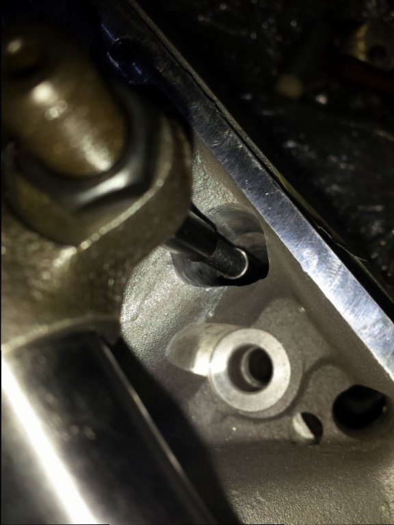

I just mocked up #6 with zero lash and spun it to full lift. Here is the swipe. Looks centered to me, what do you think? I still need to tune in pushrod length but I did make reliefs in the head for the pushrods. It makes me feel better about it.
Thats what you want. Looks good :thumbsup:

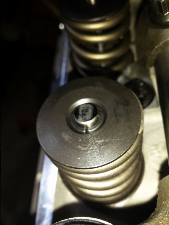

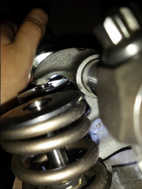

Did the same on #2 intake, same swipe. I am concerned with the lack of space between the underside of the rocker and retainer. Is it acceptable to remove a little material underneath the arm or should I try a thin shim to raise the rocker?
If it doesn't touch you should be good.

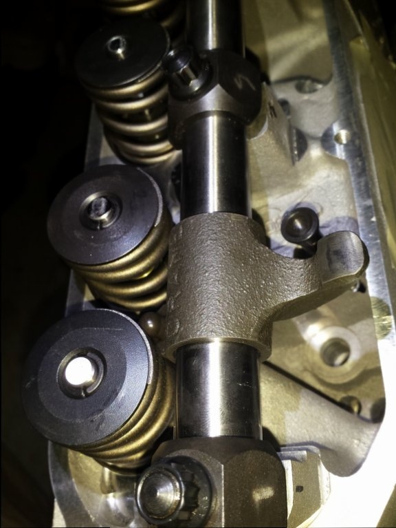

I see where they are close now. My retainers were a smaller diameter. You might see the difference in this pic.
Your retainer isn't going to get any closer than what you're showing. It gets farther away as the valve goes down, right? So if they are not touching, you should be ok.

All the valve stems are the same height as are the retainers. I checked 2,4,6,8 I/E and the intake is pretty close on all 4, on the neck just off the base. Exhaust rocker is good. I was shining a light behind it and can see a sliver of daylight between the arm and retainer so maybe I am just being paranoid.
Well for piece of mind, you could mark them and just take out a small "half moon" notch in each one. I bet your springs are wider than mine too. I seem to remember having a set of 911 Comps that were quite wide. They were too strong for my cam so I ordered a different set from Crane.
It does seem to be more of an issue of the spring sticking out beyond the retainer. I just measured the springs in the pictures and the ones that go with my cam after break-in and the ones in there now are wider so I think it will be a non-issue.
