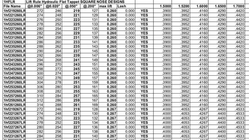

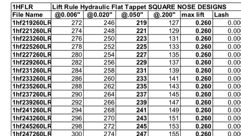

286/[email protected] 233/[email protected] with .585/.585 lift
Lobe IDs 1HF233260LR Intake and 1HF239266LR Exhaust

I filled out a Howard’s cam req. sheet just for.... fun?...
.585 lift?!
Def some strange info on this one......
Looking at the their master list.....
Dissecting the numbers.....
1HF233260LR
Group 1
Hydraulic Flat
233 @.050
260 = lobe lift
LIft Rule
So, this is a square nose lift rule lobe with .260 lift.... or .390 at the valve with a 1.5 RR.
(Did they tell you .390 lift and you thought it was at the lobe?
Or did they tell you it was .585?
Cuz....... .585 with a 1.5RR is a .390 lobe)
The highest lift hydraulic flat lobes they have are the “HM” series, which would be .3566 lift(.5349 with 1.5RR)for a [email protected] lobe.
It looks like it’s another custom recommendation that makes me scratch my head.

They told you .585?
It’s a .260 lift lobe..... so no, it’s nowhere near .585 lift.
Well, unless you have 2.25:1 rocker arms.
06721E24-8D9B-4028-BE0E-4CF72BA4379E.png D6A1B2BF-7714-4FE8-81CF-DDC941D8E686.png
Their email said .585/.585. Didn’t actually speak to him.
I posted the data from their lobe sheets above....... it’s pretty clear the lobe numbers they gave you have .260 and .267 lobe lift....... which is .390/.400 at the valve with a 1.5RR.
Those are lift rule cheater lobes for a SBC, where that’s what the stock lift is..... .390/.410.
You may want to have them review your combo, and their recommendation again.
I’m pretty sure you’ll get a different answer/recommendation.
Someone just plain screwed up on that one.
I see, wow. Yeah I’ll do that. Thanks
