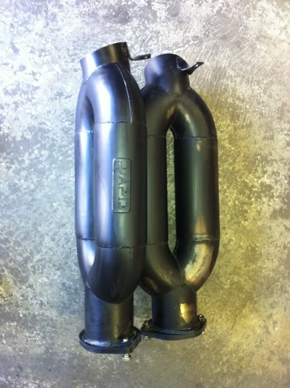

747, a custom car building place I work at on the weekends make these mufflers.
they dynode them versus a dynomax ultraflo and picked up 6hp and they make an insane exhaust note.
easy to build yourself too.
the internal has a auger shape spiral going through the straight section which is stitch welded to a bit of hollow stainless tube which is then stitch welded inside the 3" stainless pipe then the half donuts are welded on.

You really gotta get a video of a car with these on it Benno we gotta hear those!
First vid is of mopar sunday here in aus a few weeks back, the red valiant has those mufflers on. my mates car has them on too and his sounds way better, but still good.
