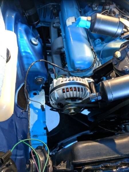

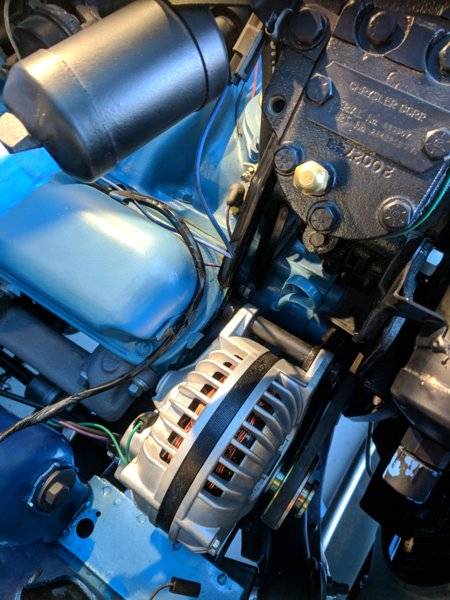

Ok alternator in and tight.
Did you get your alternator bracket figured out Brian? I can take a photo of mine if you need.
Yes as much as I had that alternator on and off as a college student you would think I would remember. I found I have 3 spare alternators... 2 square backs and one round like this repro. I used to have them in steady rotation from car to electrical shop and back... Dixie horn I think was frying them.

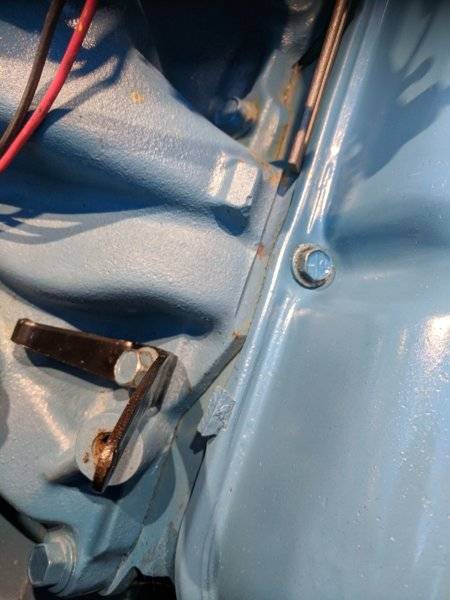

Figured out where these two bits go... Finally
Throttle spring mount above and repro positive battery frame bracket below.

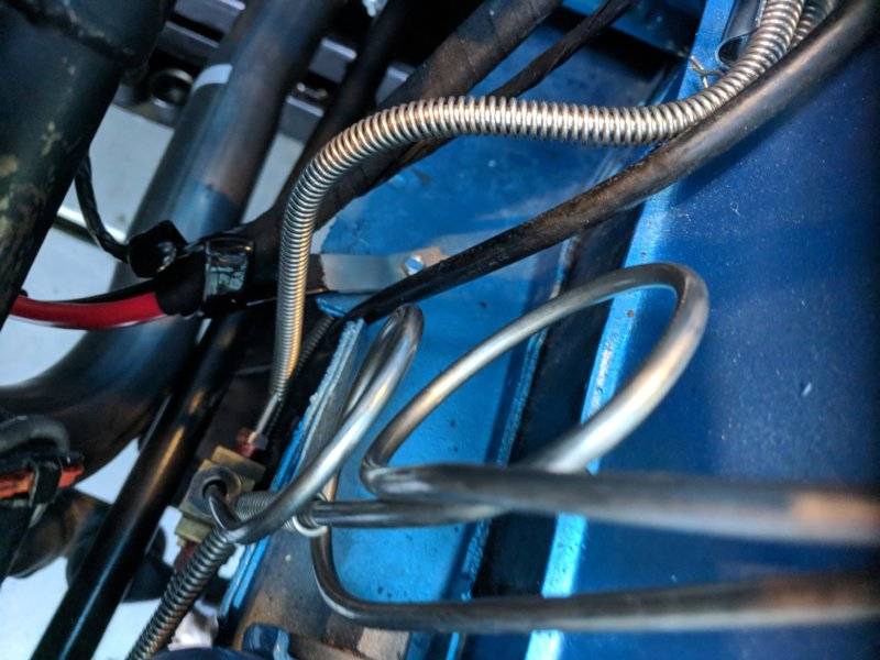

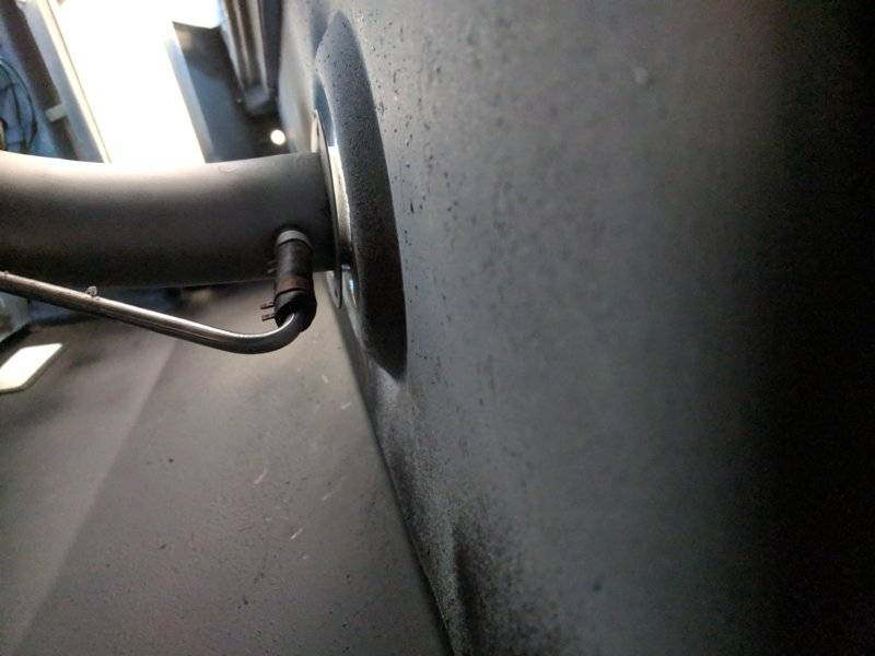

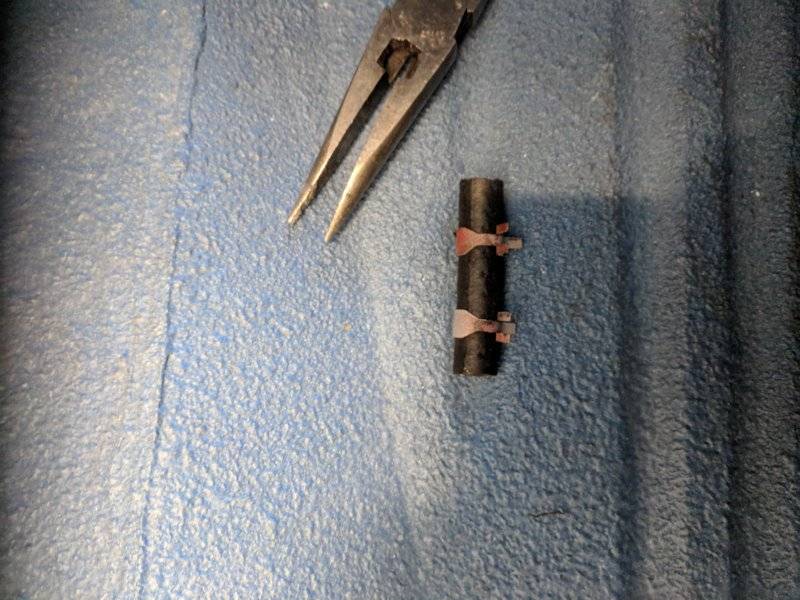

First the correct size fuel line for the vent line. 3' of line for 2" of vent line. Sweet!
Amazon order just showed up got two things I needed.
First the correct size fuel line for the vent line. 3' oh one for 2" of vent line. Sweet!
Restoring these old cars without Classic Industries, Year One, eBay and Amazon would consume too much of my time looking for parts. Thank goodness for them delivering right to my door!

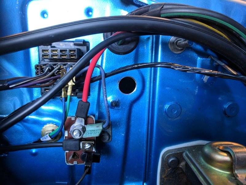

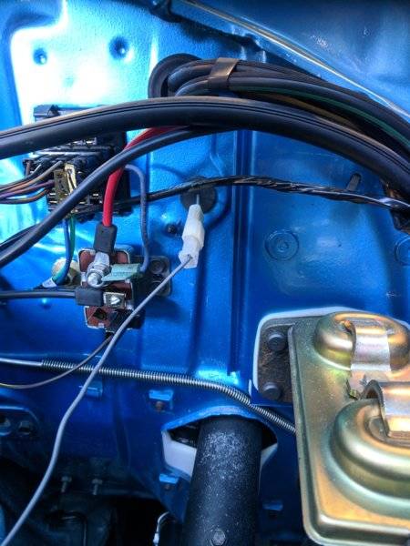

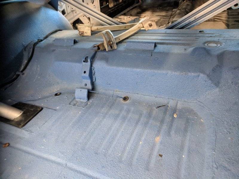

And here is what I did with it...part 1

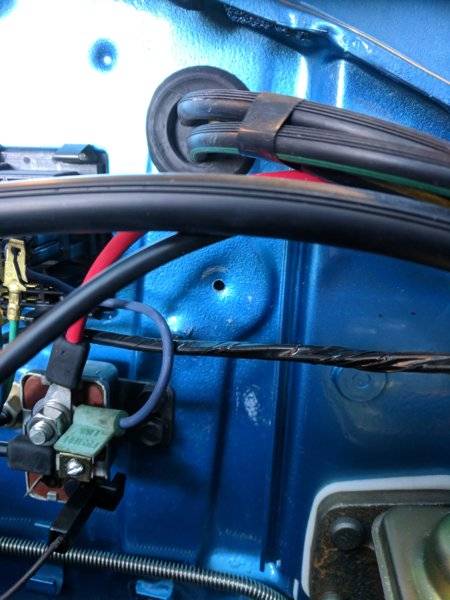

Tach wiring hole.
I drilled a pilot hole.

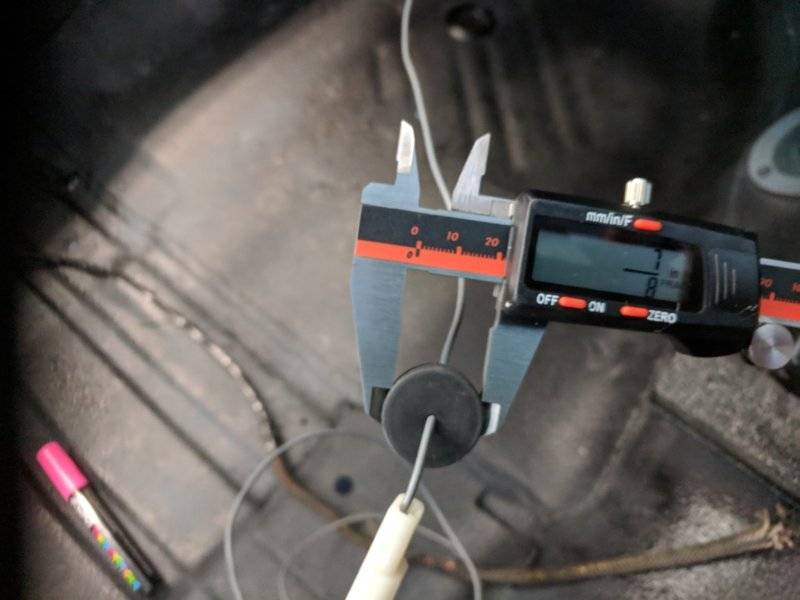

Measured the grommet

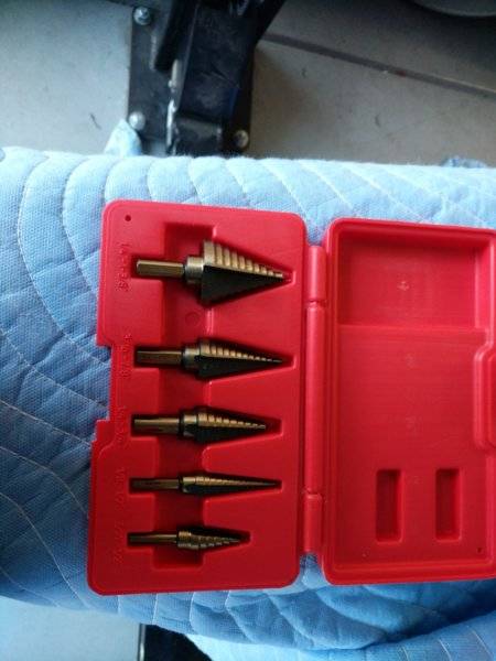

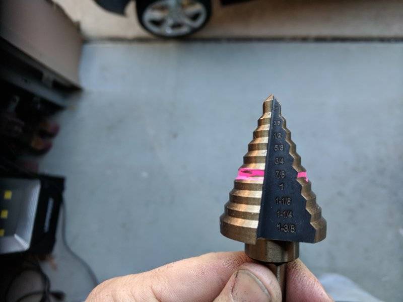

Marked the step bit with wash off paint marker so I know exactly how far to go.
Oh and before I did any of this I checked the back side of the hole to make sure I wouldn't hit any thing.

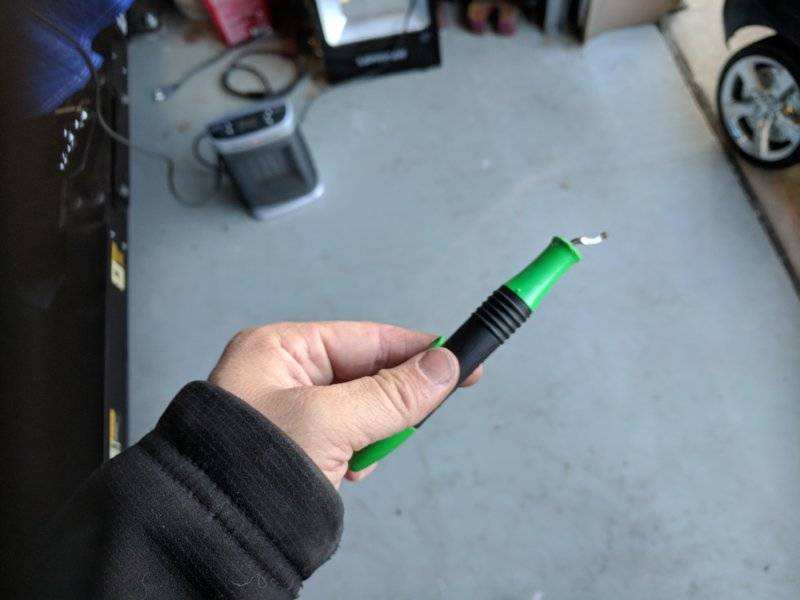

Then deburred the hole with my tool and installed the line.
Part 2

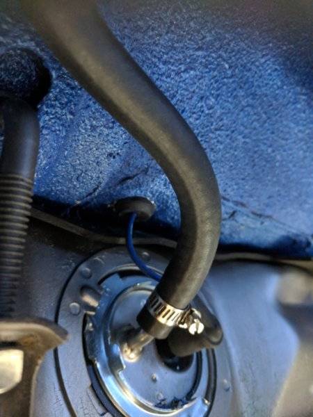

My long-lost hole for the fuel sending unit wire.
I'll spare the details other than to say it was a 3/4 inch hole and I had to be very careful drilling around the gas tank.

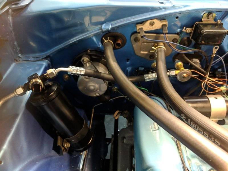

Got more AC lines and stuff plus I dropped one AC line off to be rebuilt at classic Air in Tampa. Get that back in Feb.

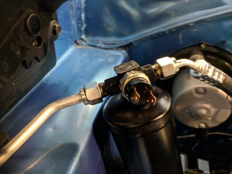

I don't understand what this pressure sensor is doing in the receiver. I assume I can just remove it.
Finally I need this AC clamp. It seems it is not reproduced. Anyone have a source new or used?

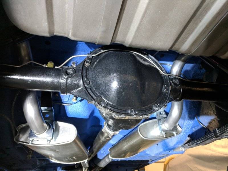

I was reminded as I went to fill the rear axle that I have no idea what axle I have.
See the photo in terms shop manual of the three types.

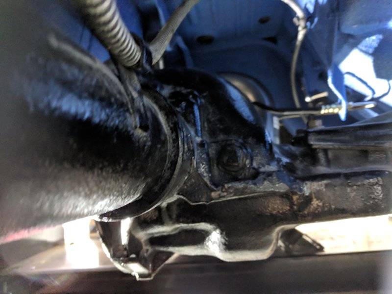

Then see I have no fill hole on the cover.
I do have one on the side (which grease came out of when I opened and seems awfully low relative to the tubes.
Build sheet has a 640 code for the axle, when Wayne Wooten of the Charger Registry decoded it he said that it is a 2.76 gear in an 8.25 axle. But an 8.25 axle isn't even in the shop manual.
So what exactly do I have and what's the proper fill amount/location?
Looks like an 8.25 to me....always fill to the bottom level of the plug hole......
The gear submerged in fluid is whats important, not the axles.......
