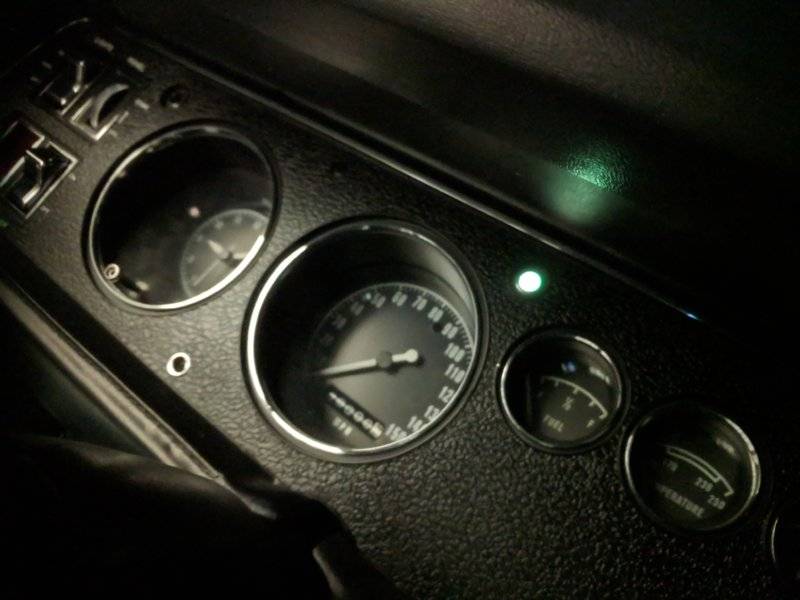

Also noticed this yesterday... Not sure what to make of it yet.
So the right turn indicator is on on the dash and one of the left tail lights is on...it's possible I have the indiscators backwards in the dash and a bulb out but I don't have the front end even connected so not gonna worry about it too much. The wiring from the trunk siganl switch to the main harness seems to be right as I did check that.

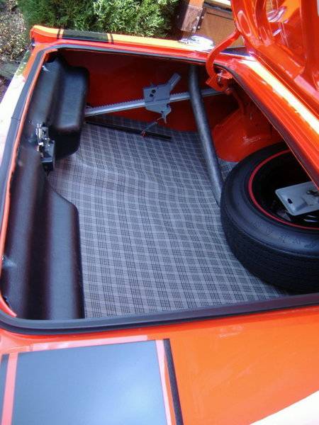

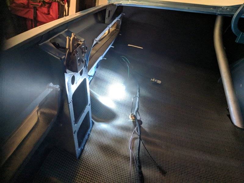

I cut the trunk Matt and installed the jack.
I feel like I'm missing something. Is there a bolt on something at the low end on the floor board?
I assume I did the spring correctly too.

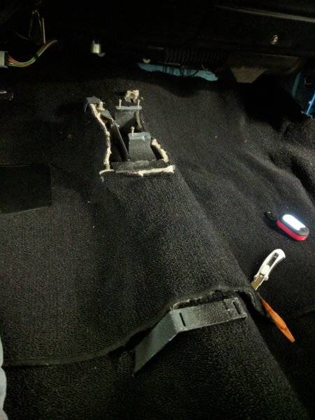

On to the carpet. Last time I did this (on this car) I was 17 years old. Much less of a hack job this time around. Just going slowly...
Think I will let it sit and flatten out a bit more before I cut the seat and belt holes... Not trimming the edges until much later.

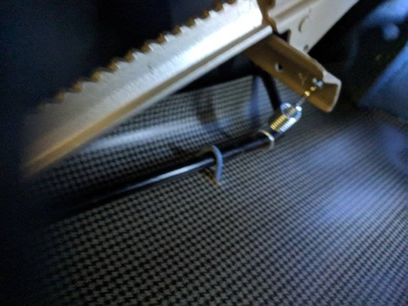

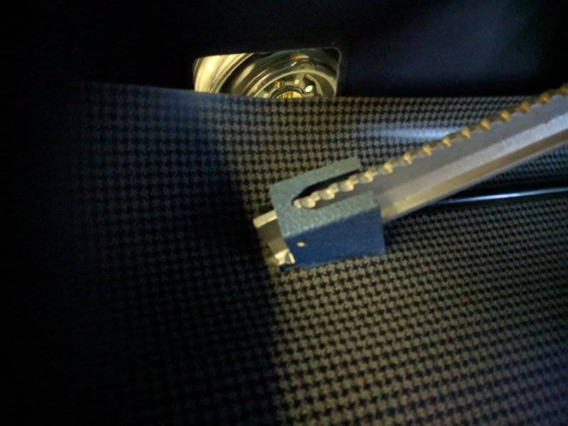

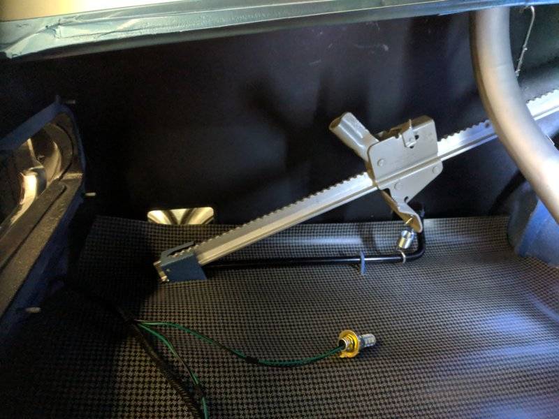

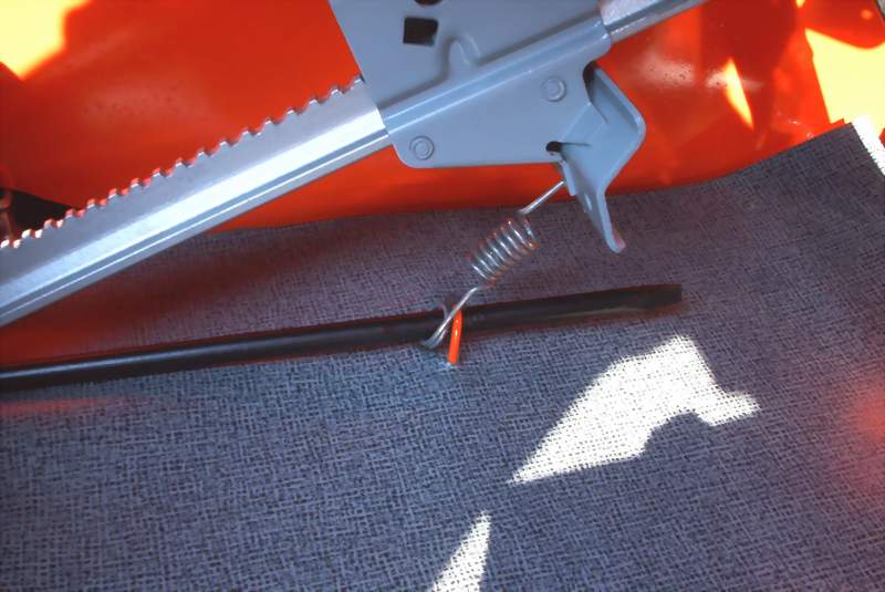

Jack is in backwards.......the lug wrench bent end fits in the bracket slot and the jack post wedges against that. The spring "hook" end hooks as in the pictures...

Spoilsport?.....Just helping a friend to install the part properly........Or would you rather have his lug wrench fly over and pop a big ole dent in his quarter. When he slams on the brakes or takes a harsh turn? Now that would be a spoilsport.....That is why it fits in the slot and why the slot is there in the rear bracket....
Or should we just be a bunch of bullshitters and say, "way to go, looks great". Wait there is a forum for that and glad it is not this one.....:D
Or should we just be a bunch of bullshitters and say, "way to go, looks great". Wait their is a forum for that and glad it is not this one.....:D
Ur correct, sorry, the cold got to me!!

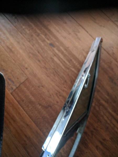

Then I started on the vent window frames. It Hought I was doing well until I discovered my rivet worked didn't trunk out so well on the opposite side.
I have a spare frame but it is pitted a little. So not happy with my options. So upset at myself. I JB Welded the passenger frame in so we will see if I regret that.

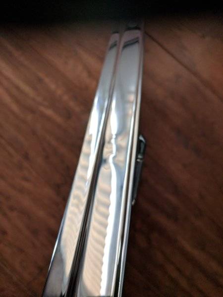

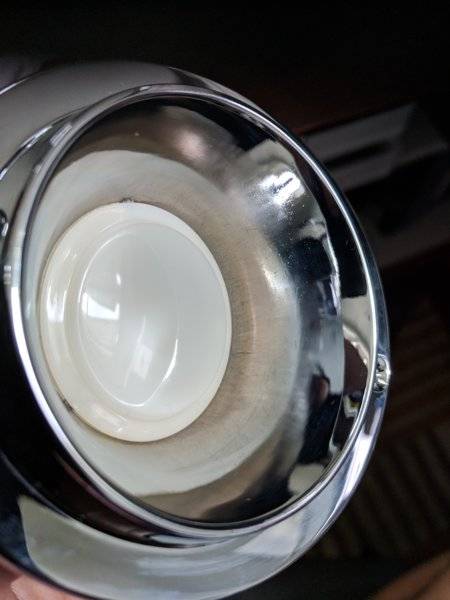

Then I moved on to the console. But here are the new repro lights. The chrome just isn't there at the deep end of the light. Gonna be going past Brazelton tomorrow so will see if YO has some better ones in inventory for an exchange.

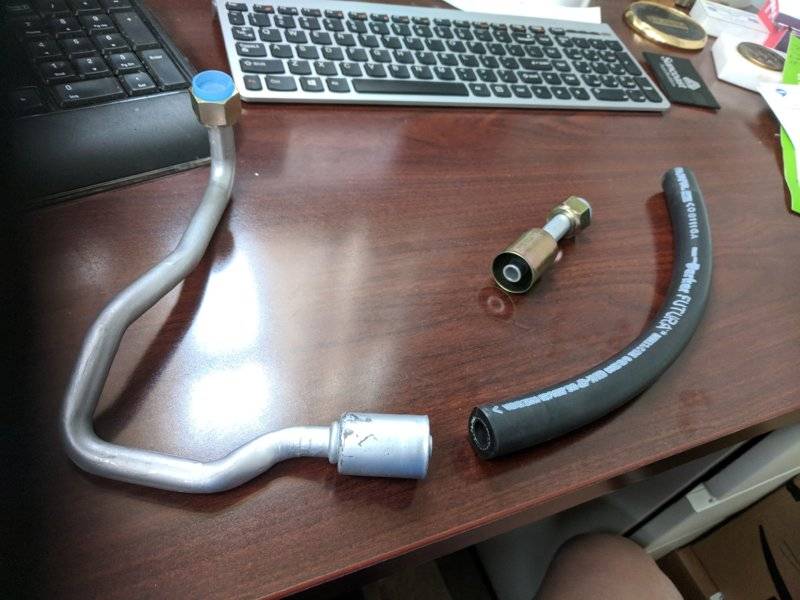

Then I bought what I thought was a new repro AC line from compressor to condensor line. As I looked at it was all scratched up and was quite obviously and old line that had been reused with new rubber. Which I am fine with generally. But then I simply pulled the rubber right off the line so it was never crimped. And same with the other side. So am pretty upset about that. Not gonna bother fighting with the supplier, but if anyone wants to know who not to use let me know.
Wednesday I pick up my other AC line I had restored by ClassicAir in Tampa. Assuming that turned out ok I will have the same done with my original line for above. Thought I was saving some $ instead got crap.

Everything is fixable and not installed...Imagine if that line was installed and you pressurized the system.....
