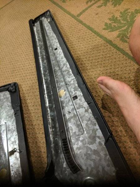

Well, not sure what to do here. Repro weatherstrip/stainless moulding for the rear quarters needs to be secured to the repro upper door pad.
Originals we're stapled. Repro weatherstrip has holes for screws. Repro door pad has no holes.
Afraid to drill and screen the holes as I'm not sure the dashpad will then go over the inner panel that bolts to the inner door panel.
Thinking maybe about epoxy. Anyone deal with this yet?

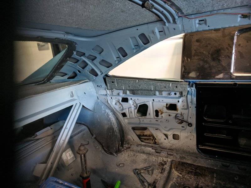

I installed the inner door panels. I did check before I put them on that drilling and screwing the weatheratrip to the upper door panel should clear the inner panel, but will save that for later

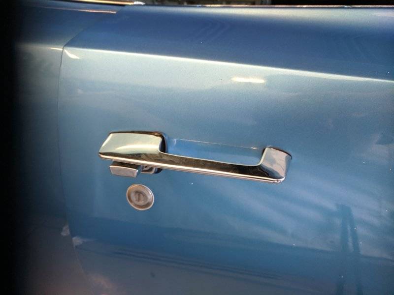

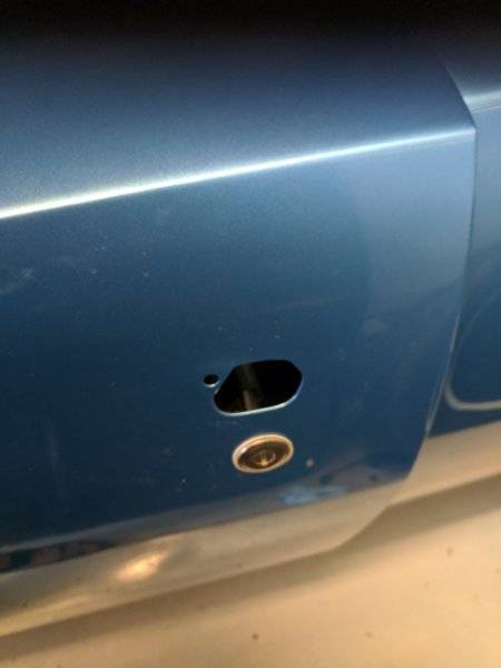

Today after work I out the door lock cylinders in, but discovered I need to find the hardware for the lock linkage to the door. Have to consult @moparnation74's thread to see what they look like. I'm sure I have them just didn't label them good I guess.

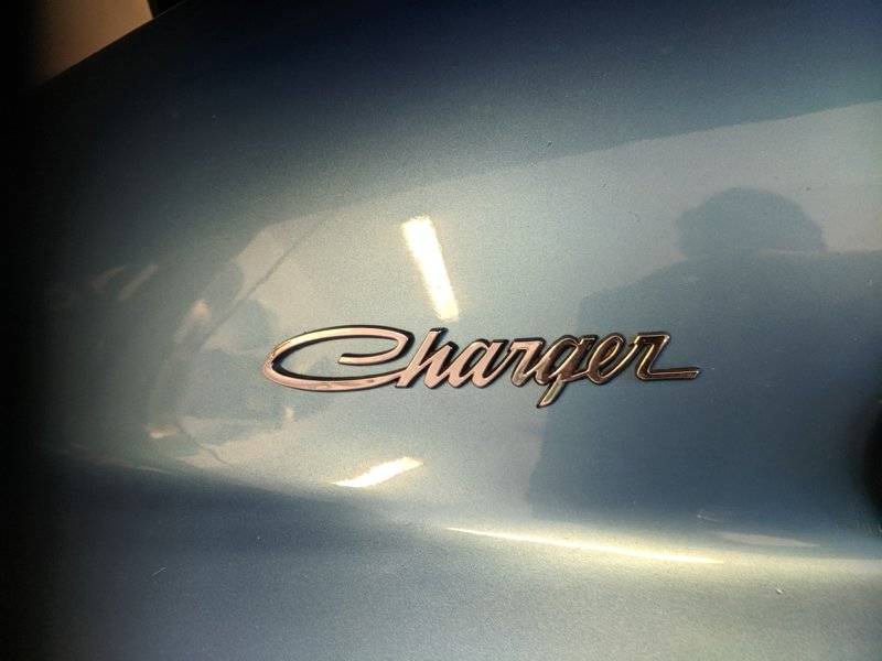

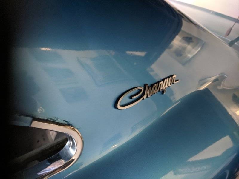

I did have the hardware to install the sail panel emblems and will need those on prior to headliner so went for it.

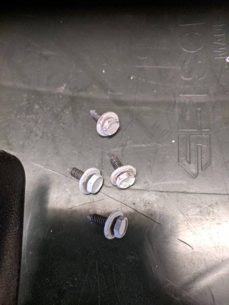

Actually your post 849. Do you have a closer shot of the door end? and or specifically the the two screws/bolts that hold the lock lever thing to the jam. thanks.

Was more goofing off then anything and found this suprisingly easy to put on.. will have to mess with the rest later.
Brian
It didn't dawn on me until I was searching for pics.....The Plymouth line did not use that mechanism. That was a charger specific item. I searched through the restoration photos I have on my charger but I wasn't as detailed at that time "pic wise"....
The you pictured above are the correct bolts......

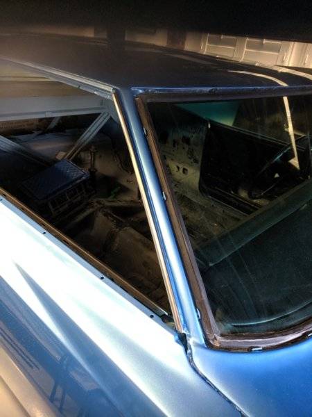

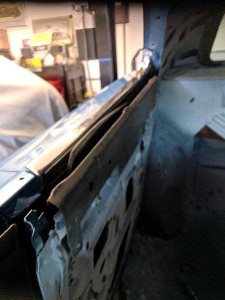

You'll see 3 locations on the inner frame this clip onto that are -bumped out- a bit towards the outside of the car.
I set the pads over the top and marked the areas that would have less clearance.(as to not put rivets there)
Then took flat vice grips and clamped the fuzzy to the door pad, drilled and attached with black anodized rivets.

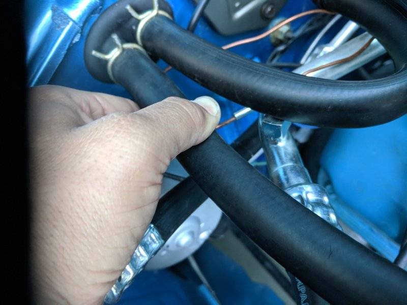

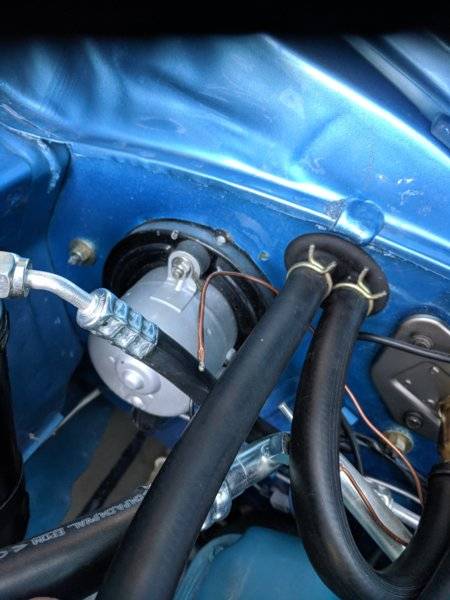

So when the car was at the paint shop I had them tube the motor, but they found two sizable coolant leaks. One from. The heater control valve, which I bought a spare and replaced, if that doesn't work I'm going to follow @showard's approach and have Classic air fix the one I took off.
The other leak was from the heater nipple on the intake. It wasn't great when I did the car 23 years ago and I should have replaced it this time, but I wanted to create more work for myself. So intake came off and had it cut out and replaced it. Got the intake back this week so now all back together.
When the wife gets back from the store where I asked her to grab some more coolant I will fire it up and see how I did.

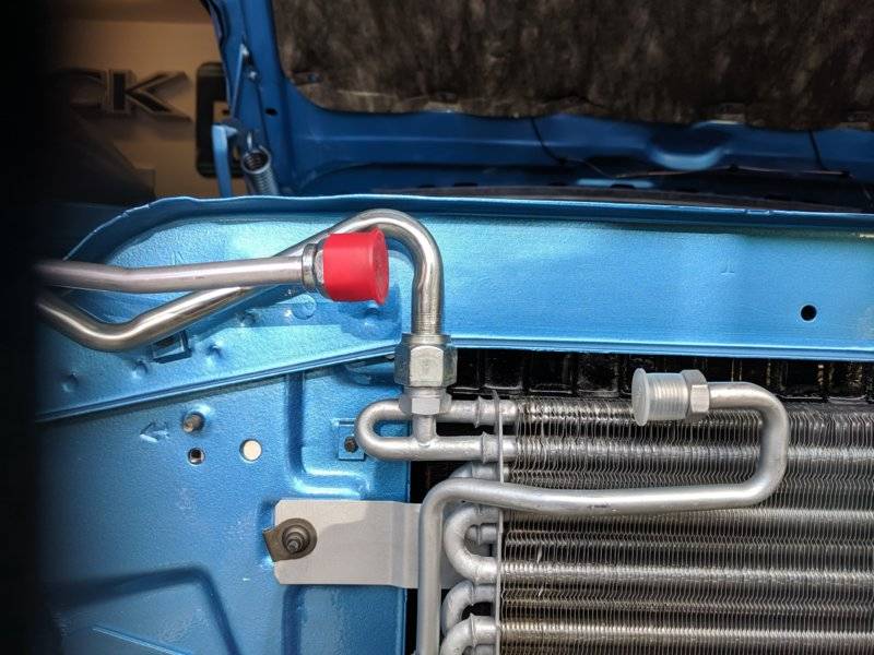

Think I'm gonna have to stop by Classic air to get a rubber grommet anyway for the AC thing here.

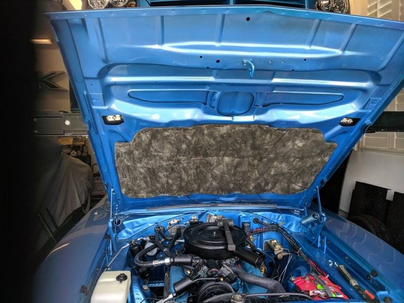

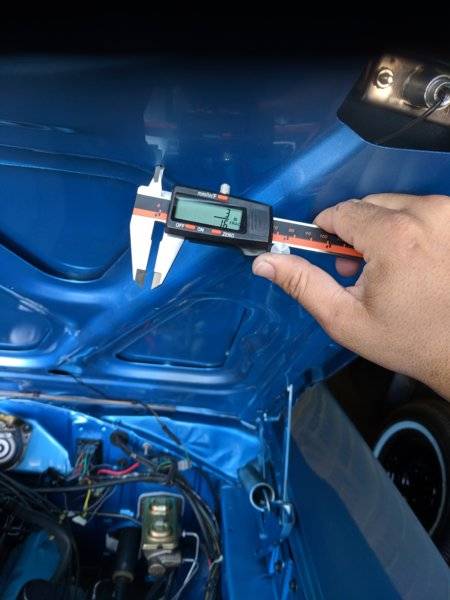

Went to install the hood pad... Holes for the clips on the repro hood are 3/16.
Holes in the OEM hood are 1/4.
Had to drill them out... That's scary trying not to dent the hood, or nick the turn signal wires but it seems I did ok.
That's a royal pain in the:asskiss:
Got to go scrub off all the fiberglass and change my shirt.

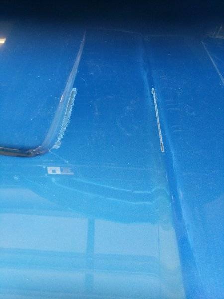

Hood now needs to be repainted:mad:
Could have been worse but so pissed. It scraped on the bottom of my lift.
