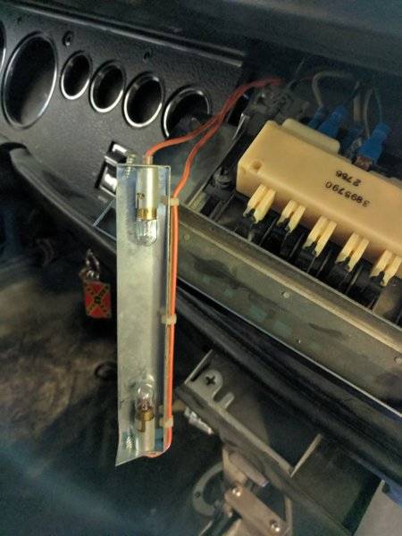

While messing with the wiper motor I noticed the vacuum tubes we're poorly run and interfering with the under dash wiper arms. So fixed this and while having that out I replaced the bulbs in the control panel as well.

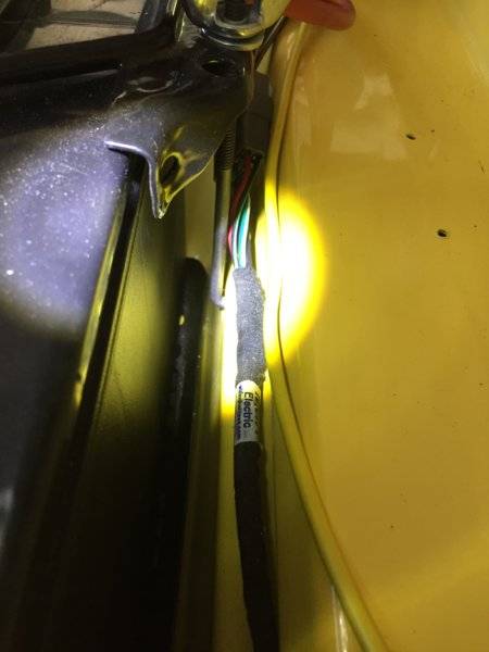

Brian, I didn’t know if your car is like mine. My car has a hole in the fender well where the shorter battery hook hooks into.

AH HA!!! Thanks!! Mine was all rotted out in that area so we had a patch made. I suspected I might be missing a hole. Any chance you can get me a bit more dimensions?. Looks to be about 1" behind the hose for the harness clip and maybe a 1/4" diameter hole. Probably not critical, but ..
Sure,
The measurements from the wheel side are:
11 1/2” back from radiator support.
3” down from the top of fender well.
3/8” hole.

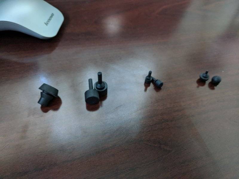

So I bought this body bumper kit. I'm trying to figure out where these bumpers are used specifically.
I'm pretty sure 2 are for the rear valence as license plate bumpers.
Thinking one is for the front plate.
Note I already pulled the hood, door and trunk bumpers that I know where they go. Not to say that these may be for those area as well but pretty sure I got all the hood ones at least.
Can any one tell me where they may go?
Actually disappointed with this kit...it's going back... I don't think I got the rear valence license plate bumpers (or just one at the far left) looking at other kits online and going out to my car I feel like this kit is not complete.
That said I still need to know where these go

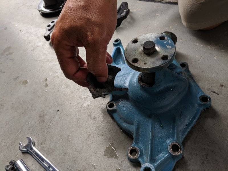

The water pump was definitely a problem.
Unfortunately new water pump leaks profusely. Perhaps the gasket slipped. Will try again tomorrow, but very disappointed as it was a LOT of work for no success.

The gasket could have squirmed.....How does the housing mating surface look?
https://shop.advanceautoparts.com/p...VirbACh1r6wKwEAQYASABEgJuyfD_BwE&gclsrc=aw.ds
Let it sit 24hrs at least before firing up.....
The far left goes on the bumper the 2 bigger ones go on the valence....The 4 smaller ones I just cant recall at the moment.
It's a repro valence and the two bigger ones are too small for the holes in the valence. the far left one fits perfectly though?
Do those 2 have numbers on the top?.....IIRC its been awhile but the far left goes on the bumper and I though the valence had 2 taller ones similar to those two.....

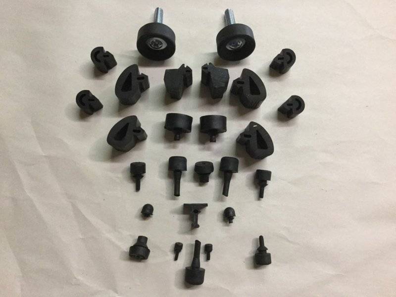

no numbers, I ordered a different kit (at least per the photo) from a different supplier so we will see, photo below of the newly ordered kit from their website. same part number as YO but a lot more pieces
I still have not figured out my round bumpers from a similar kit that I bought. Maybe the smaller ones are ash tray and glove box bumpers. I know that the bigger ones go to the trunk, hood, and doors.
