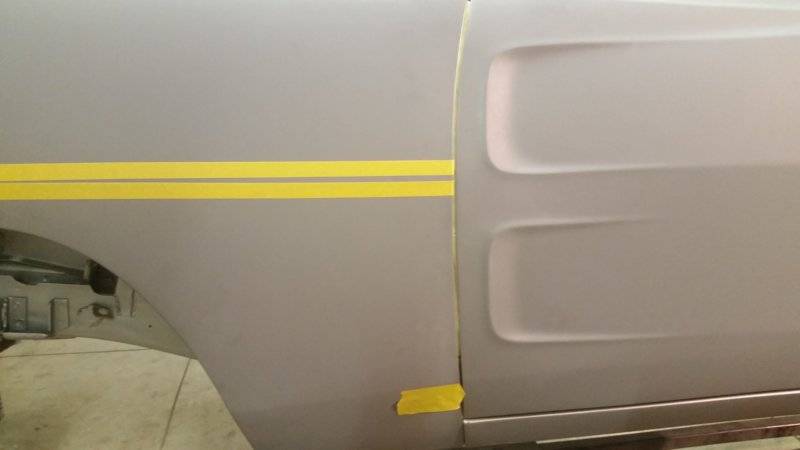

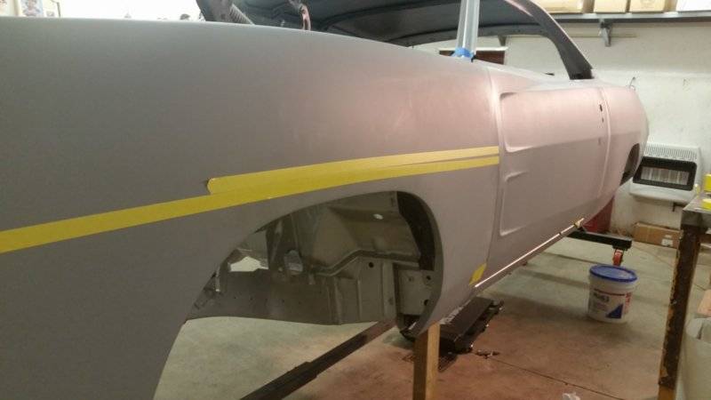

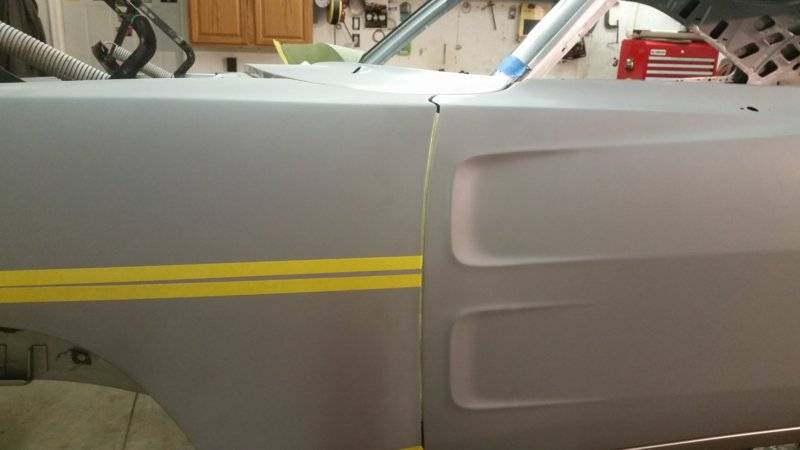

got it on and shot some 2k primer on it and center body line was stamped with a curve in it so it was 3/4" lower where it met at the door, so that means I bought it after its primed. So they hammered and dolly for a several hours and worked it back to where it needed to be, would have been easier to patch up the old fender I had, but I did learn some metal working technics. bottom tape shows where line was and top piece shows where it was supposed to be. School is expensive. good luck!

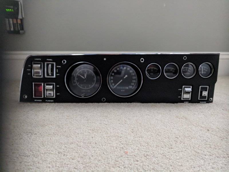

So I finished restoring the instrument panel...

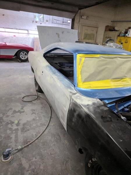

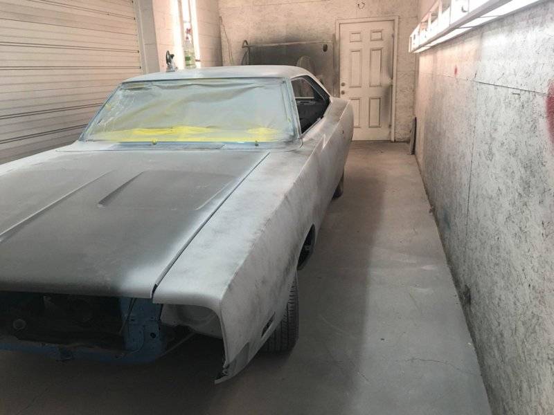

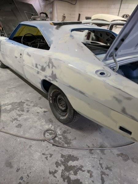

Finally making progress.

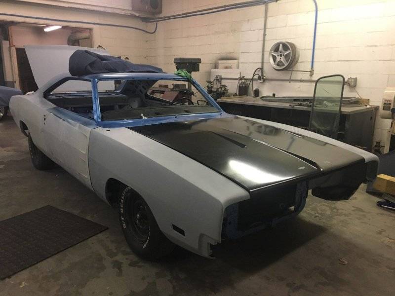

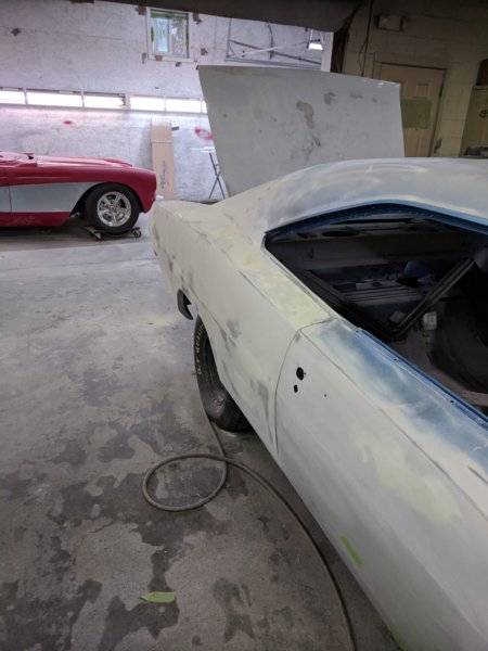

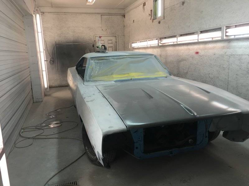

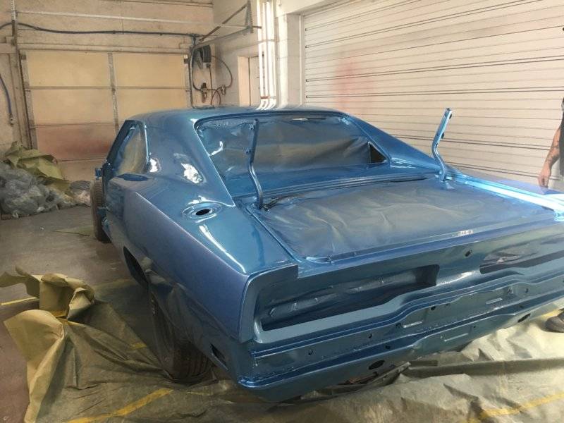

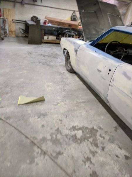

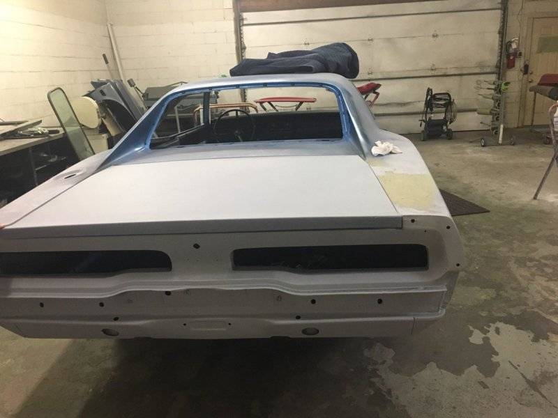

Hope to have it in primer this weekend and color early next week. Then they will put in the front and rear windshield and then it comes back to me for assembly... excited. Ordered some more stuff from Classic Industries that will be here soon and have enough in hand to stay busy for a while.
They had to cut a section of the old fender and weld it into a section of the repro fender to get the gaps right. You can see it in the one photo. They've been struggling a bit with the repro quarters that we're put in 15+ years ago in a less than perfect way, but I think they got it pretty close now.
Looking very nice!!
Don't let them put the front windshield in before the dash frame goes in, it could get sporty.
