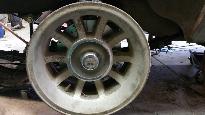

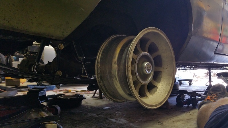

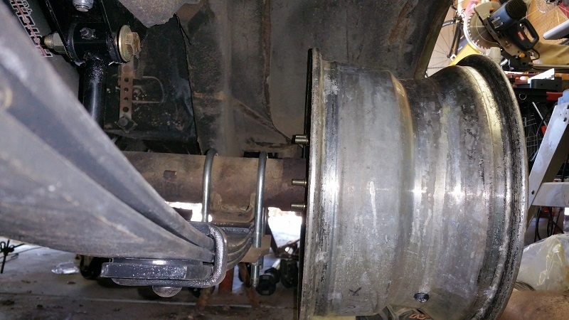

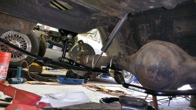

Busy Day. Sure Grip 3:23 Pumpkin installed, with 1350 Flange. Axles installed with Green Bearings, Rear Rotors installed and 15 inch wheels tested for fit and back spacing..
Rear Rotors.jpg Bullit testing.jpg Bullit testing 2.jpg Bullit testing 3.jpg

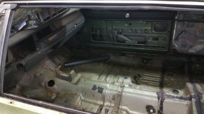

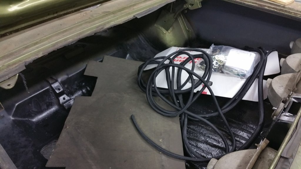

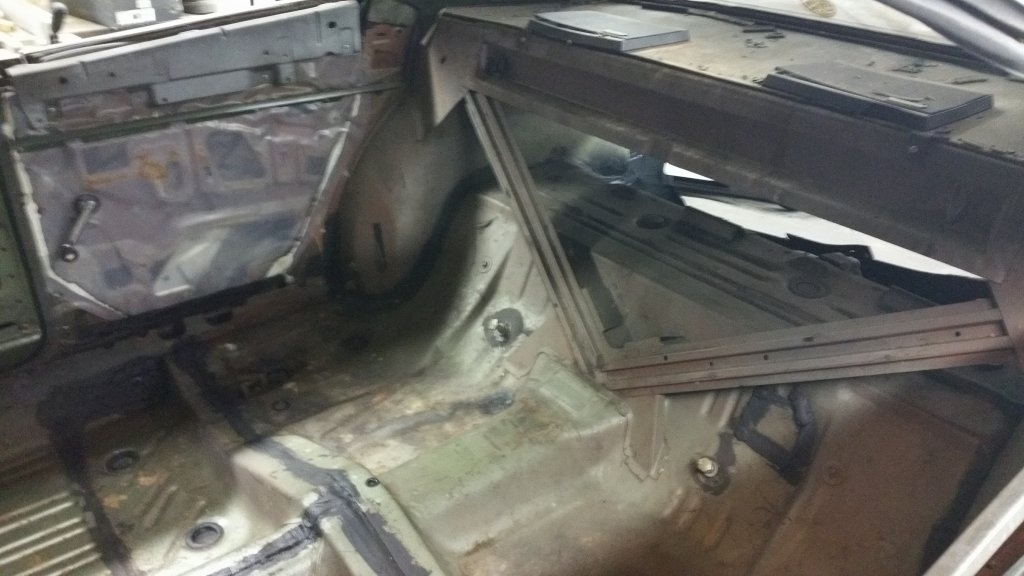

Started pulling the interior apart.. Footwells are solid, trunk not so much, Rust encapsulation applied to the trunk floor. Paint applied to underside of trunk before refitting tank.
More interior disassembly and wheel painting!!!

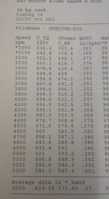

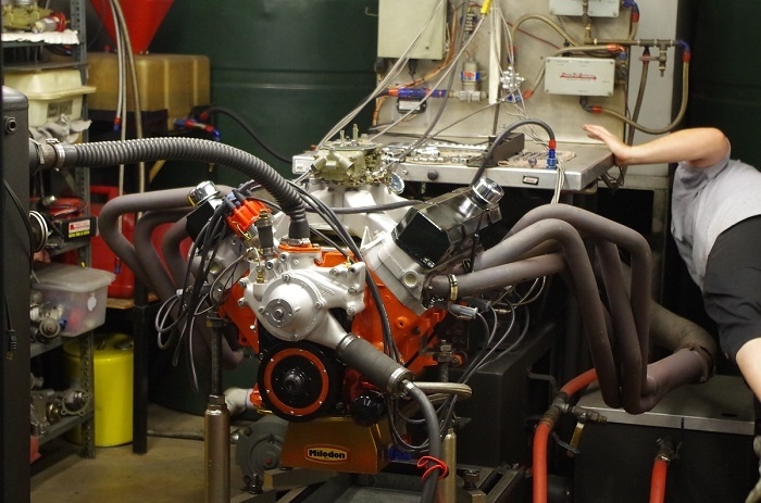

Engine on the Dyno and getting ready to make a run!!

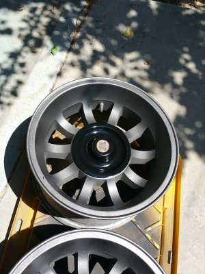

Wheels almost done, painted in between the spokes with a flat black and wife is going to paint the Red centers..

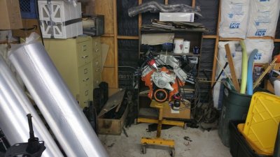

Engine is home from the Machine Shop
Intieor all stripped out and harness read to start going in

Started checking out the American Autowire, VERY IMPRESSED!!

Good #s on the Dyno Looks like we have about the same HP, but you defiantly got me beat on tq. You almost made 700 ft lbs! You better get some wider wheels!!!!!!
Yeah, trying to find a 15x10.. But still won't be enough..
Trying to stay with the Vectors?
They are Western Bullets.. Yes, but if I have to change it will be 17 inch Magnum 500 style wheels.
