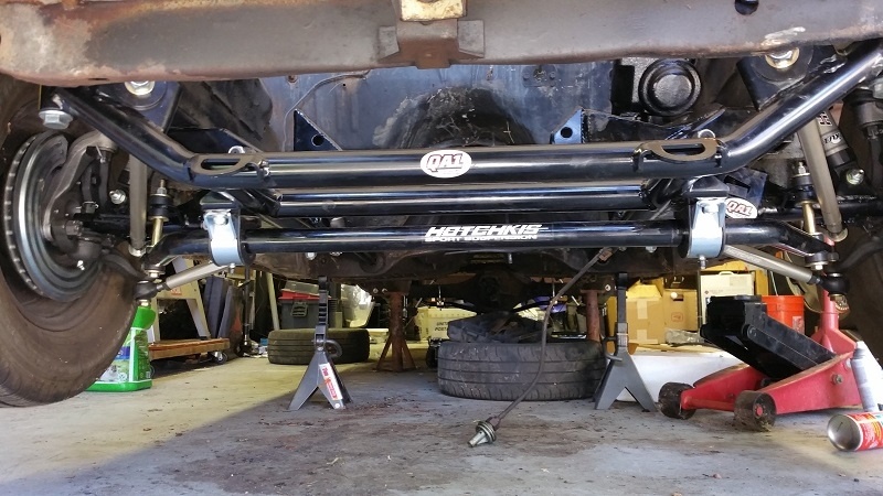

QA-1 Subframe and Borgenson Box in. Most of left side suspension in..

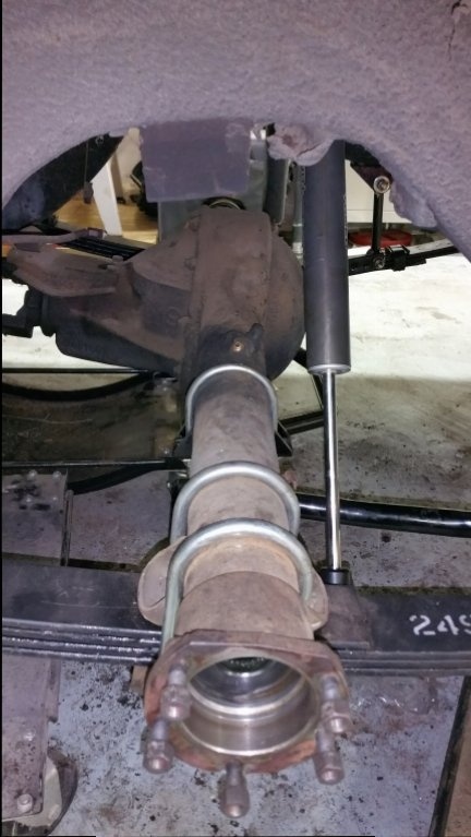

Rear shocks in, need to get bearings pressed on axles and pumpkin swapped.

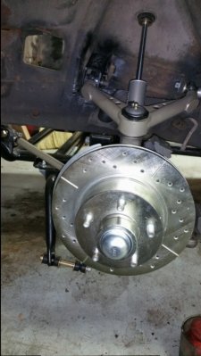

Left front side mostly done..
