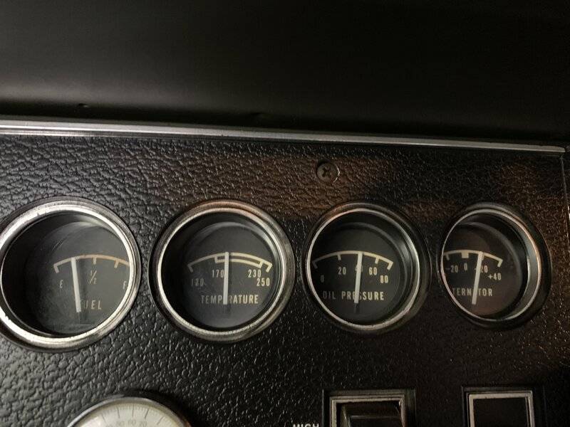

Last year before winter my 1969 dodge charger r/t 440 automatic had serious overheating issues at idling and city traffic.
When going 80 mph on the autobahn there was no issue.
Unfortunately due to time and weather i wasn't able to start working on this until today.
So i started it up and let it idle for about 20 minutes and the problem is GONE. (Without doing anything)
See attached picture.
I noticed the fan clutch made noise last time the issue occured and today it did not.

Added the picture in the first post. :)

You sure you don’t have air in the system ?
When was the last time any of the cooling sister components were replaced ?
I think you had some air in cooling system. That pic of gauges looks exactly like mine.Cross ur fingers, should be OK.
