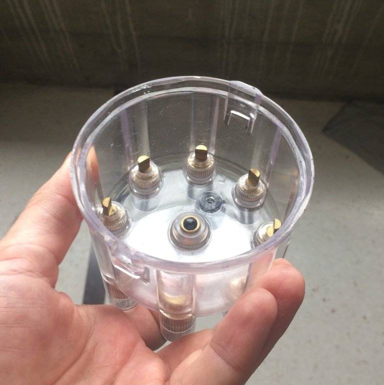

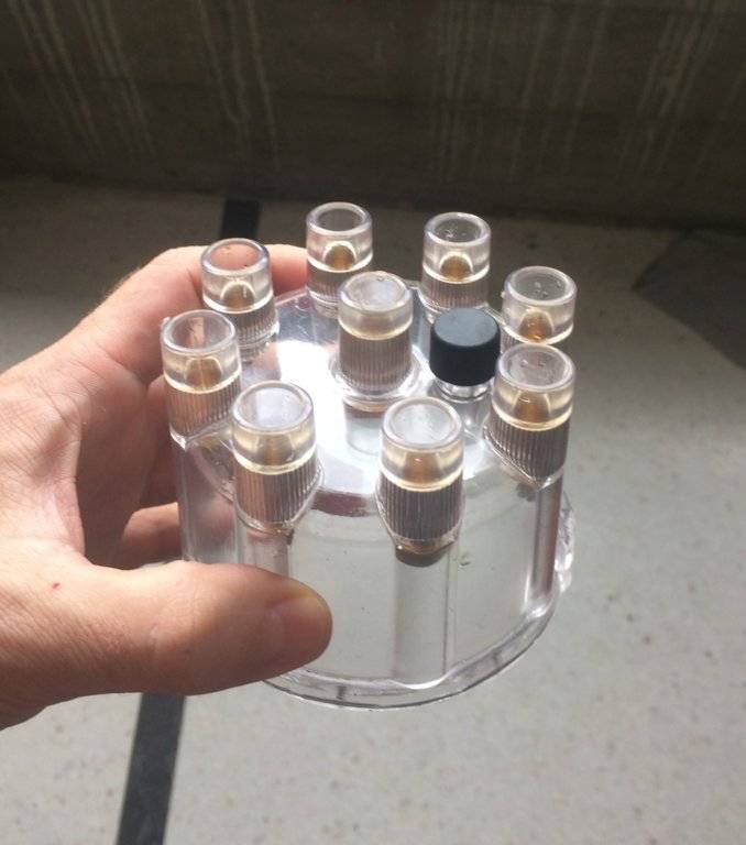

Get a clear cap and check it while working
They are available even with copper terminals! Well or maybe I have being lucky getting a couple of both locally!
Good call was going to say a nos mopar or accel.
Thanx guys for your help. I am getting 9volts at my coil so my aftermarket MSD blastor 2 should be ok I think and not causing the problem.
Actually it seems to be a good quality product although unbranded. I have one on my car which used to check phasing then was too lazy to reinstall the original one LOL
Locally in Venezuela looooong time ago... dunno where it could be found in USA
