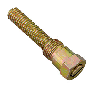

Hmm, I can do that. Where could you get a positive stop?
Jegs, Summit or even Auto Zone. You want the 14mm.
I made mine out of a gutted sparkplug with a 3" or so piece of 1/4" allthread and a nut at each end to adjust/lock down the allthread. Didn't have to buy squat and recycled at the same time.
Instead of two nuts, i made mine from a gutted spark plug, some J*B Weld, and a bolt with the end ground round and smooth. I used an oiled bolt to cast threads into the epoxy. A jam nut holds the stop bolt in position.
I often cast threads in epoxy. Lube the forming bolt well and let it cure before removal.
