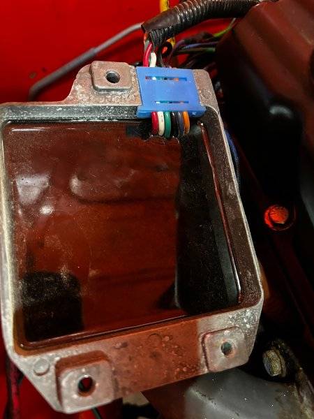

Does anyone know this box?
Icke
9:19 PM
Jun 14, 2023
21
8
Germany
In meinem Wagen ist diese Box verbaut, kennt die hier jemand ?
Yes, I know. I would be interested to know which manufacturer this is, it says nothing on it.
Yup, Ford DuraSpark, with a Blue connector... The connector color is how you tell the calibration... There are red/yellow/green/black & blue....

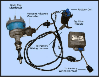

This is a Ford DuraSpark Reluctor & Pick up coil...

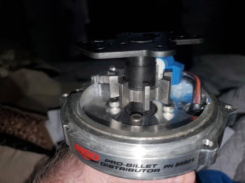

This is a MSD Reluctor & Pick up coil...
They chose a GM advance mechanism since parts to re-curve it are available at Walmart.... But they chose the DuraSpark Reluctor & Pick up coil because they rarely fail.... The DuraSpark control box? Some are good (The Blue connector ones are pretty reliable) some are junk Especially the red & white ones..
