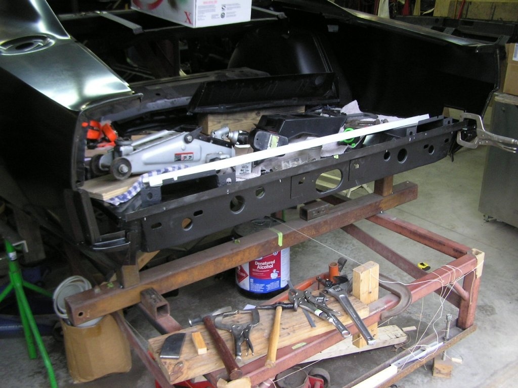

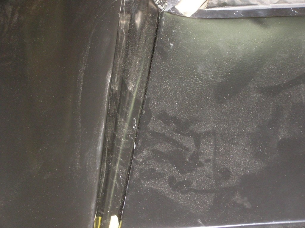

Car update
I cant believe it's been 3+ months since I started foolin around with
the back end of this car!
Basically with the help and advise from some of the members here and over at
dodgecharger.com I was able to get it together. A BIG thank-you to ALL who helped!

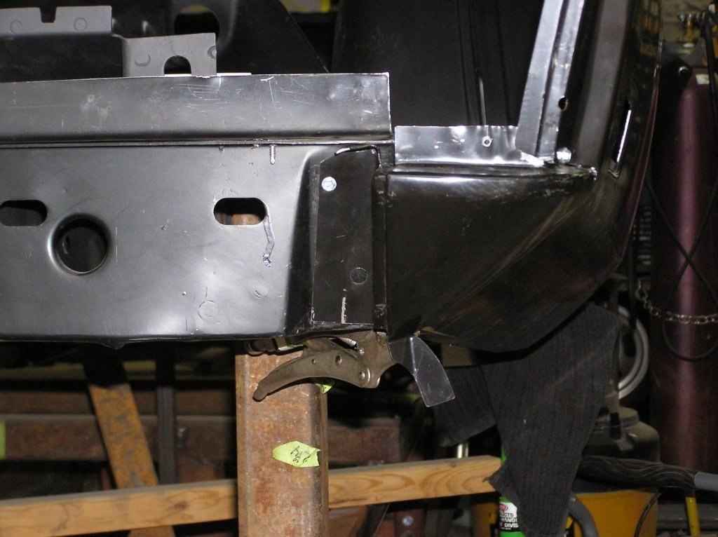

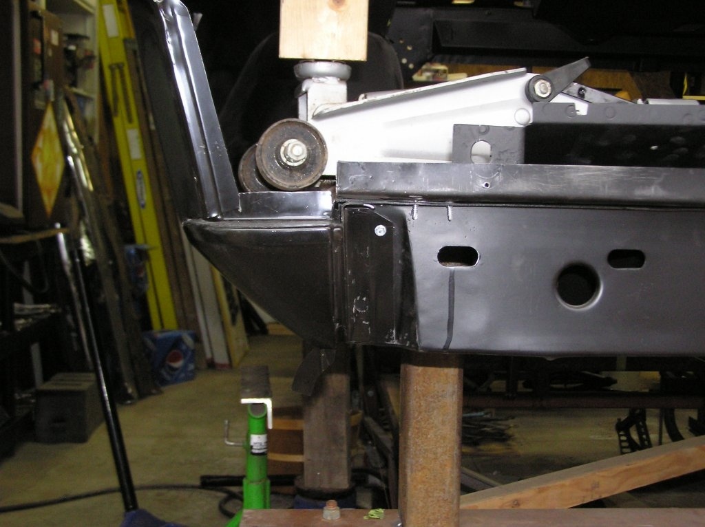

The biggest problem I had was getting the quarter panel
(with the corner cap mounted) to line up with the rear crossmember.
Either the quarter is not far enough back, or the crossmember is not right.
I know some have addressed this problem by slicing the quarters and
welding in a pie shaped piece.
But after advise from our members I got my BIG OL HAMMER out and bent the end
of the crossmember back, far enough, so I could attach the corner cap.

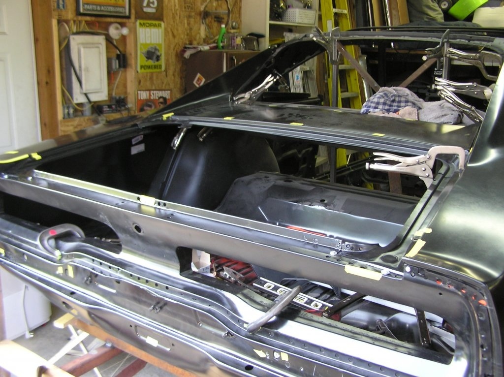

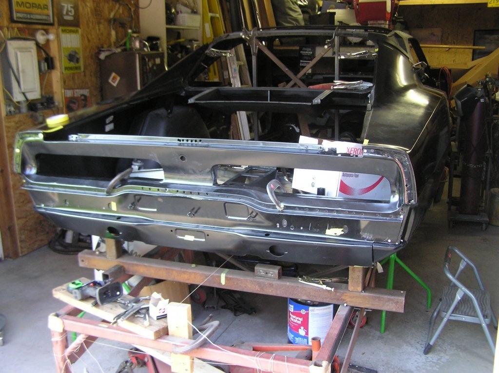

Once I got that close (on both sides) I fit the rear valance and tail panel
and got everything to go together with clamps and screws.
Once I was satisfied with the fitment of those parts, I started over and fit
the trunk drop-offs in. this took a lot of work, as the crossmember, corner
cap with quarter panel, and the trunk drop-off all come together and have to
fit and look right! (WOW I'M TIRED JUST THINKING ABOUT ALL THAT WORK)

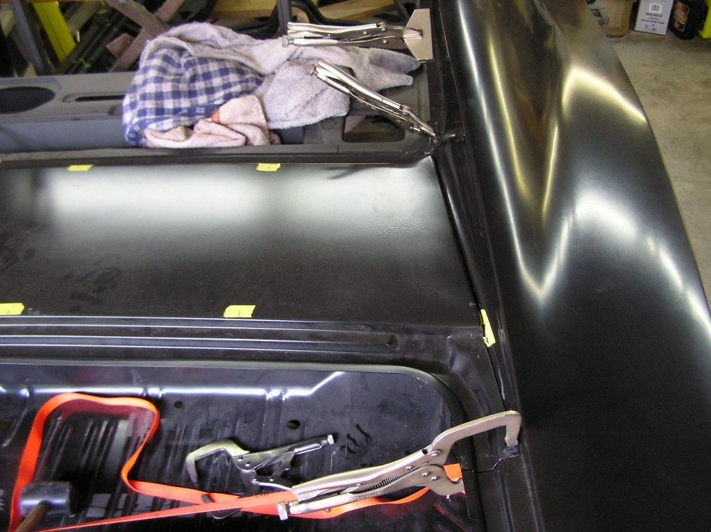

Here she is with the back half all put together (temporarily)
I even have the deck filler panel and trunk gutters in.
I set the trunk lid in and I was pleased with the fitment and gaps!
I have a little bit of work to do to the deck filler panel.
Need to work the right and left sides to get a better fit to the quarters.

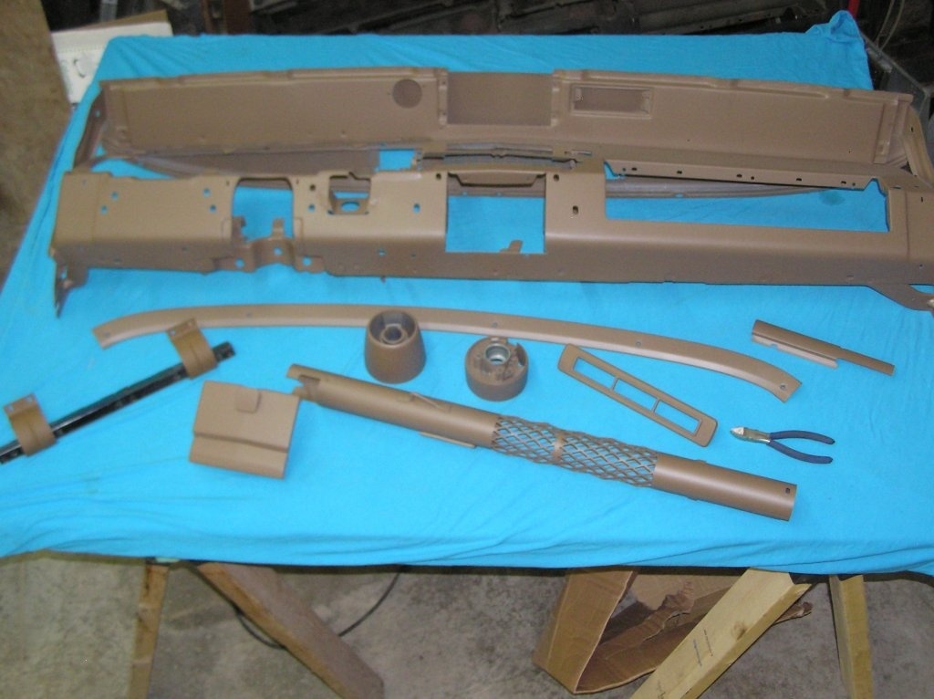

I also got my dash and the other buckskin tan colored parts painted.
I am extremely happy with the results!
(A huge THANKYOU to my friend Rafael who did the painting)
I had our local PPG paint distributor color match the glove box door hinge.
In the picture it looks a little darker than the real thing which turned out
REALLY CLOSE! The parts even have the correct suede finish!

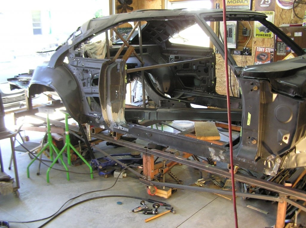

So now that I am happy with the fitment of the sheet metal on the rear of the
car, It's time to get serious and start welding her up!

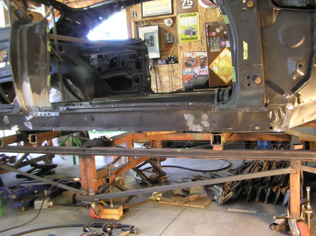

Here I have the sheet metal removed again (I must have done this a 100 times)
And I have the inner rockers welded to the front cross member and rear frame
rails.
