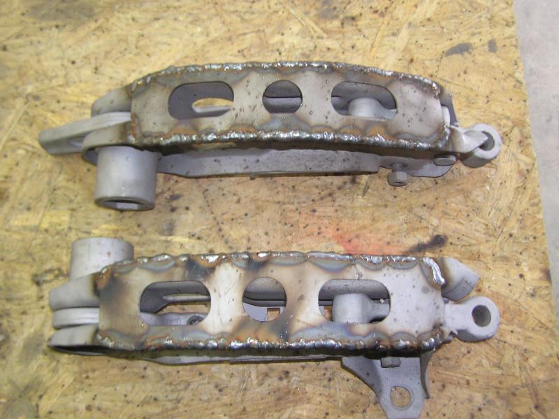

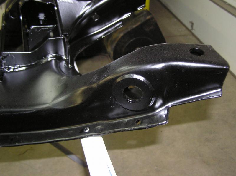

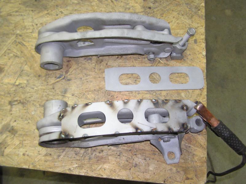

Lower control arms
I boxed in my LCA's while I was at it!
I never got a pic after grinding down the welds.
I will get some after they come back from powdercoat

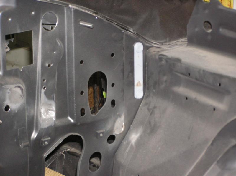

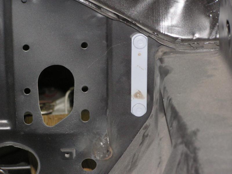

4 speed firewall bracket
I got the 4 speed pedal backer bracket welded in.
Interior shot

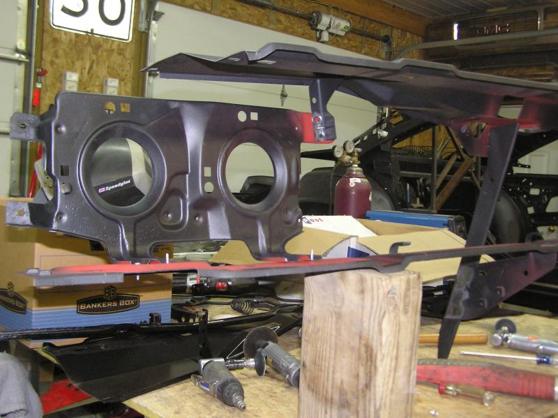

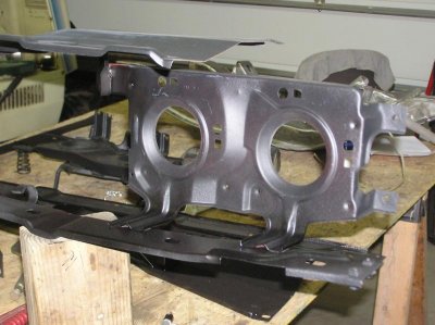

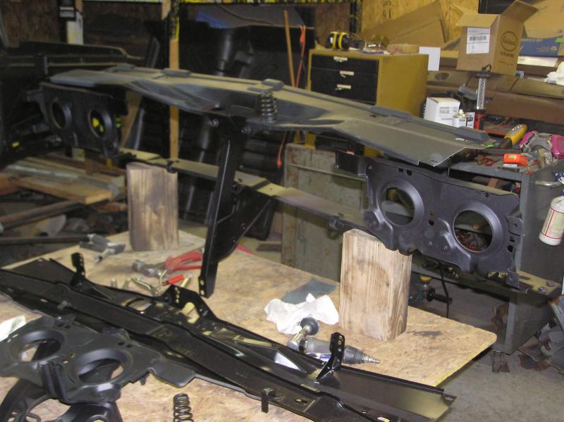

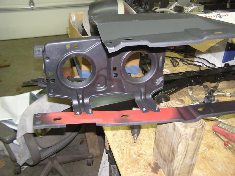

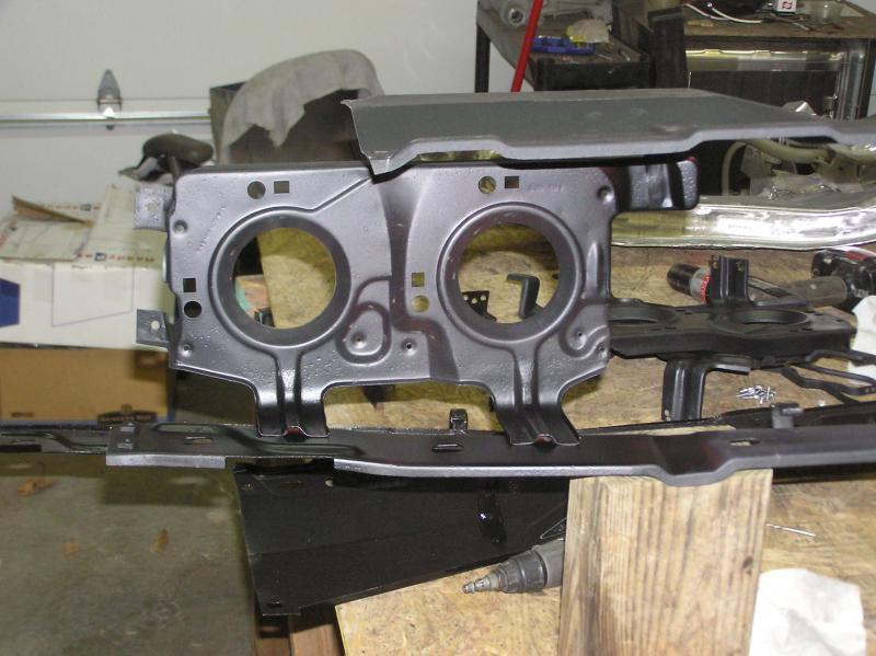

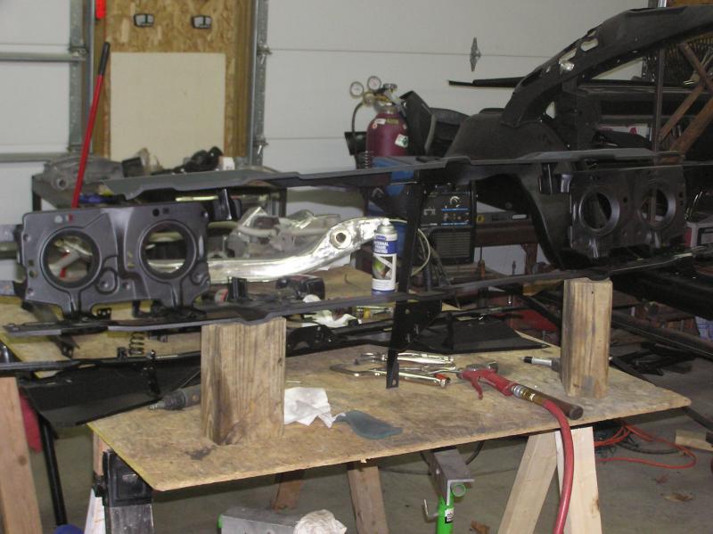

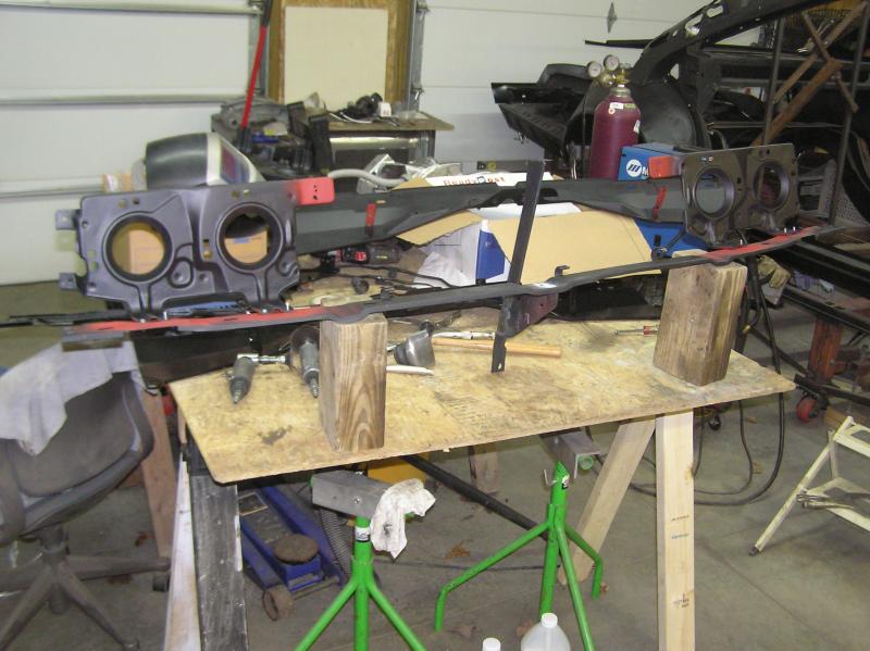

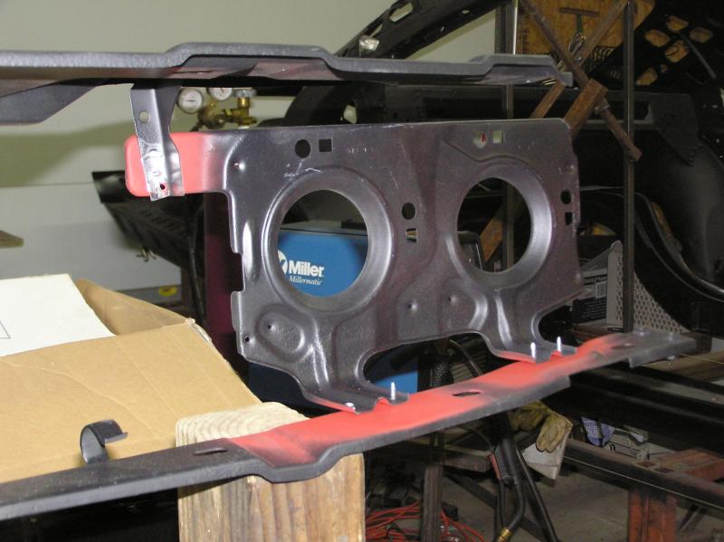

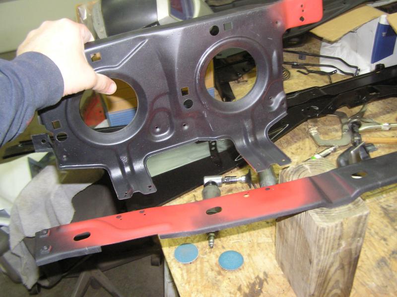

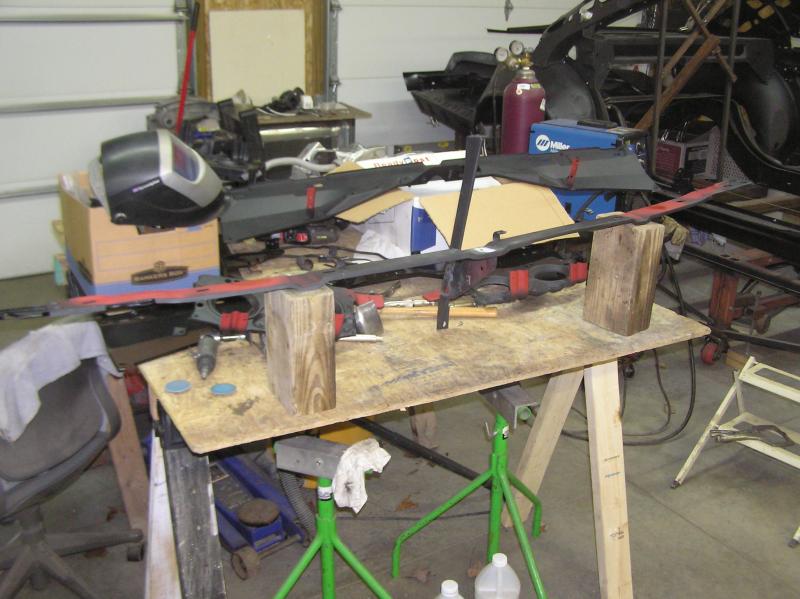

Grill support re-assembly
Ok, next I got my grill support back together.

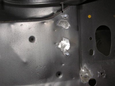

Before I disassembled the grill support, I drilled some 1/8 holes to aid in re-alignment
These alignment holes worked for self tapping screws
These next 4 pics show the support compleatly finished

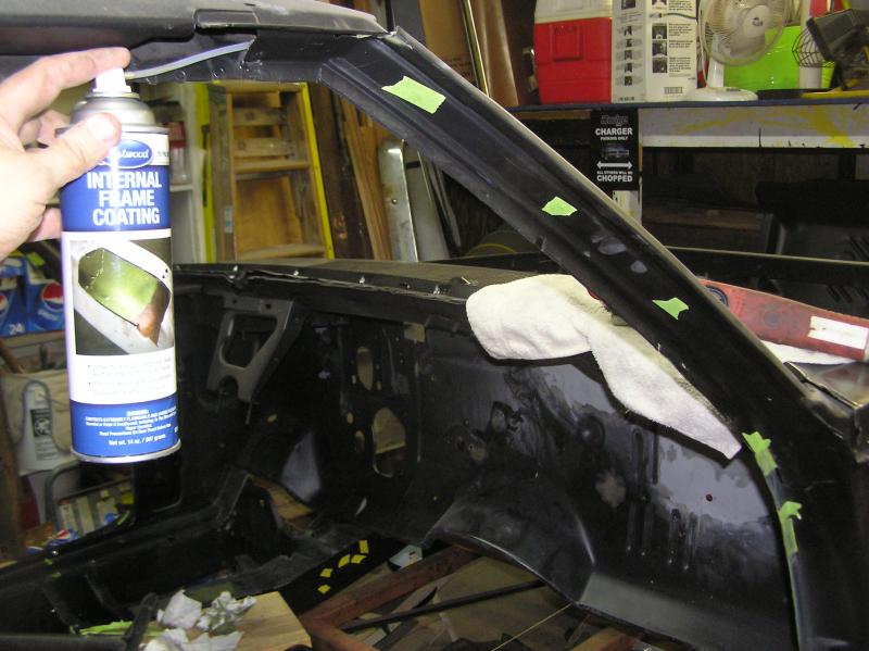

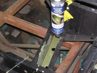

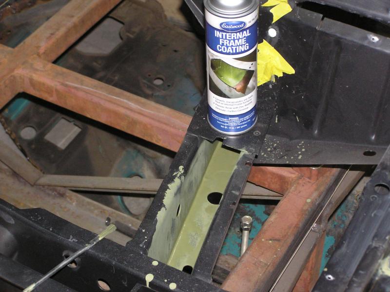

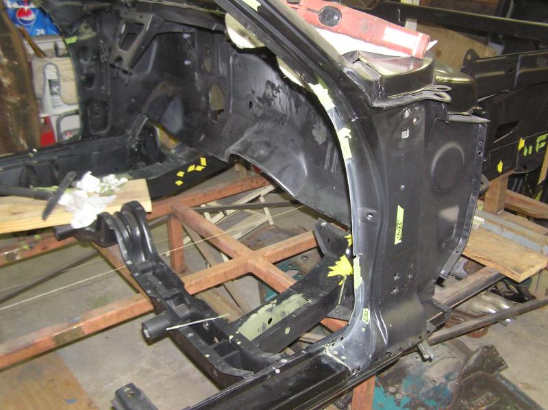

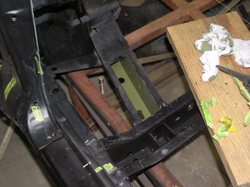

Internal frame coating
I was a bit concerned about any rust that I could not get at when I blasted.
So I bought some Eastwood internal frame coating and sprayed down the inside of the a-pillars and inside the front frame rails
notice all the tape, this was to cover the holes so the coating would not run out
But it did anyway! WHAT a MESS! but I think it is worth it.
(makes me feel a little better)
I will most likely spray inside the torsion bars and rear frame rails before the get covered.

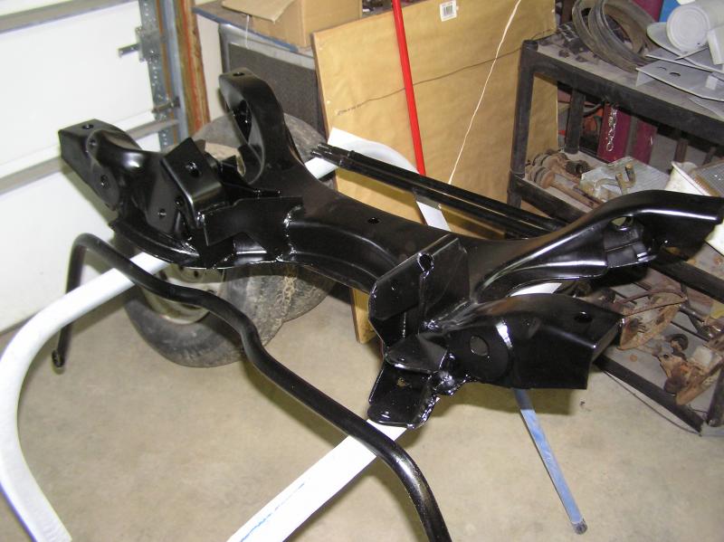

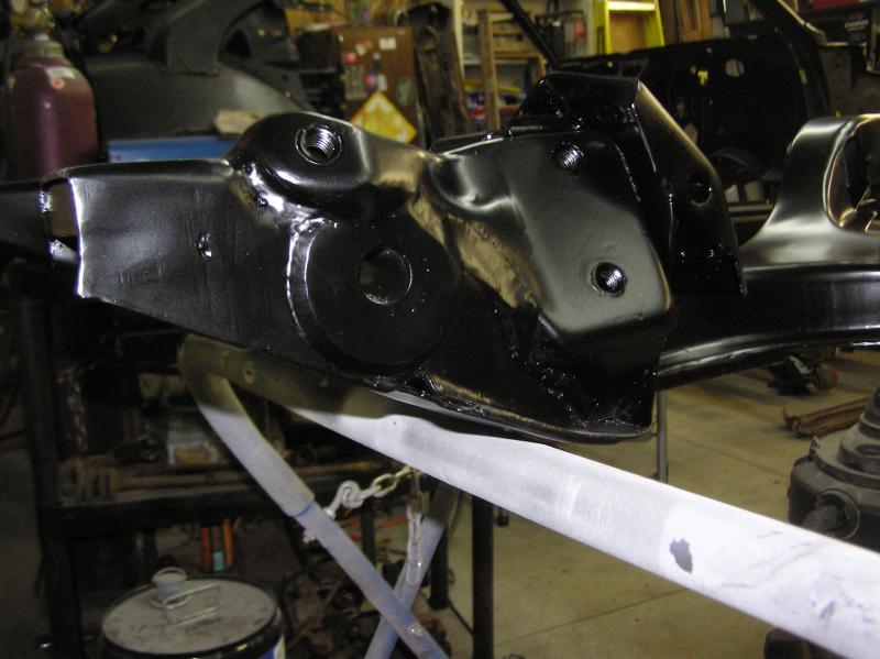

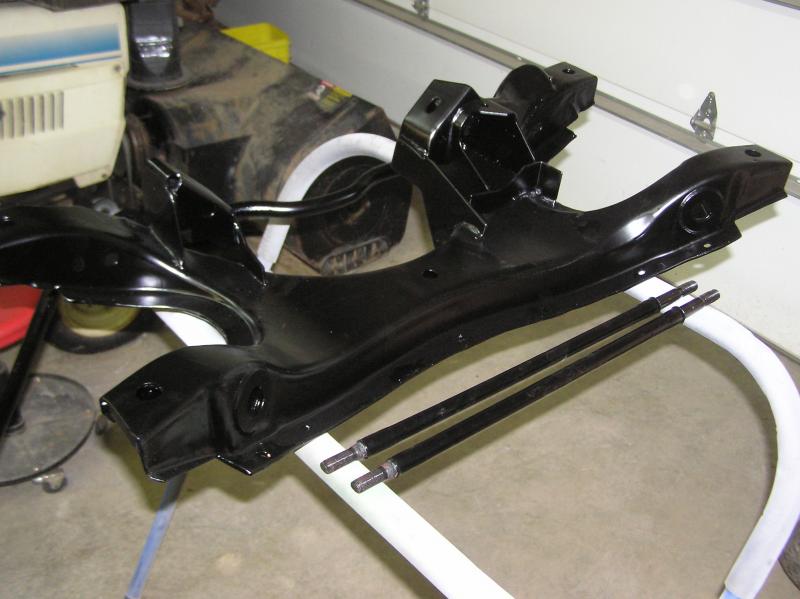

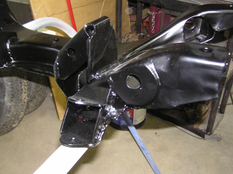

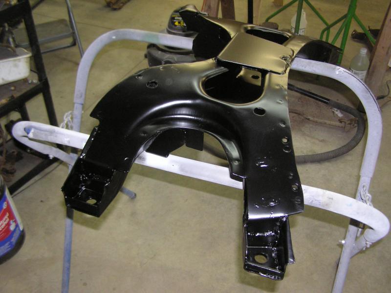

front suspension update
I got my suspension parts back from the powder coater. And I must say I AM IMPRESSED!
k-frame, strut bars, sway bar, boxed LCA's. My upper control arms were toast and had to purchase a set. I also upgraded to the .960 mopar preformance torsion bars.
