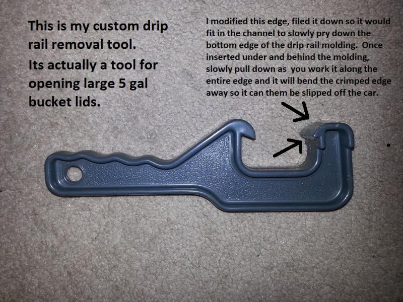

I made, or actually modified an existing tool to do the job. Its nice because its plastic and if you are removing from an already painted car, then less risk of damage to the paint.
Here it is.
Pretty easy to use, just use the modified edge in the picture, insert under and behind the molding and slowly pull it down. It basically hooks the edge of the molding that is crimped and bends it away from the body. You don't need to get too crazy with it and I started slowly to determine how much I needed to bend it before it became loose on the car then just slipped off.
