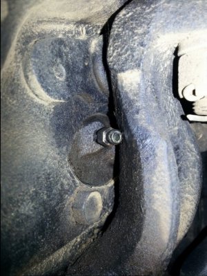

Thanks, but how do you bleed? Can't get a hose on it, that is for sure.
That's a tough one. Maybe able to loosen the 2 bolts holding the cylinder enough to get a tube on?

Can you do that? It had to be bleed sometime when the wheel cylinder was replaced?
Maybe it will shift over enough to work. I wouldn't crank on the brakes with it loose though. It the bleeder bent maybe?
Nope, it's not bent.
I guess somebody must have done something creative?
You don't think they did a gravity bleed all over the floor?
If you can get a wrench on it crack it open to see if fluid comes out. If you got good fluid flow the cylinder and hose should be good. If you cannot get a hose on it, it will get messy for a full bleed. I wonder if you can get an extended bleeder? I think the size is 5/16x24
If that bleeder valve is metric, it's possible the cylinder was made in China and drilled off target. It sure looks to be a different size than the other side....

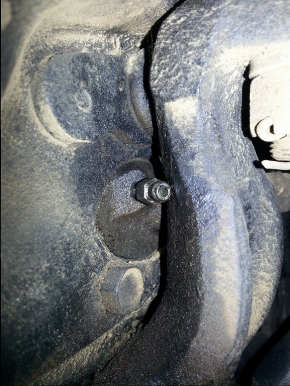

My problem is, if you can look at the photo, there is no room to open the bleeder on the left front side. The bleeder fitting is kissing the knuckle. The wheel cylinder is incorrect; the fitting should be at a 45 degree angle, this is at 0 degrees and butts up against the knuckle.
How did they EVER bleed the brakes?
I wonder, could I put it all back together and loosen the wheel cylinder bolts to give 1/4 inch and try to bleed?
I may throw in the towel here and do a Brake Max visit, or just save money for my frost disc conversion?
No one likes a quitter lol. Those brake cylinders are very inexpensive, I would get a new one and R & R.
Maybe replace the wheel cylinder. It's $16 plus tax, but I'm a stickler about throwing good money after bad and saving for my $700 disc conversion kit. Buying this car tapped me out badly.

You could mark the knuckle where the bleeder is. Remove the wheel cylinder. Take a die grinder and remove enough material from the knuckle in that area for access to the bleeder.
That has been recommended by some of the motorheads here at work, but I think I'll just try to crack the bleeder one turn and see if it will gravity bleed into a foil funnel.
