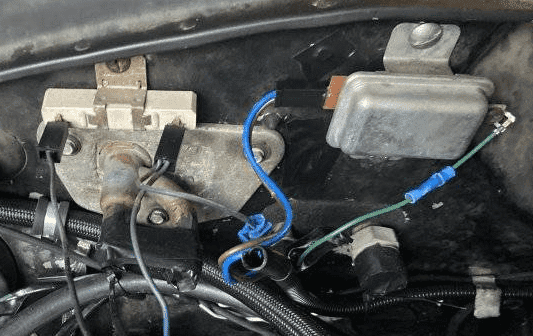

If you look closely, you have 1 wire going to your ballast resistor. It's literally there for looks ,doing nothing.
You could throw it in the garbage and cut the wire off going to it.

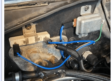

I did that these are pics before I yanked the motor and cleaned the firewall. Engine bay is prepped for primer

I was simple trying to point out that you said "Only thing I had to do is hook up alternator correctly and put new voltage regulator because it got fried". Yet your before and after picture shows you swapped the blue/blue and blue/brown wires. Am I looking at the pictures wrong? Could this have also been part of the problem. If so all I have to do is swap mine.
Your before.
Your after.
Oldman garth, your wiring looks fine. Take the bolt out of your VR and see if there's a ground strip on the back or how does it ground.
If the VR isn't grounded it can't do anything

Will do.
