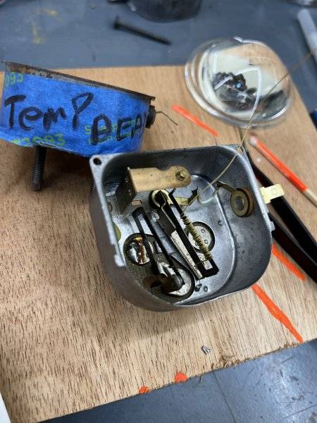

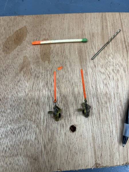

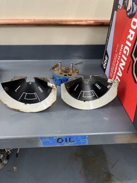

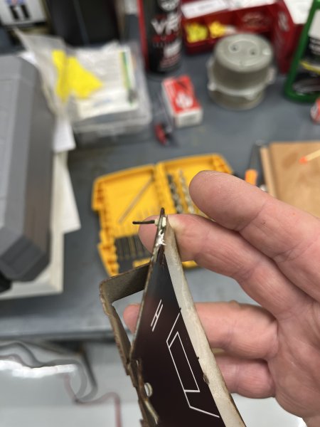

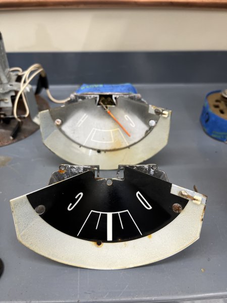

Thanks for the comments. Yes after much homework and digging. (I have owned the car since 2007) I found the repair manual from Duane Pankhurst and my spare gauge set. The power pack was indeed working just shorted out by bad repairs from one of the previous owner. You have to love the detective work of restoration! The gauges were dead. So I am carefully and systematically disassembling and going through gauge faces, indicator hands and gauges. I made the commitment to rebuild the OEM set and restore the dash. New bezels and lenses are on order, and I hope to start reassembly of gauges this weekend. It's not a job for the faint of heart, but compared to my profession, not at all impossible. The Pankhurst manual has been a valuable piece of information. I have attached a few photos of faces cleaned up. I have a full set of working gauge faces at this point. Focusing on gauges and cleaning right now.

Finished all the gauge repairs this week. All gauges (calibration checked as well), faces and needles working. Did a test run this evening on the EL operation. Power pack is flaky after running for a few minutes. One is on order. Dash and engine compartment wiring harnesses are next. New faces and bezel in hand!
