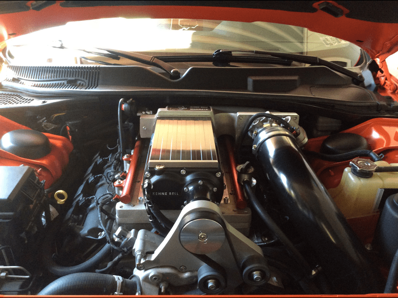

Yikes! B-b-b-but Uncle Tony will say it CAN'T SURVIVE! Bad oiling design!5.7. Blower. View attachment 1113207
