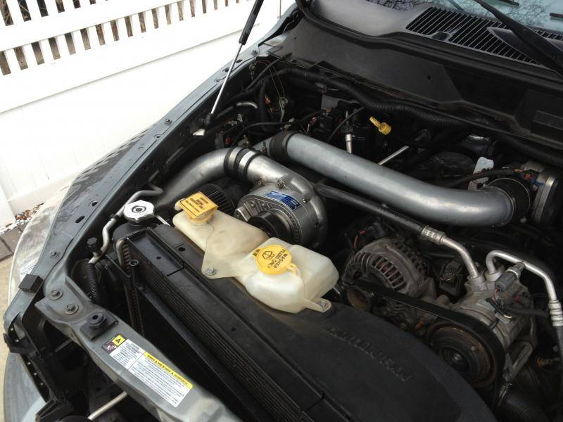

Or you add a centrifugal supercharger
or a roots blower like Dennis H did
OR rebuild what you have
