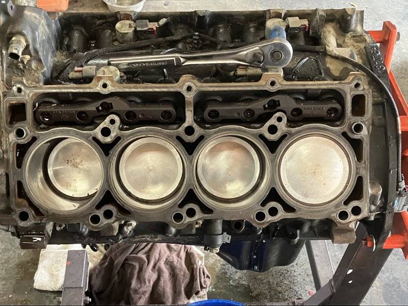

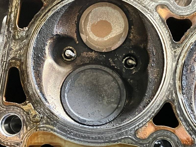

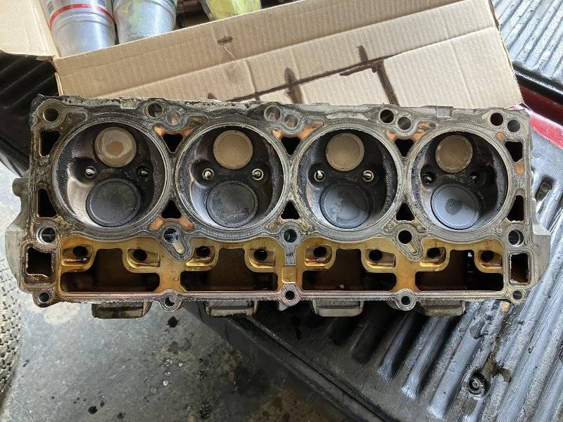

The teardown was in initially planned to just include pulling the heads for a rebuild and to have the seats "staked" and possibly just leaving the bottom end as is. That may change, of course.
The Eagle heads seem to have been designed to allow more compression but work in conjunction with a dished piston to allow adequate piston to valve clearance given the VVT system. With my 2003-2008
slightly domed pistons, valve to piston clearance isn't yet an issue with the stock cam but the spike in compression ratio concerns me a bit. Some say it jumps almost 2 points from 9.6 to 11.5. That would mean premium fuel all the time, right? I know that these heads are far more efficient than our old fashioned LA and B/RB heads are but how much is too much?

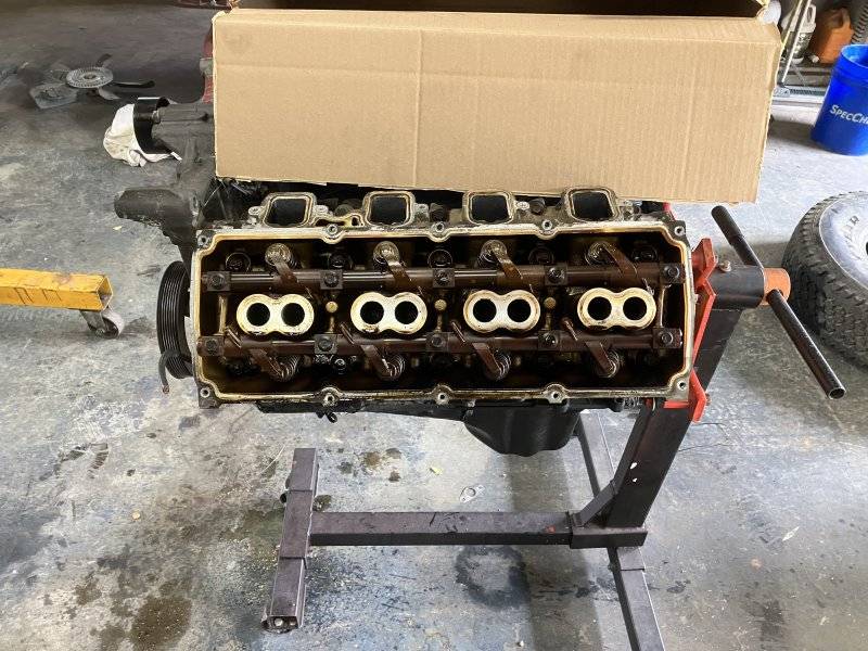

I'm picking up the engine tomorrow. Teardown may begin immediately.
