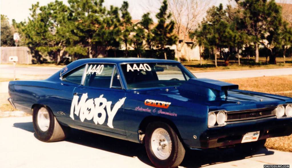

That's funny, had to mini tub my 68 roadrunner to get 12.5W's into it....and have it sit at a decent ride height.
very cool car Cranky, yeah the old 12.5 W's are allot wider,the tread is 12.5" only {they're more like a 14.5" plus wide/girth or more depending on rims width used}, than an overall 13"'s of total girth/width, like in a 10" or 11" wide tread X 29" or 30" tall/diameter tires/slicks/drag radials on a 8"-9"-10" wide rim, with a 5"-5.5"or even 6" back spacing, if you move the leaf springs inboard, or go to coil overs & a ladderbar or 4 link, with stock tubs, you can run probably 11" & 12" wide treads & 11" wide rims... maybe I should have been more specific...LOL...
For the overly **** people like me out there, the cars ride height & rim width will also make different specific needs, for specific tires, a little massaging of the "outer wheel lip", you also can roll them under or trim them down helps allot for bigger tire clearances also... anyway a 1968-69's & some 70's B-Bodies can & will handel allot of tire stock, either way...
