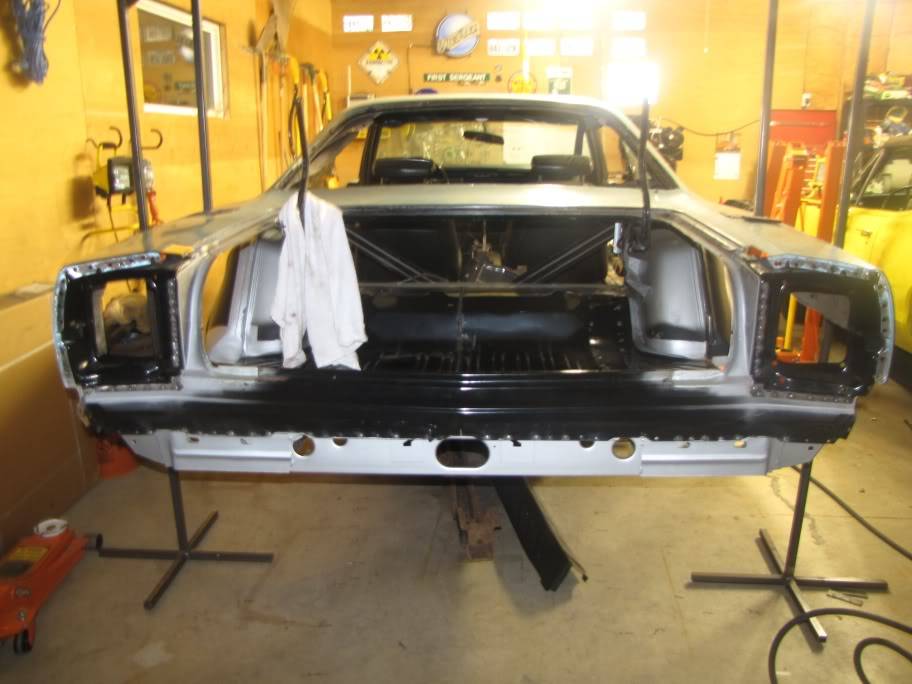

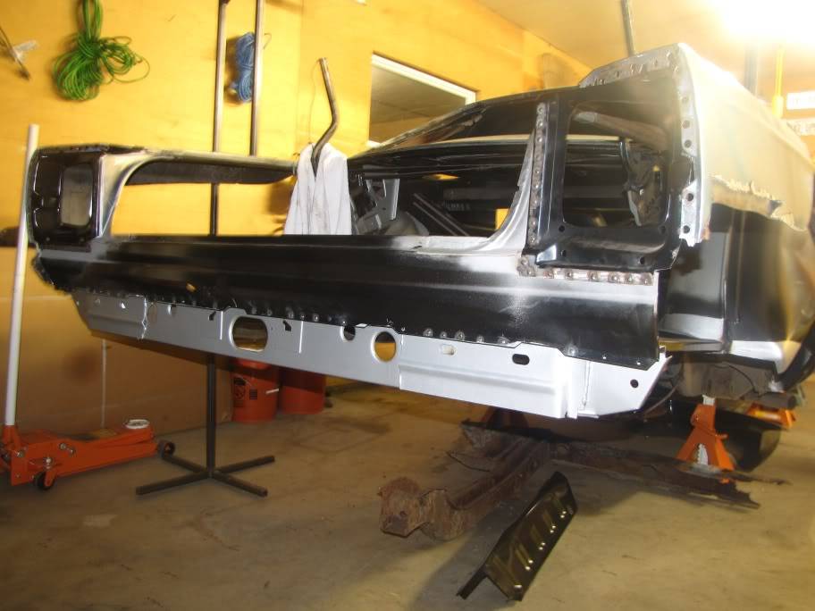

I did get the rear crossmember completely installed now. The rear is actually starting to have a firm feel to it. Lot better than a couple months ago when i just had some hacked up quarters which made up my whole rear of the car.
The crossmember is welded to the frame rail flanges and shackle mount flanges in the rear. The top of lip of the crossmember is the welded to the bottom side of the trunk pan inside the outer lip of the fill panel. The fill panel is welded to the bottom trunk gutters and tail light buckets. The trunk pan is welded to the rear floor rise at the hump, also then to the frame rails, shackle mounts, inner wheelhouses, and then the fill panel. Of course the trunk brace is tied in as well as the tank supports.
The trunk pan will also be tied into the extention panels, which weld onto the outer wheelhouses, quarters and then the top of the crossmember lip as well as the crossmember extentions.
whhewwww......... Holding off on fully installing the trunk extentions till the quarters are being fitted, just to avoid any issues with fit up back there.
