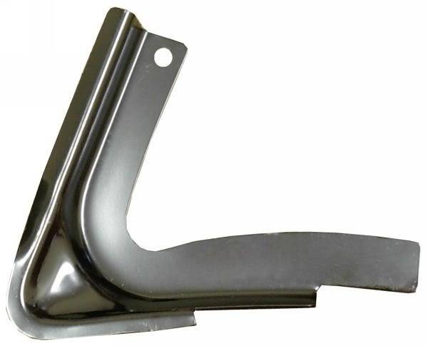

This area I swapped out is definitly a very common cancerous area Roger and that is probably the area you are thinking about. How it all fits together is the quarter panel is spot welded over the top of it. Then you have the little window channel piece under that ( kind of a "L" shape, maybe 3" X 4"). Under that is the cars large stucture of the roof/window frame. All of these are piched together and spotwelded all the way through the three layers. At the end of the quarter where it meets up with the sides of the deck filler panel, the layers pinched and spot welded together are the deck filler lip, that little tab from the window channel piece and the window frame.

I see what you're saying Roger.....The "L" shape piece over laps on top and then the quarter panel over laps over the "L" shaped window channel. I'll snap a pic tonight of the other side where the quarter is still on a bit and you can see how it all goes together from the inside.

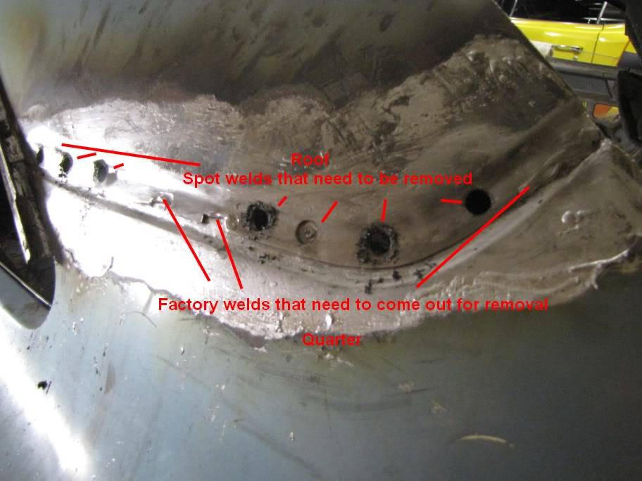

Roof-need to take a propane/map gas torch to melt all the old factory lead out at the roof to quarter seam.

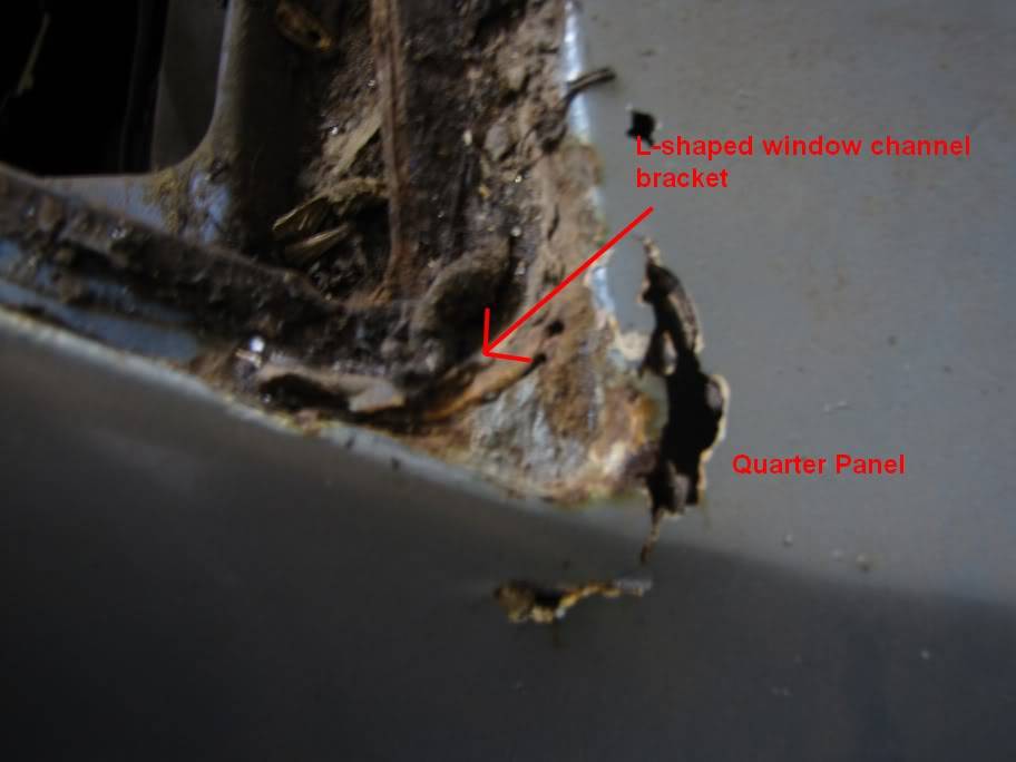

View looking in from outside to in drivers side
New AMD L-shaped window channel bracket, or some call deck filler patch

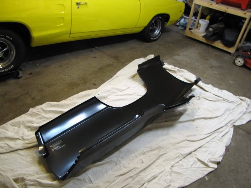

Feels pretty good to get to the point of fresh quarters. I was kind of getting sick of looking at half hacked sheetmetal

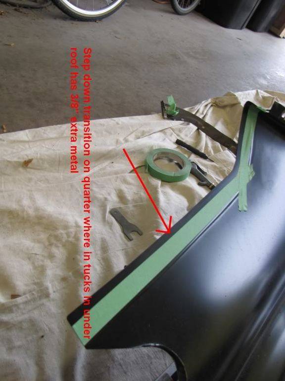

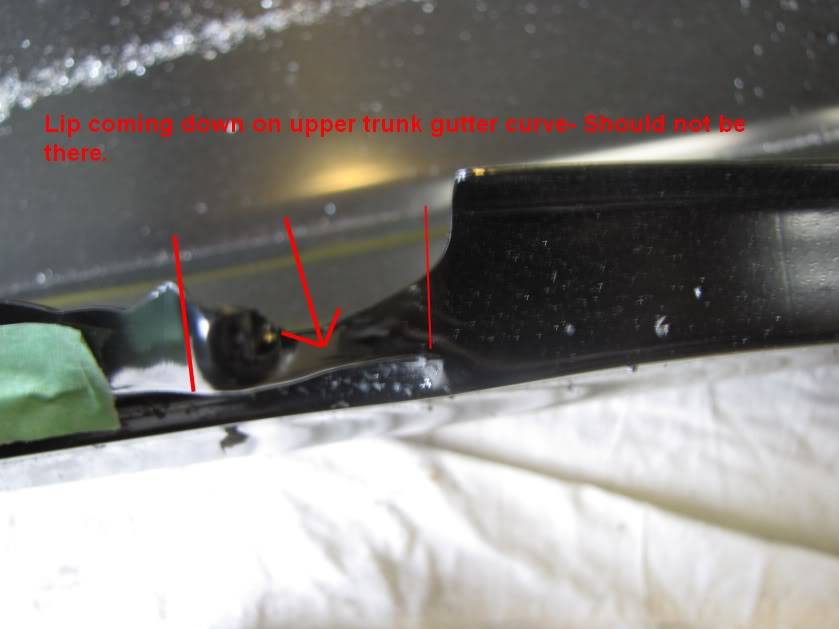

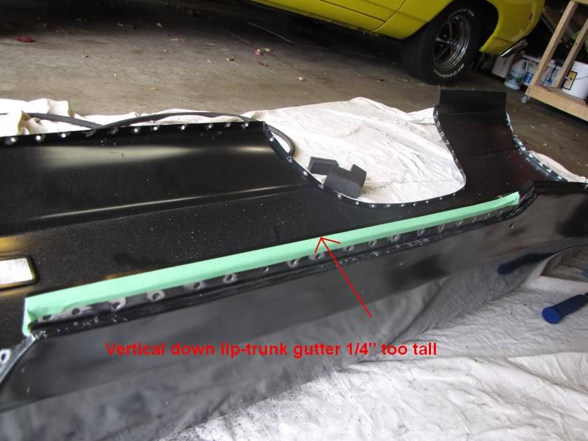

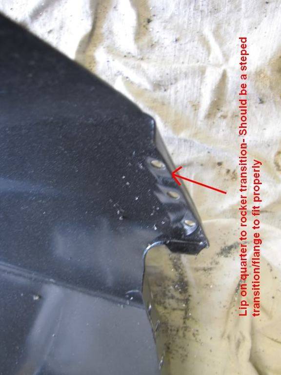

I don't think anyone makes perfect panels and these full quarters from AMD are no different. I addressed these issues before I even fit them up. If you have 68-69 Plymouth B-Body, be prepared to tweak these areas

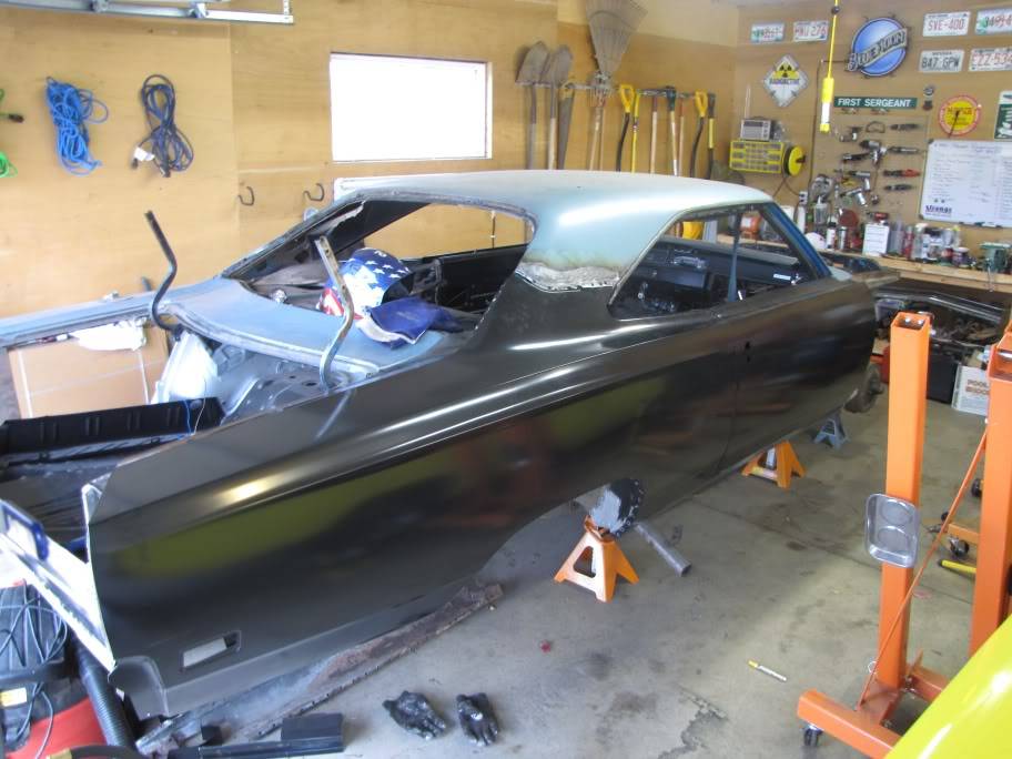

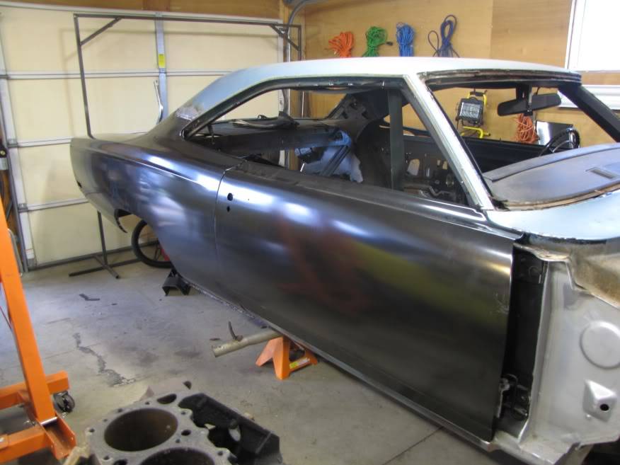

Here she is with the initial fit up.....There is going to definitly going to be some more tweaking going on. Window corner area, bumper indent area and seam running up the roof will all need work
