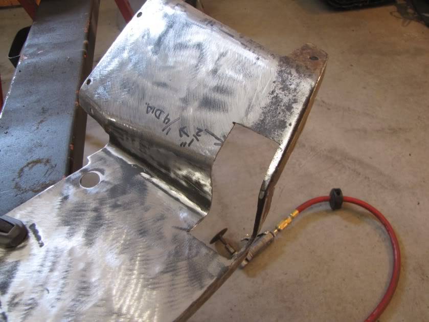

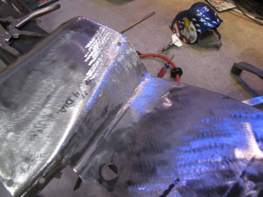

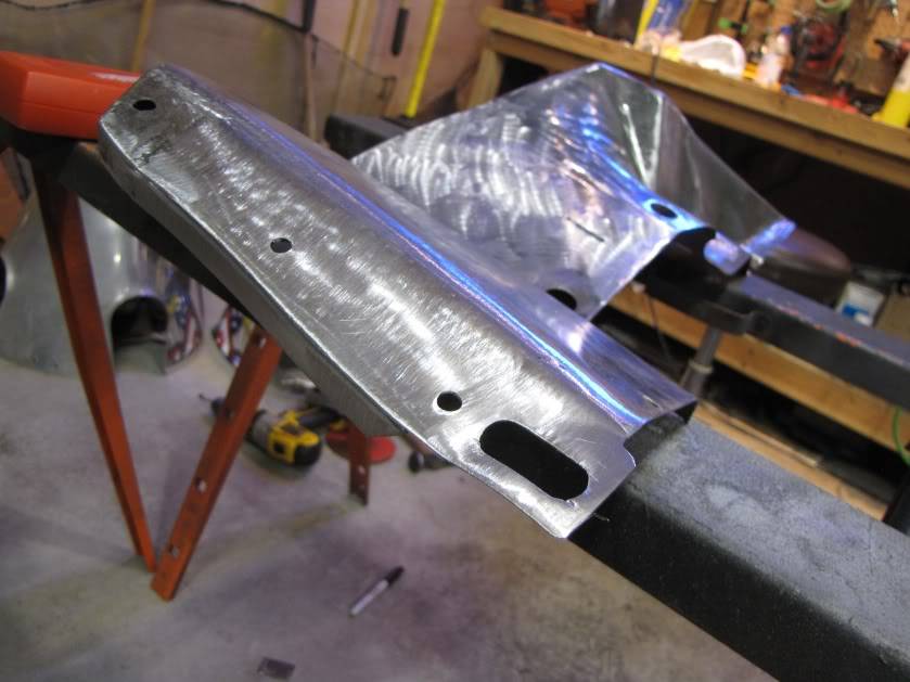

Found a little time to putz around with some roadrunner stuff this weekend...Splash shields. It's kind of tinker toy stuff compared to some of the other surgery I had to perform on the car, but hey...at least I got to do what I truely love about restoration---Metal Work!! After a couple hours dinking around with these, I really started pondering that I need to find me another mopar to start cutting/welding/grinding on...hehehehhehe!

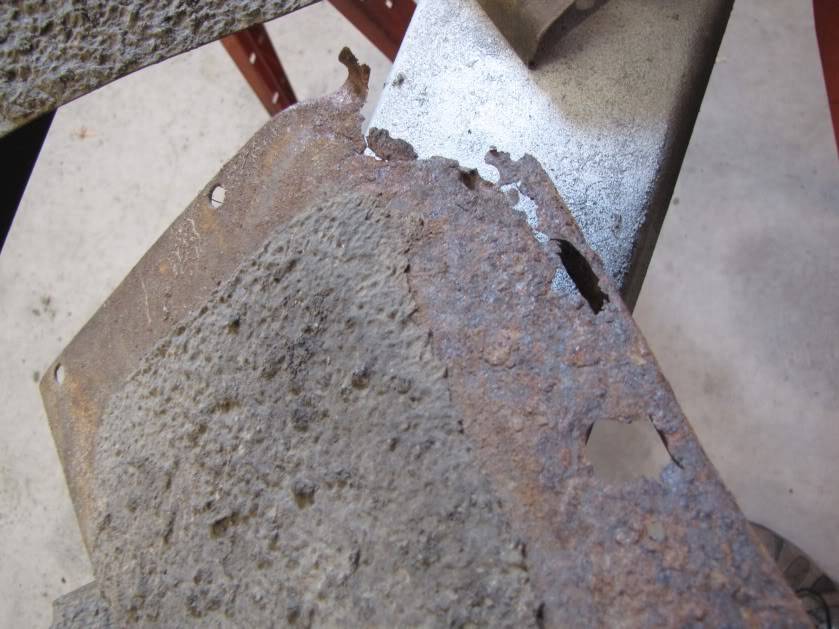

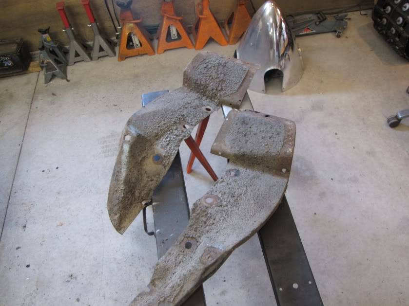

my shields.......covered in factoy undercoat and rust...beautiful! Theeeeeeeee best way i've found to get factory undercoating off is not torches and scrappers, wirewheels or some funky spray can of magic from eastwood, even the media blaster fights with the stuff. What works? A I R N E E D L E G U N.. I'd say 2 minutes a side, and all the black tar devil was popped/pushed off the shields like butta.
Rotton! Cardboard template time.....

All patched up. lips, corners, bends, holes and all. Even got the funky ridge on the top back in there..........The other side just had a couple small patches, and I welded in a new box nut. Didn't bother snapping pic's

I need to get me one of them needle descaler guns like you have.
I have tons of that undercoating on my car too.
Thanks! Sounds like a good weekend Dave. I'm jealous. Wish I could find some time to hit up the ice. Heck, i'd be happy if I could just take the ski-doo for a 1/2 hour spin down the trails. Weather is just garbage this year. Gearing up for sturgeon spearing, but that isn't for another few weeks....Uggg.
I bought the Ingersol Rand model off tool topia. Works great for exfoliation rust and undercoat, but doesn't do much for the fine surface rust. Grinder/High speed sander is my weapon of choice on that.

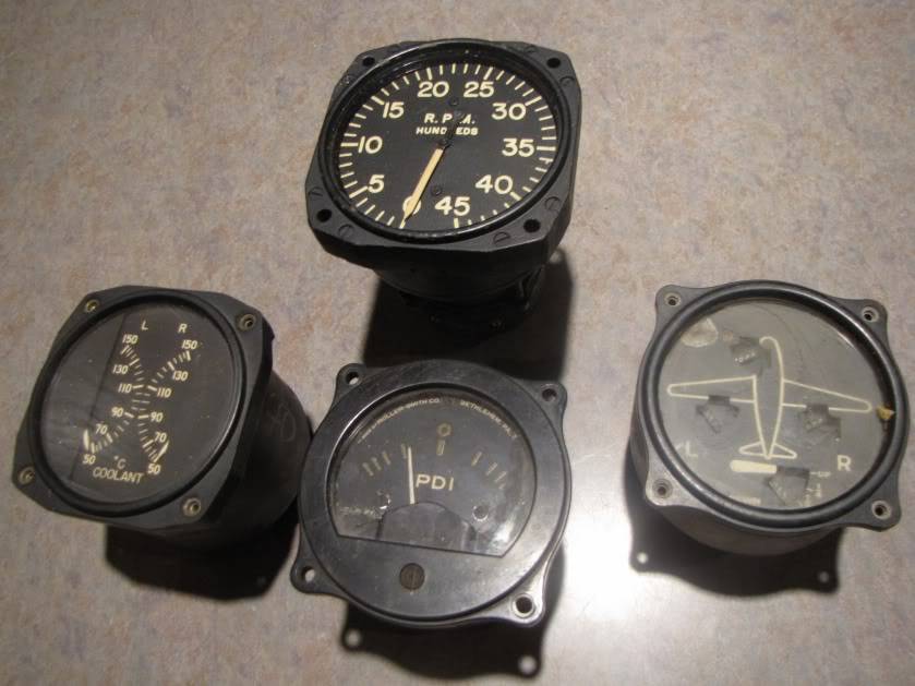

Yesterday I responded to a Craigslist ad for "War Stuff". I spoke breifly with the older gentleman and went over to his place tonight to check out what he had. Turns out the 90 year old guy is a WWII vet and was in the Army Air Corps as an Aircraft Mechanic. He didn't have much stuff left, but still had these acft gauges below. I thought they were pretty neat so I picked them up for $40 bucks. No idea if they're worth anything but what a huge piece of history to have.
Top center is a Tach from a P-51D Mustang. One on the left is a Coolant Temp Guage from a P-38E Lightning. Bottom center is a Pilot Deviation Indicator from a B-17G and the one on the right is a Landing Gear Indicator from a B-25G Mitchell. Gave me some old Army tech guides/installation manuals as well as cockpit views to show the guages. The guages are stamped for their acft as well
