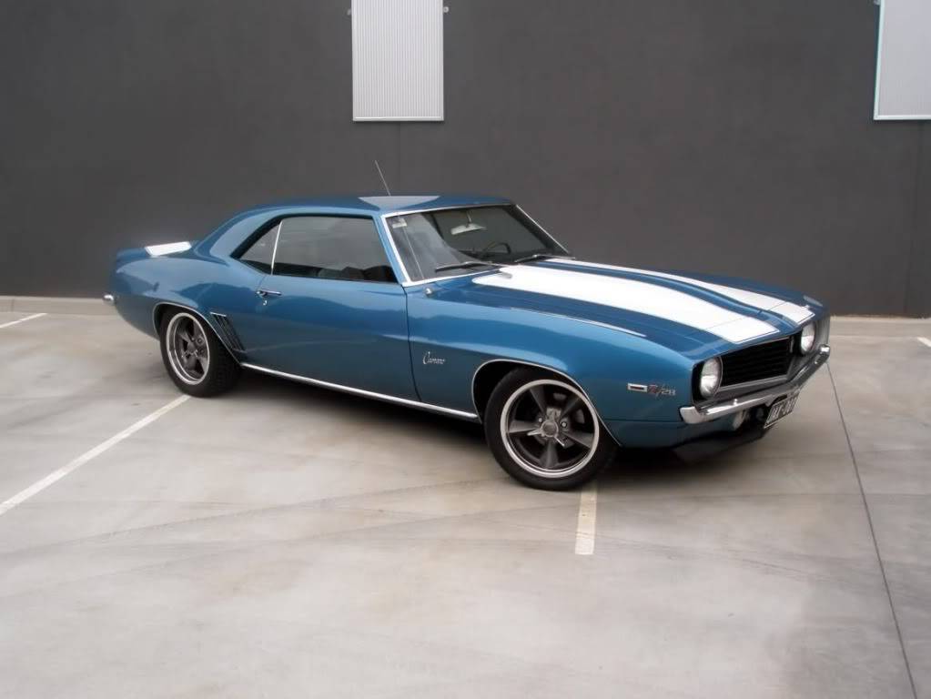

Thanks again Mario for the wheel reference. I was able to dig up a pic of those wheels on a Camaro (sorry).
So, with/without the spinner type center cap....How will these wheels.................
....Look on this car......................

Im not much for low profile, but these wheels look kind of sinister to me, i know you cant see much but thought id show them to you for a "just maybe" look.. I cant seen to find a good pic of the wheels alone, sorry..
Beauty, Will!! i hope you can get those rims to fit...would look soooo bad-*** (always been a sucker for spinners btw)

Yup! that's just what i was thinking! the full on chrome may take away from the sinister look...
X 2... I agree! We all love the chrome but the charcoal along with it makes the sinister look mean and lean, with a added sparkle with the chrome... Ive seen these before because i keep going back and looking, if they just had a tad bit more "dark" in them.. JMO
UMmm, this wasn't meant to change your mind Prop, just to show you, Until i found these awhile back, ive never seen them on someones car before!
