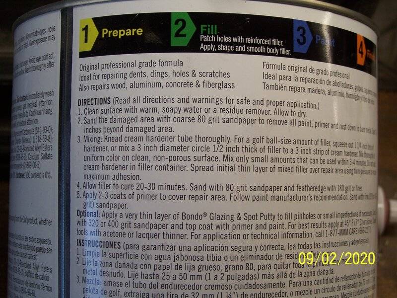

Depends on what filler you use. Mine says to apply over BARE metal, so that is what I have done for several years now.

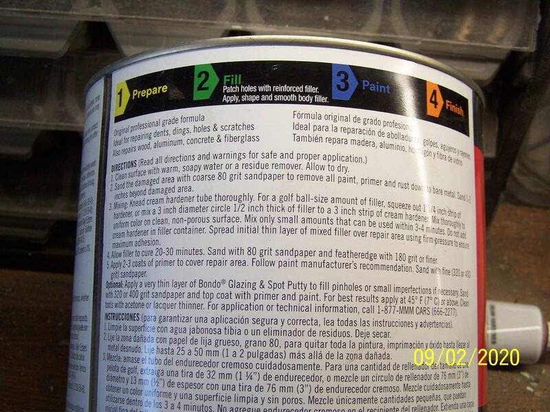

Okay, next can I buy will be Rage Gold. The TDS for Rage Gold also says it can go over bare metal.
  • TDSRageGold103612English.pdf
I just ordered a 3 liter can of Rage Gold......prolly end up throwing a lot of that away....just how long does a can last once opened.....
