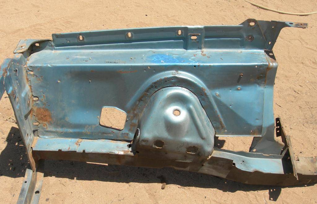

Here's the donor stub
For $350 and some work I could have the front end totally complete. The donor had no rust. even in the trunk and floors.

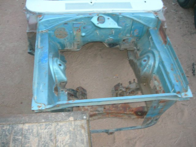

Heres the front stub I'm going to go pick up. The guy was nice enough to remove it for me and he took a lot of care in doing so. Stoked. Going to get it blasted and epoxyd after I get it that way all I have to do is install it.

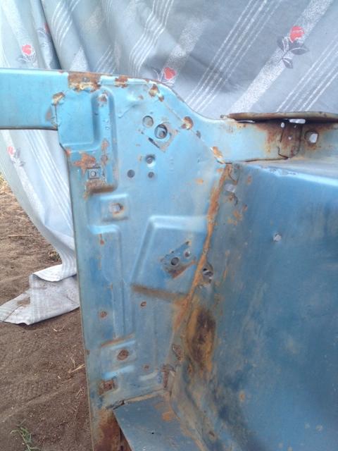

Yeah 350 bucks is a awesome deal even with the little issues I found.. The guy I got it from Sal is a pretty cool dude, he also has a bunch of badass cars along with his own roadrunner!...Anyways.. all in all the stub is in pretty good condition. But I have a couple issues with it, I assume someone in the donor cars history removed the passenger inner fender and core support because they are spot welded in a non factory way.Glad they didnt touch the driver side becuase it looks real good...No my issue with the passenger side is that it looks like they installed it a little low.
Now if this wont cause alignment issues then thats cool and I'll leave it(But I will spot weld it the right way) So my question is will this create a hassle for me in the future? Because if it will I'm going to remove the inner fender and move it up.

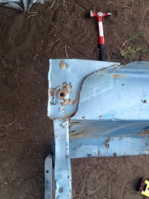

Now the core support was spot welded along the seam like so
I don't really have a problem with it but I'm going to grind down those welds and do some real spot welds like how it's suppose to be so it's more visually pleasing.

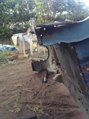

Now this piece I am going to remove and put on the right way. It's lop sided and is about a half inch to far to the left.

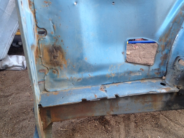

One of the K-member nuts that are in the frame broke off also. So I believe I will have to cut open the frame and re weld that nut back in there. I will give all the other ones the same treatment so I don't have to deal with this when 400+hp rips it out....The other side looks untouched and looks great.
Nice score indeed! I would wait until you do the assembly before you start taking it apart, you can fix it later if it is off alignment.
I have to say. I like the way you think! That way I can test fit my fenders. Then if there's a problem I'll take care of it. But I will definitely have to square up the little thing on the core support. I also think I will fix the K-Member mounts before I Install it though.
