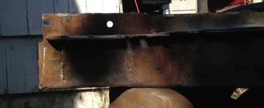

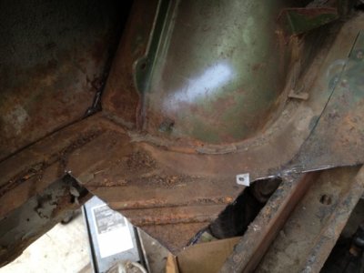

Like I've said before. You knew my intentions for the pieces and failed to mention the fact you had cut off the front of the frame rails. You knew I wanted the front 10 inches as a graft in piece and you knew I wanted the whole inner fender as a swap in piece. You're perfect and my perfect are way different because I would never call a piece perfect if it was blatantly missing the front.

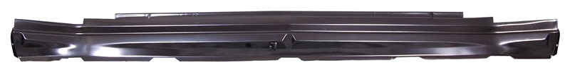

Also these 2 pictures you sent me clearly do not show the cut. The look to be intact
You tell me how I'm supposed to notice there cut in the front when you send me two bite sized images taken from the back side of the inner fenders
Not to get into a pissing contest with you my friend, but those pictures clearly show exactly how these things were cut. Don't blame me for your lack of familiarity with the parts you are dealing with. Had you asked me to accurately describe and measure the cuts, I would have done so. I assumed you saw what you were asking for and had all the information you needed. I'm not a psychic!
If your so familiar with your mopars then you should of known when I said "I need the front 10 inches" that maybe you should of mentioned the fact that they where cut an inch back. Your pictures where small and from they way you described it they where perfect. When I hear perfect I think nothings missing or wrong with it. Same goes for the inner fenders.
No cracks. I've already checked
There was clearly some mistakes on both sides. I'm thinking about just keeping them and working with the front inch since it's better then what I got at the moment. Not to mention don't really feel like dealing with having to ship them. I'll just get my money's worth out of them.
Steve, just eyeballing where you made the cuts at the firewall, you will probably be ok with those panels. Some time spent matching the cuts and stitch welding (gas if at all possible) will get you a nice seam you can grind and fill smoothly...I've done a bunch of them over the years.
Offer still stands though, if you want to send them back, I'll take them.
Look at the pics! Do you see anything that resembles the core support in them? Yopu never described the damage you were trying to repair, only that the front ten inches of the rails had some damage. The area between the K frame and core support does nothing but support the bumper. When I have replaced them, usually due to rot, I cut at the core support so as to leave that structure intact, and graft from there back. Again, not a psychic!
Didn't make any cut's at the firewall. Just drilled out the old spot welds. I'll work with the frame rails. The driver inner I can fix the rust spot/drill the spot welds and use it. Passenger side I can cut straight then use my old panel to patch the front. That or just buy new ones. But I'll try and make the old one's work.
I removed my core support without touching my frame. Looks real similar to your pictures. How am I supposed to know you didn't do what I did.

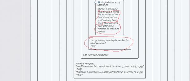

Also I told you exactly the damage I had and what I intended to do.
" I need like 10 inches of the front frame rail's to graft onto my bent ones. Mine are bent right after the K- Member so they'd be perfect"
You tell me how I'm supposed to notice there's a cut in the front when you send me two bite sized images taken from the back side of the inner fenders[/QUOTE]

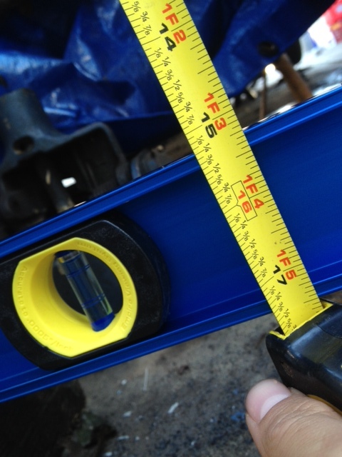

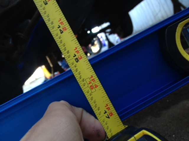

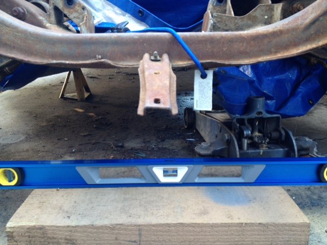

Leveled the car out and checked the up down on the front frame rails + rear just for the hell of it. There perfect and not bent up or down. So once I fix the very front of the frame rail. I don't think I should have anything to worry about. Also checked the in-out a few weeks ago. They dont appear to be pushed in at all. I just took that measurement off the firewall. When the ground dry's up I'll be laying out the car on the ground with a plumb bob and get a more accurate look.

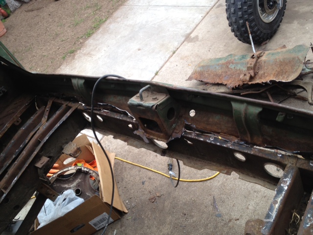

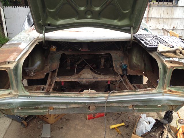

Well I havent been working much on the roadrunner. Started on the trunk awhile back then finally started on it again today. Got most of it out but have a few questions about what I should do in certain areas (In your opinion)

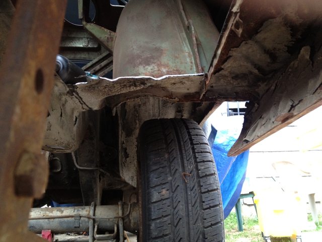

How would you guys tackle the trunk floor to wheel house seam. Wasn't aware they where spot welded all across the bottom of the seam underneath the trunk and I dont want to butcher the wheel houses up. Would you guys crawl underneath the car and drill them all out. Or is there another way.
Heres where I'm at right now on the trunk. I stopped and wanted to get some advise before I went any further.

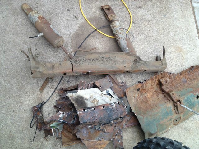

Looks like a new rear crossmember will make its way on to the car. Look at that gnarly crack :blob1:
I want to replace the this piece
But I am going to fix the rear cross member which is in alright shape other then the nice crack it has.

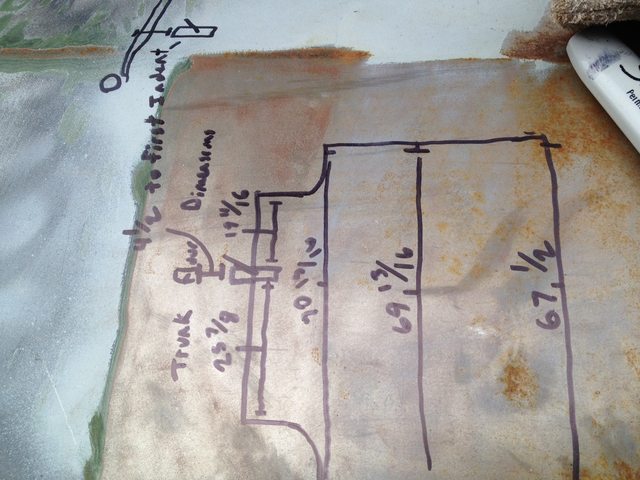

Measurements on the trunk

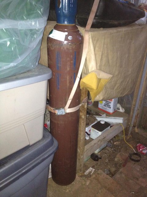

Also got this tank on a 99 Year Lease from my local west air gases and equipment. $223 for the bottle with the C25. I think that's pretty good since its a 99 Year Lease. They have a great shop and have been around here for over 20 years....Still waiting on my Hobart 210 MVP to come in though. Damn Hobart hasn't shipped it yet and I ordered it on Tuesday!
Are you going you replace the whole trunk floor? 99 year lease, huh? I hope it doesn't take ya that long to use it up.LOL.
Yeah the whole trunk floor is being replaced. I have a feeling I'll be tinkering with my welder a lot so I'd hope not :laughing6:. Gonna pancake an extra hood for a c10 I have laying around to get some practice before I hit the roadrunner. ;]
Well there's a good picture of why not to run Air shocks on a Mopar....As far as drilling out the spot welds for the inner wheel well, take off the rear wheels and drill them out from the outside. Changing out the rear crossmember opens up a whole new can of worms for you. Taking off the rear fill panel isn't too bad; just connects to the pan, gutters, X-member lip, and tail light buckets. The crossmember ties into the frame rails, shackle mounts, fill panel, extensions, and pan. Bunch more work and if it does in fact need to come out, be sure to jig, secure or measure reference the frame rails/shackle mounts before moving forward with it. They will move a bit. Save that spare tire/jack mount if you can and the trunk latch support. The AMD fill panel will come with the reinforcements, but not the latch support. I would also recommend you document the location for the two J-bolt mounts to transcribe to your new pan
You can save that picture and show people if you'd like to scare people out of air shocks if you'd like hahaha.
Thanks I figured that was the way to do the wheelhouse area. As for the rear crossmember it's staying attached to the car. It just has a crack in it I need to fix. other then that it's in good shape. Will do on the j-bolts. Pretty sure I marked there location but I'll double check.

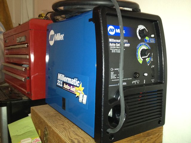

But in better news. Look what I went and picked up today!
Hobart was on back order so when I saw this 211 with mvp at the westair gasses I had to grab it. $1038 which was 100 more then the hobart.
Nice...Good machine. You'll like it. I wouldn't rely on the auto set...Never had a whole lot of faith/luck in it with my Millermatic
I was gonna play with it a little to see how good it was. But your right I'll mostly be going off manual mode.
