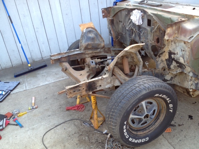

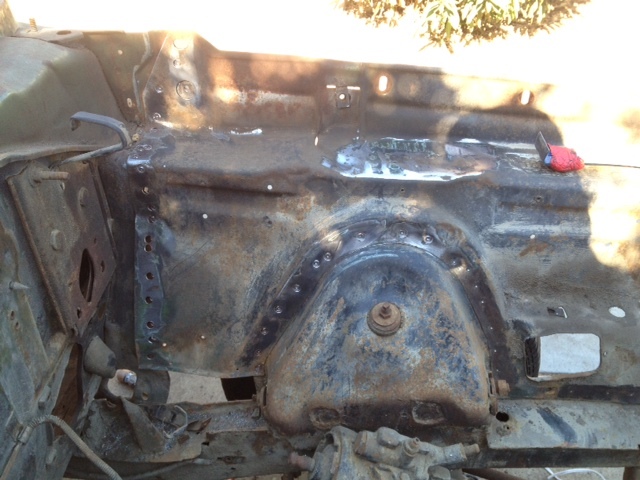

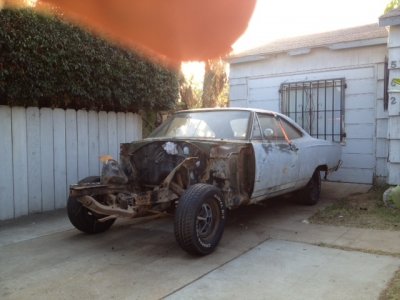

Well other then having decided to take the car to frame shop I removed the other inner fender today. Luckily it was just spot welded so it was a little easier.
The bottom of the radiator support on the other hand was a little more of a pain in the ***. It was welded to the frame in some tight locations but I was able to get it off.

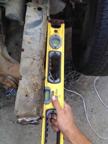

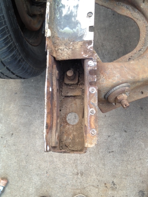

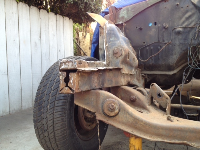

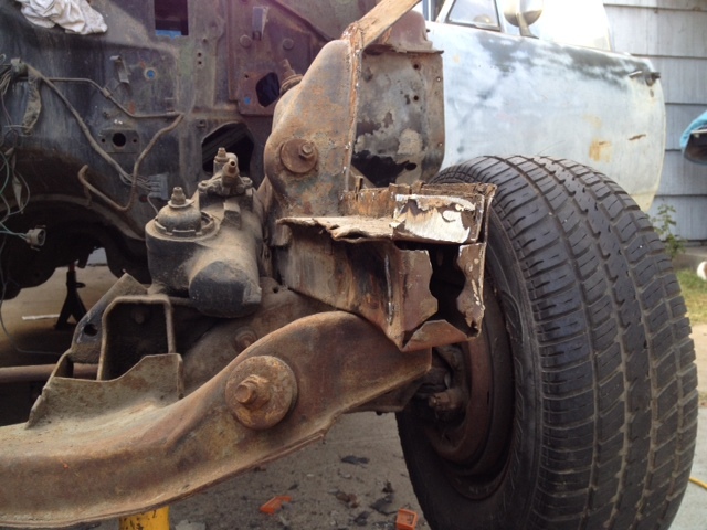

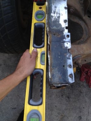

Do you think the frame shop would be able to work the dented insides of the frame rail back to normal?. If not and the frame rails are up to spec. I might just make some bracing and weld it over the area for extra support and to cover the dents. Don't plan on ever selling the car so this little detail wouldn't bug me.

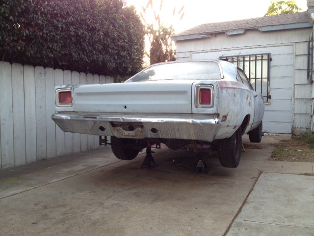

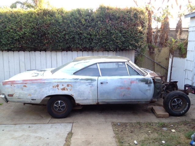

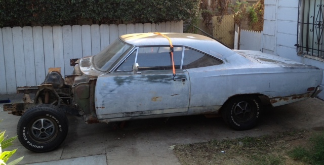

Also put her on all 4's for the first time in awhile. Forgot how low this car looks
haha I already tried a torch and hydraulic puller and it'd get to spec then as soon as I let it off it snap back into place. Frame shop's problem now :icon_biggrin:

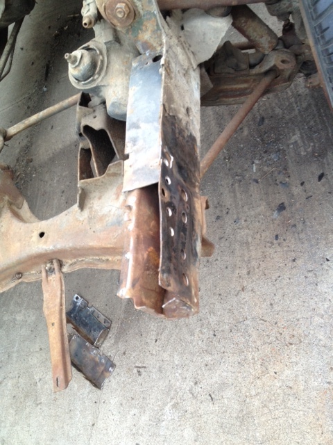

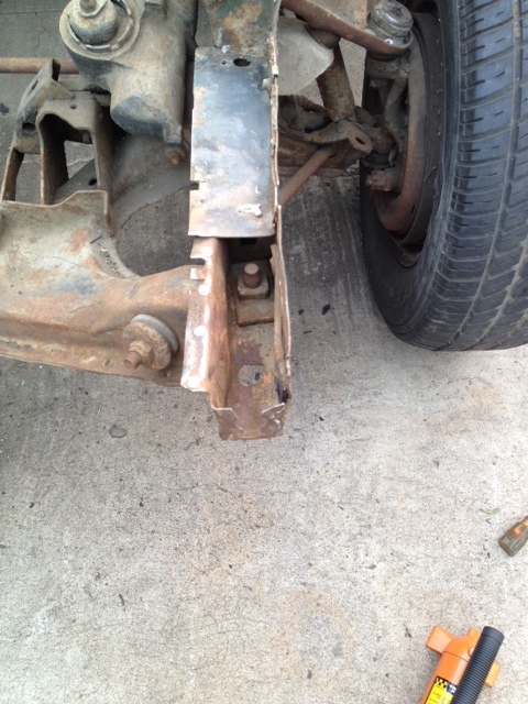

It all depends on the shop as far as whether they can or should I say want to fix your dents. I'll throw another idea at you, why not just drill out the spot welds on the frame cap? Once it's removed you could stuff a block of metal or wood in there to act like a dolley and work the dents out. There is no reason you can't weld just the 6" on either, you always want to bevel the metal and leave a gap between the maiting parts about a 1/16" so that you have 100% weld penatration. I've done this a million times and it always works, don't sweat it, just do it right. Once everything is done plug weld the cap back on and your done. Good luck
I was thinking the same thing about taking the cap off. I already started on the passenger side in one of the pictures. I'll give it a shot with pulling them out. If all else fails then I'll go with the grafting in the 6" piece. When I think about it I don't see why it would do any harm. If done right it should hold up fine. Not to mention I can brace the inside of the frame rails after it's done and it'd probably be the strongest part of the frame. **** my truck I had the whole backside of the frame cut-off and rewelded back on and it's never had a problem. Still going to have the car go to the frame shop though. See what they can do about it.

In other news only got a little less then an hour to work on the car today. Just pulled the caps off the frame. Figured I'd get as much done as I can before the frame shop gets there hands on it.

I had to get a frame pulled on my old 68 and the first few shops told me no way without it being complete. I think some shy away from incomplete cars because they are too light. Well thats BS because there are two shops in the OC that will work on it. One is European Motor Car (I have to check on the name, its a friends shop) and the other is Rite-Way autobody in Fountain Valley, they never say no. I dont think its a good idea to just wail away on it or to replace just the last 6 inches. Since I know this car, I truly believe that the right side frame is not only bent in, its bent up, and its pushed back into the fire wall. I would seriously consider replacing the front frame rails complete or take it to a good frame shop and let them strategically pull it into shape. Rite Way charged me $500 to straighten out my 68 and it was severly bent.

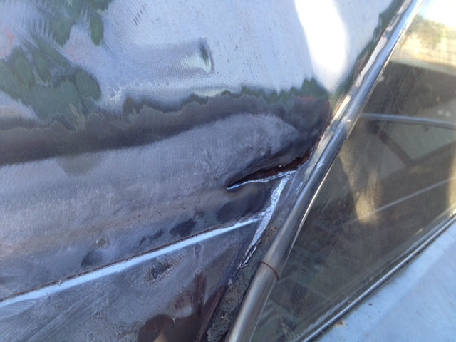

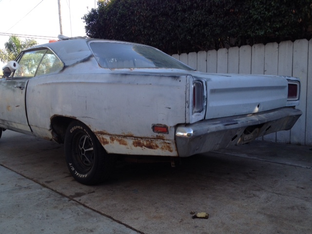

Haven't been doing much. Went out and got all the lead out of the seams with a propane torch. Spun the car around and put it back on jacks. Other then that not much going on. I'd take the quarters off but I'm not sure if I should do some bracing. Have to replace the quarters, dutchman panel, and trunk floor. Also what would be the best order to go in. I would think trunk floor first so I have plenty of access with the quarters off and fresh metal to put the new extensions on. Then quarters. Then the dutchman panel. What do you guys recommend. Also found some rust right next to the seam.
