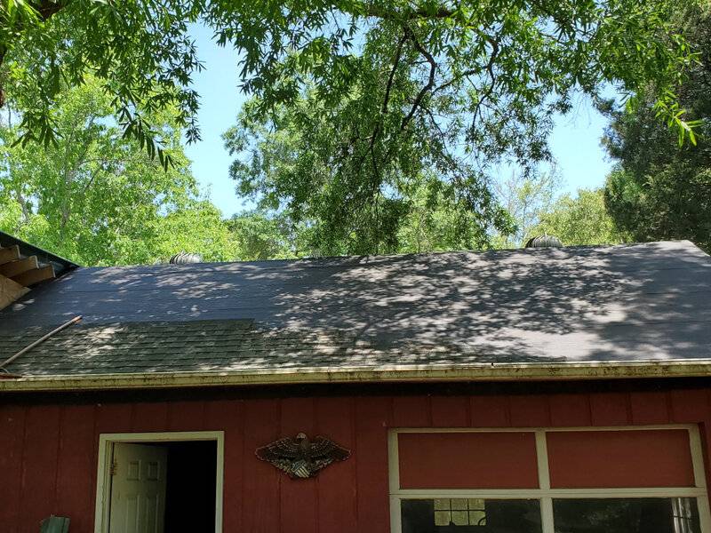

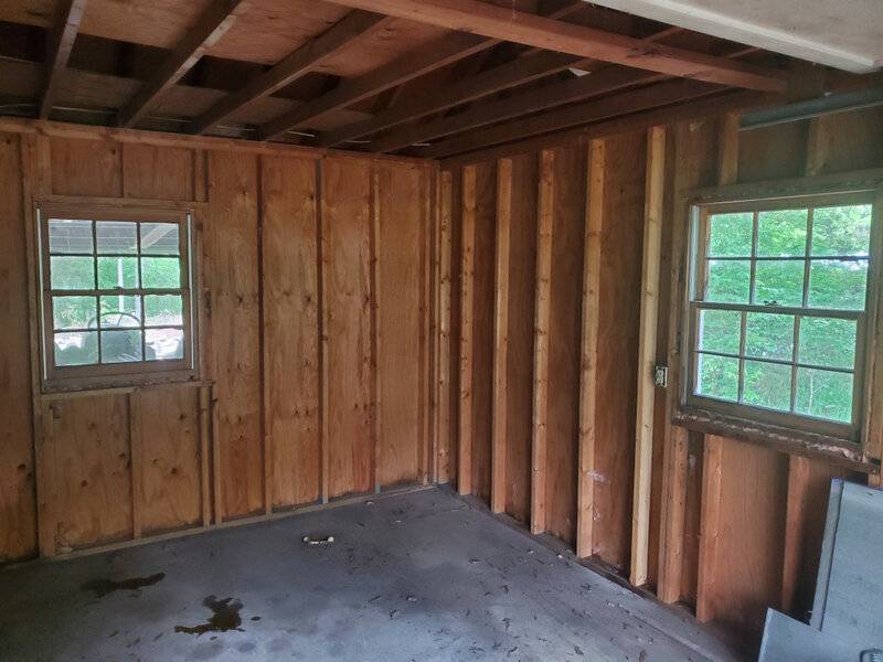

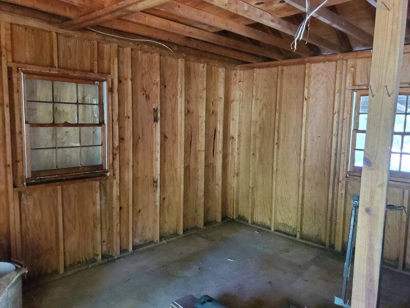

Got all of the pegboard off of the walls and all of the insulation stripped out of the old shop for dismantling . . .
Next part . . . get the roof off of this thing . . . to get ready to move the walls . . .

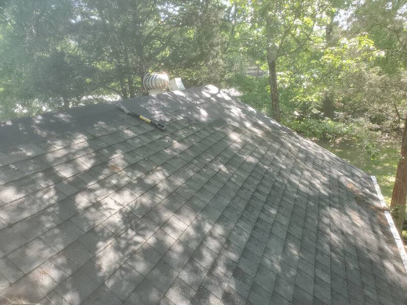

GAWD - I hate fiberglass . . . shingles in this part of the project . . . UGH !
Next. get the shingles off of the roof . . . this was after about an hour of work . . .
Then about an hour later . . . I get a bit faster as I figured out what I was doing . . .

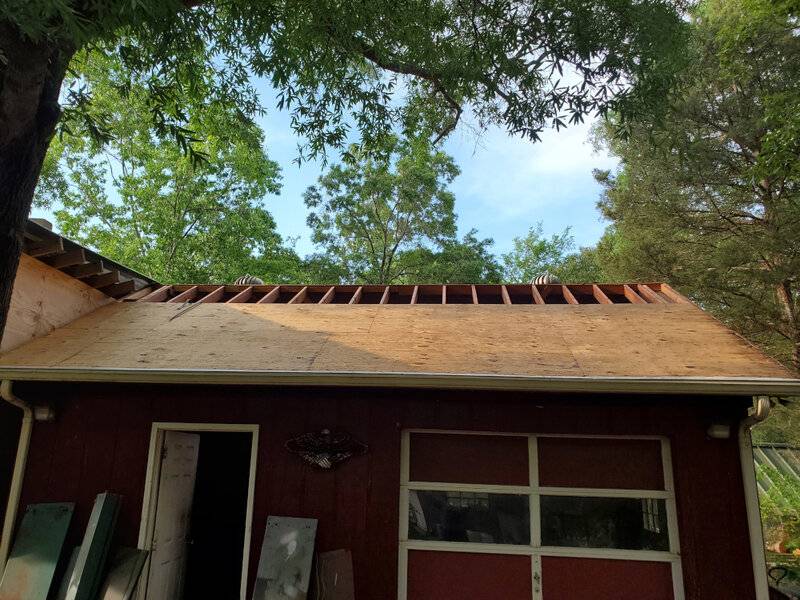

Good progress on the front roof . . .
Front roof is stripped and completed . . .

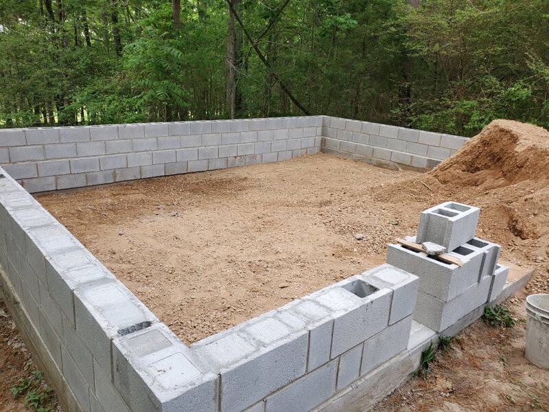

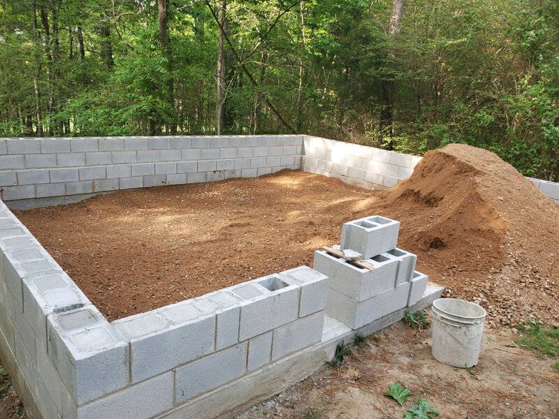

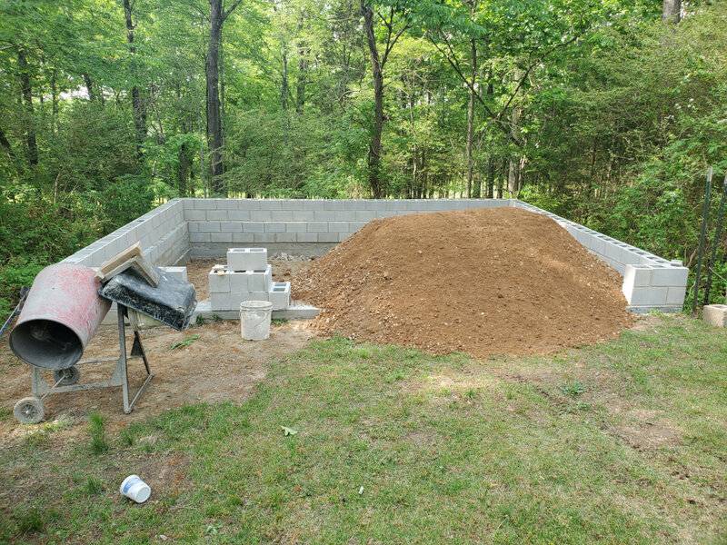

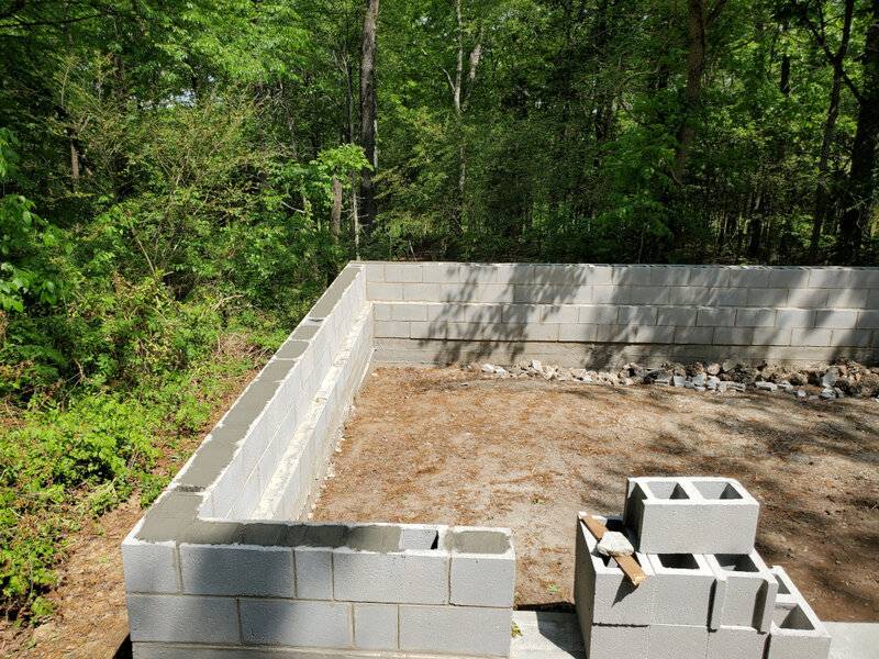

Needed a break . . . had to get the remaining bags of concrete out of the shop as the roof was coming off

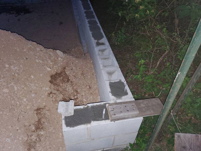

So I got them mixed up and poured into the blocks on on the foundation . . . open ones will be for anchor bolts

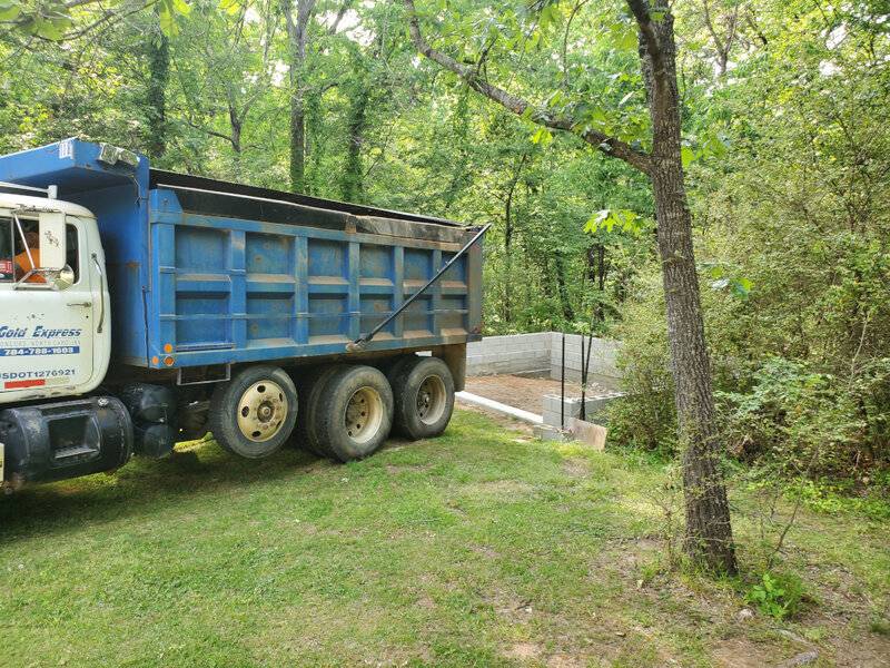

Then also got a delivery of crush-and-run (ABC stone) for the foundation . . .
Now all that I need it to get it spread out and compacted . . . OH BOY ! ! !

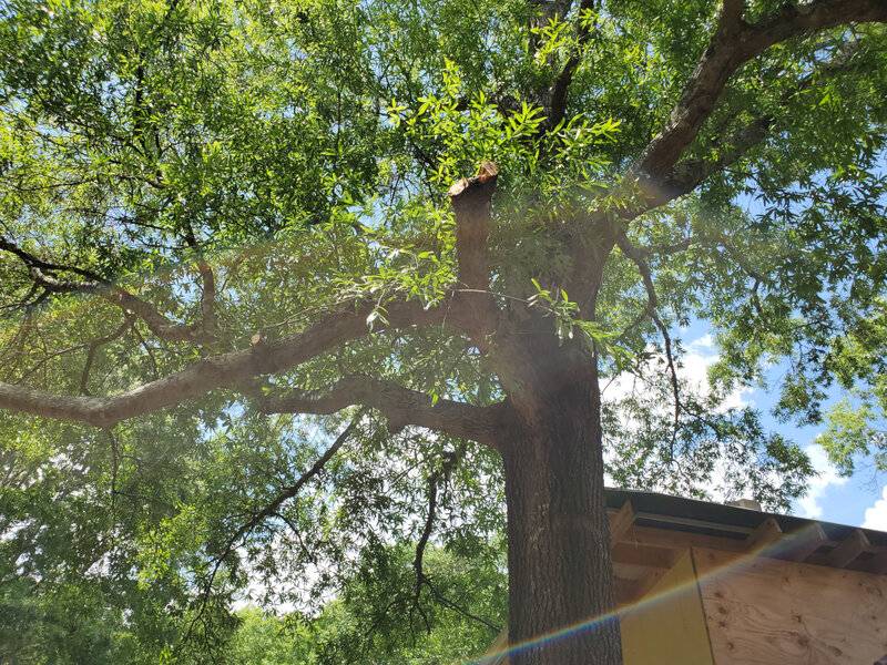

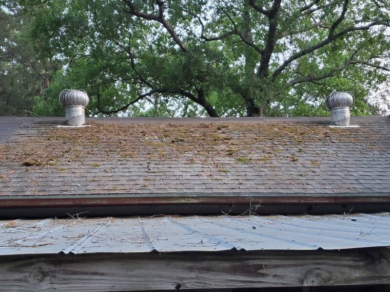

By the way - moss grows on the North side of the tree ( and building roof )
Got some GREAT moss samples if anyone is interested . . .

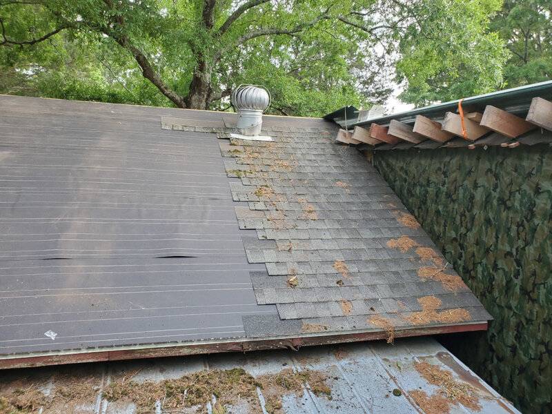

Got about 3/4 of it done before I ran out of steam . . . . tomorrow is another day . . .

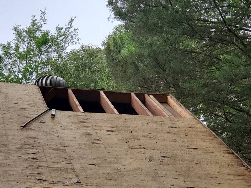

Just got a few shingles left and the roof vents to get removed . . .
See all the stuff on the metal roof . . . that's all POLLEN . . . it's really thick down here now . . .

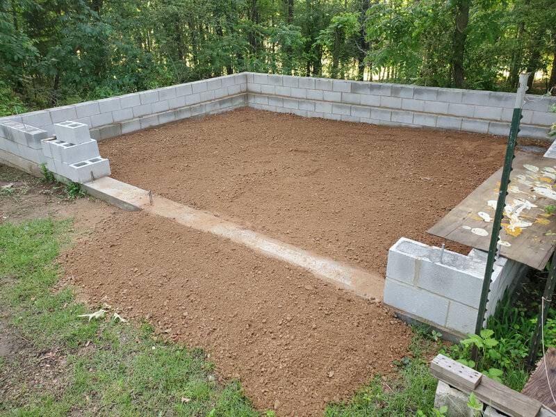

Got started with spreading the crush-and-run stone in the foundation - got rain coming in tonight and tomorrow
Want it down and in place do help with the compacting . . . but want to do it in layers and need a compactor
Gone as far as I want to . . . till it gets wet and compacted . . . then work on the rest in 6" layers . . .

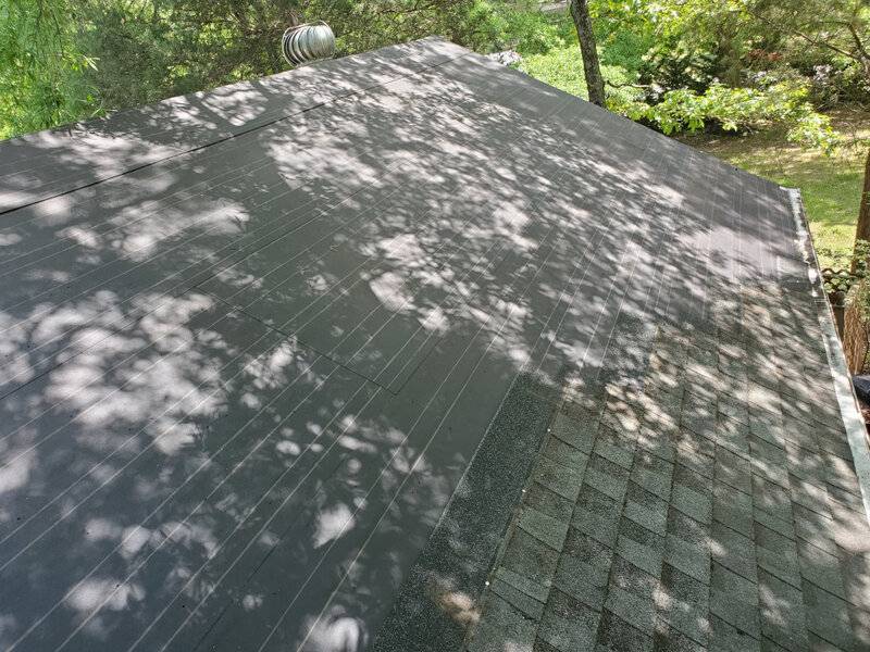

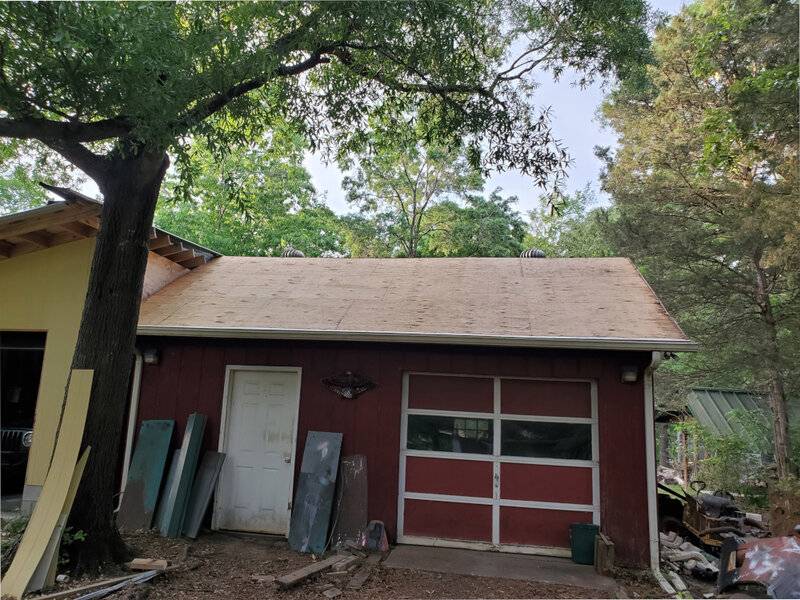

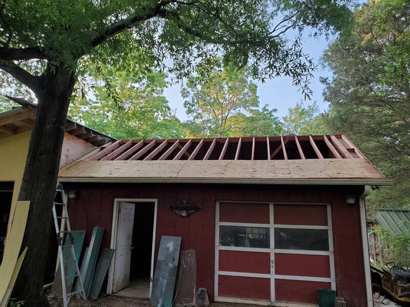

Made good progress this week, getting the plywood off the roof - got all the shingles off already.
As always - first step, get started . . . put your head down and get to it . . . the first sheet . . .
Then the first row . . .
And . . . the second row . . . .

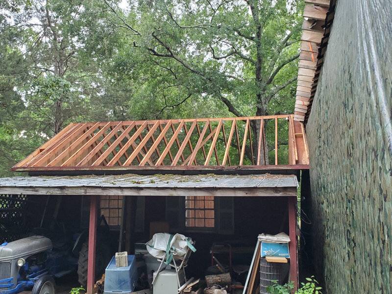

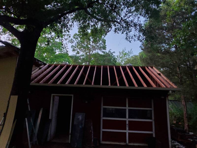

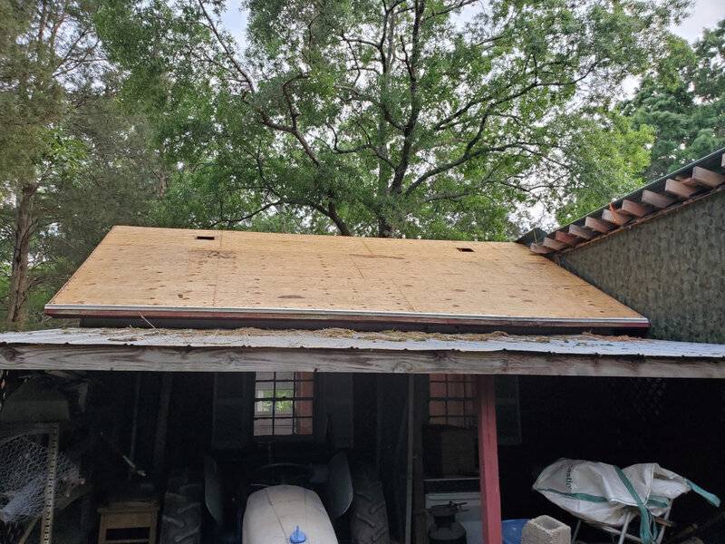

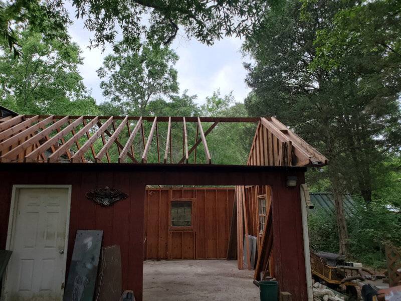

And with the third row done - the front of the roof is stripped . . . got the panels set aside for re-assembly later.
The back - however - was a different story . . . All week there was NO mention of rain this weekend.
Had to stop my dismantling process twice - due to rain - and try to work between the rain breaks . . .
But . . . Was able to get the back stripped and stacked with the other panels for later ( and to stay dry-ish)
Next step - is to take down all of the joists - they too will be reused in the re-assembly process . . .
Plans - to do a better job making trusses out of the joists so the center support pole will not be necessary
That center post was both used to hang things - and be in the way (most of the time)
Plans are to lave the lean-to standing ( I hope ) - to cover the stuff under it . . .
Will keep tearing into this thing . . . one day atta time . . .

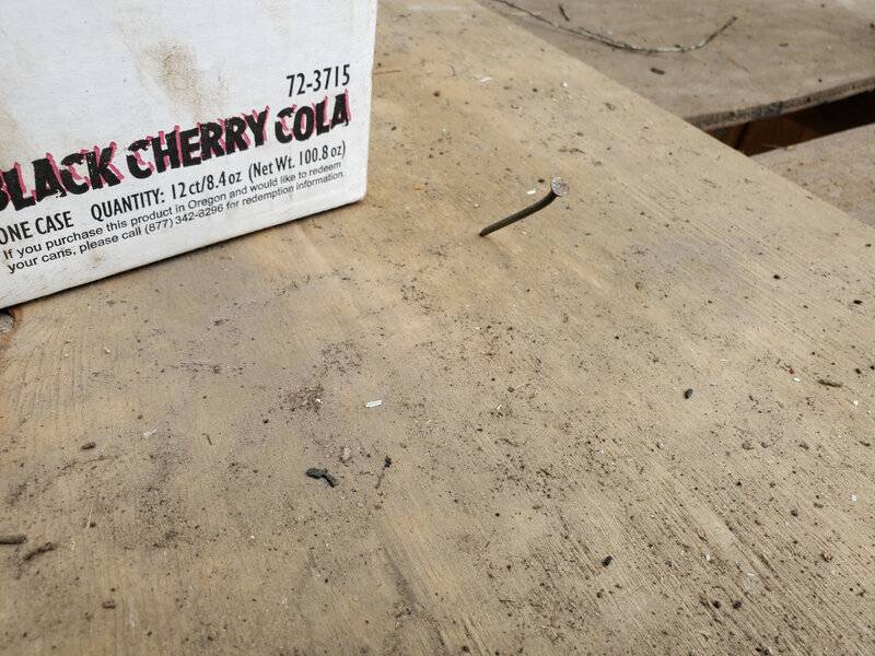

This was ( by far ) my best ( and worst ) shot of the day . . . from about 10 feet out, trying to get in in the box . . .
Worse . . . did not make it in the box
Best . . . Nailed it ( actually stuck in the plywood like you see in the picture )

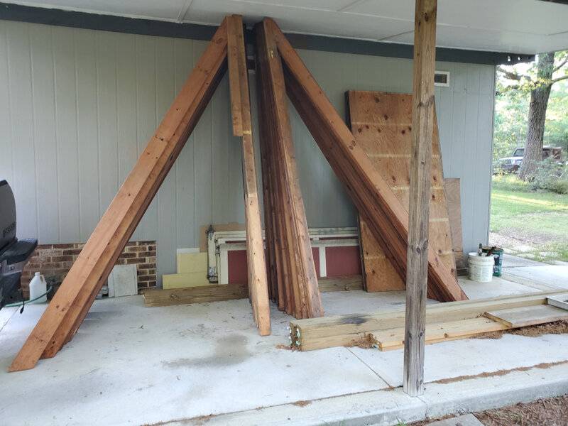

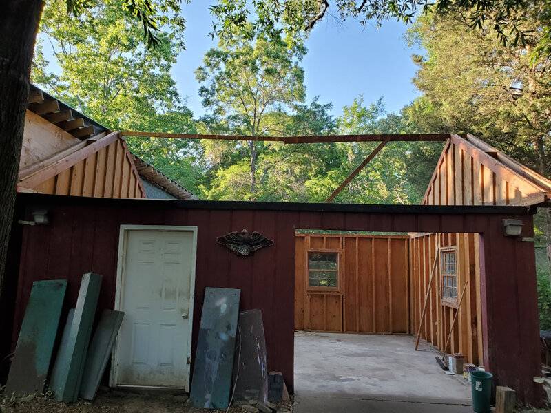

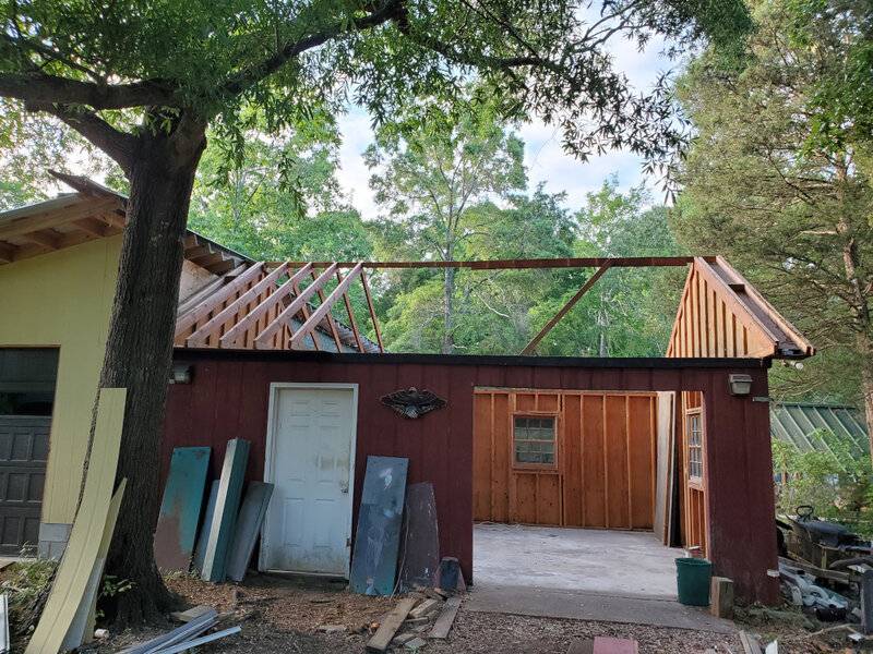

Today after work, with more daylight, and a bit more fresh, tackled the last 4 "trusses" . . . removal . . .
Most of this work had to be done from a ladder ( the back side has the metal roof to walk on )
And success . . . got them all down, no major injuries ( one good finger gouge - no pics ) - but it's all down
This shop has more room and more light than I remembered . . . LOL . . . it's STILL moving ! ! !
All the "trusses" ( actually partial trusses ) stacked up under cover to be out of the weather . . .

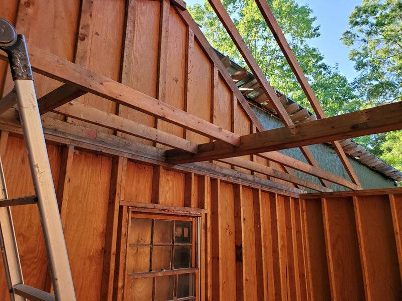

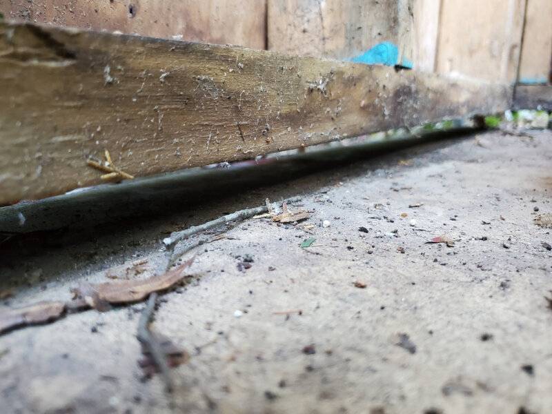

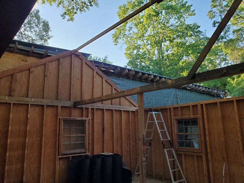

So the one recurring thought that has been "lingering" in my mind . . . will the walls actually "move"
So . . . it was time to investigate . . . with a 6x6 and a floor jack in place . . . and a few pumps . . .
Houston . . . we have daylight . . . the walls will move . . . ( actually scary - not even bolted down ) . . .
What did I learn . . .
- the nails actually pulled out pretty easily, at time, so no wonder tornados tear apart houses . . .
- asphalt shingles are heavy ( and did I mention how I hate fiberglass . . . )
Need to shore up the garage door opening and the people door for the move . . . to hold the wall shape
Need to figure out how to separate the walls . . . and the first wall I can move ( the front wall )
- will actually be the LAST wall that I will need to place in the new location . . . ( figures )

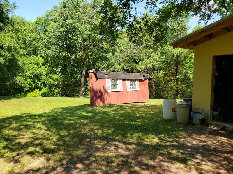

Project Titus - Preparing for "Moving Day" . . . 101 . . .
Getting close to that time, so there are some things to get squared away . . .

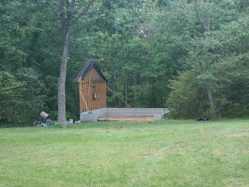

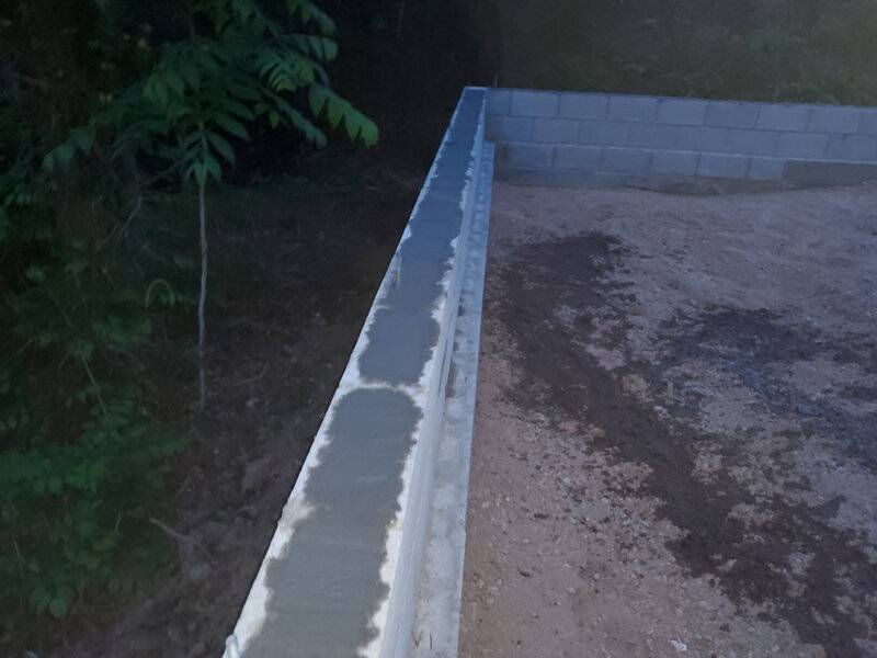

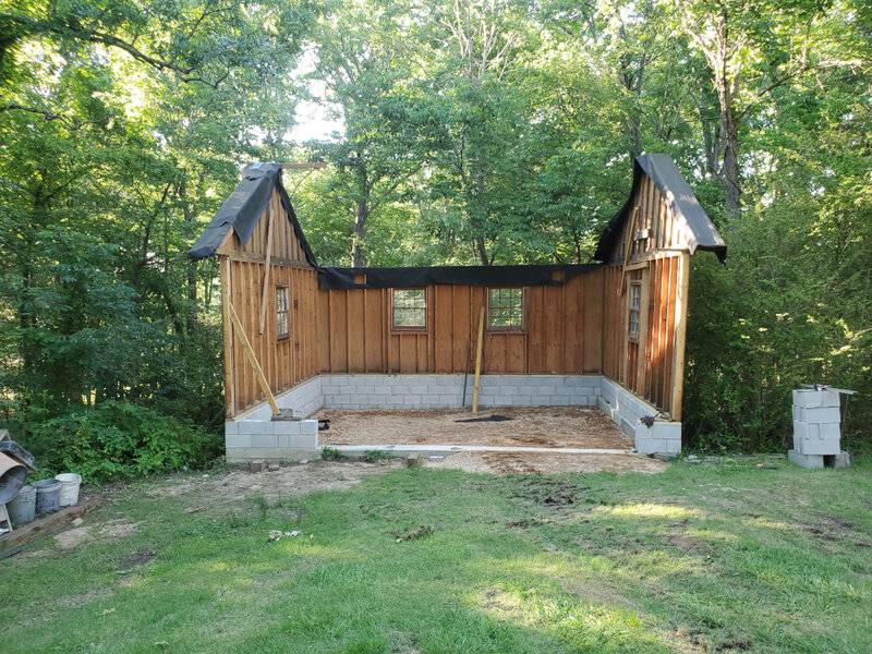

In order to get the building set in it's new location - need the anchor bolts in concrete . . .
Checked . . . Miss calculated my concrete needs by 1 bag . . . ARGH . . . figures . . .
Got almost everything done . . . most of the concrete and all bolts are almost set
So . . . it's getting close . . . however I'm going to pull this thing off . . . still to be determined . . .

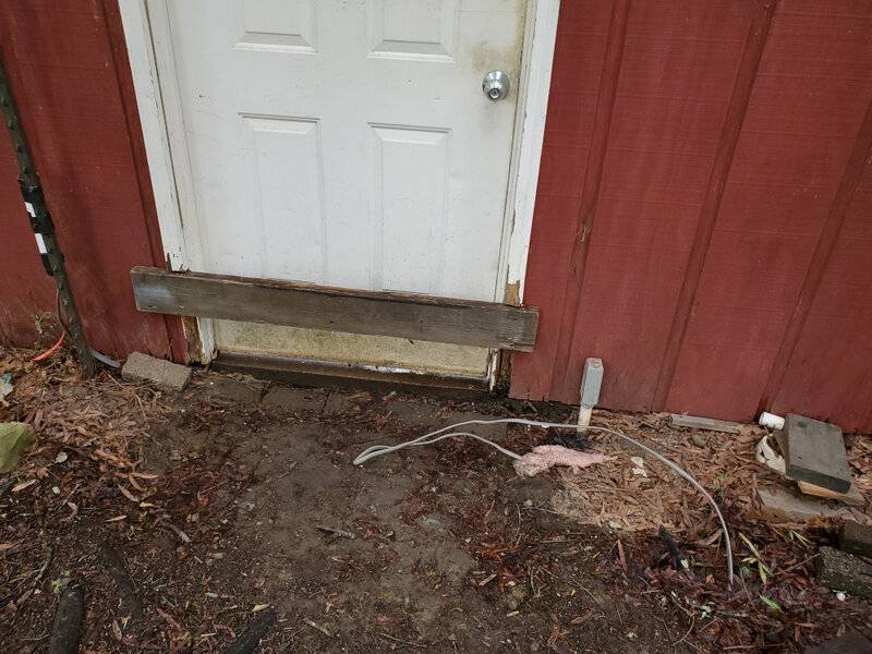

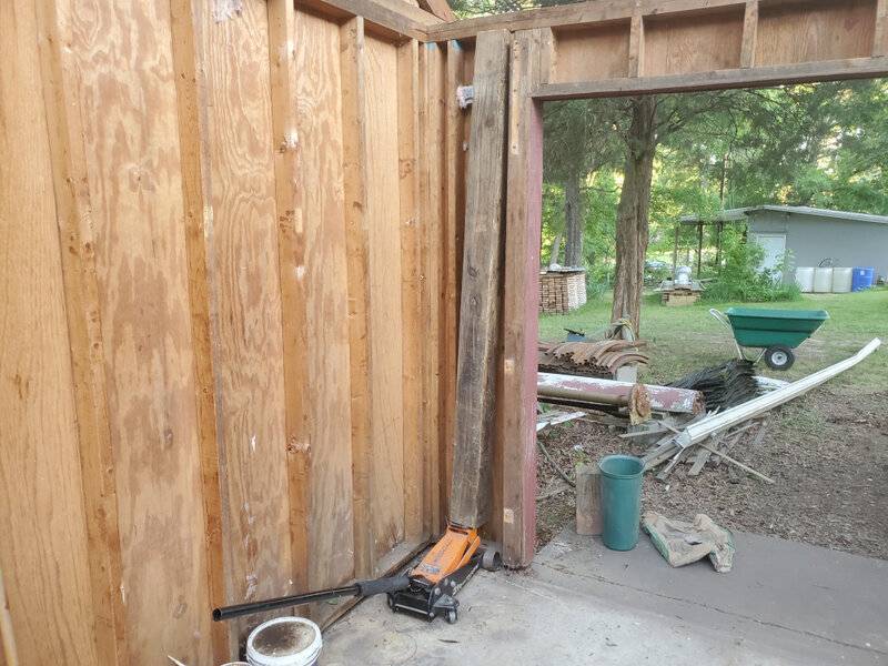

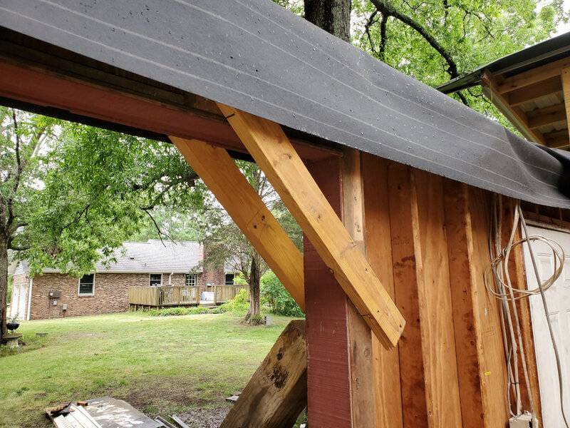

Shoring up the building . . . this wall has openings, and they need to stay in place . . . adding supports . . .

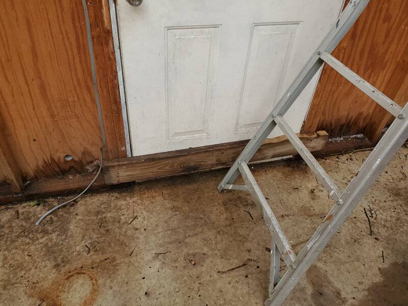

On the people door - both on the outside of the door . . .
And - for safety - on the inside of the door too . . .
The garage door was an even bigger concern . . . 8' of opening that could "move" on me . . .
Wondering what the cross boards in the door are for . . . I can be a bit of a Klutz
My luck, without them there, I'd try and run into the shop and trip . . .
Trying to prevent myself from tripping over the boards ! ! !
Added these additional "structural" cross braces for added security and strength . . .

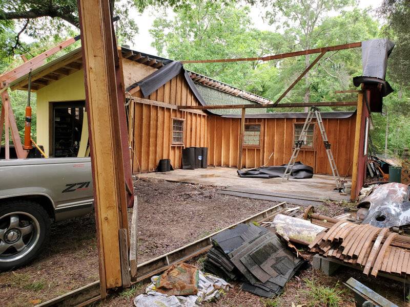

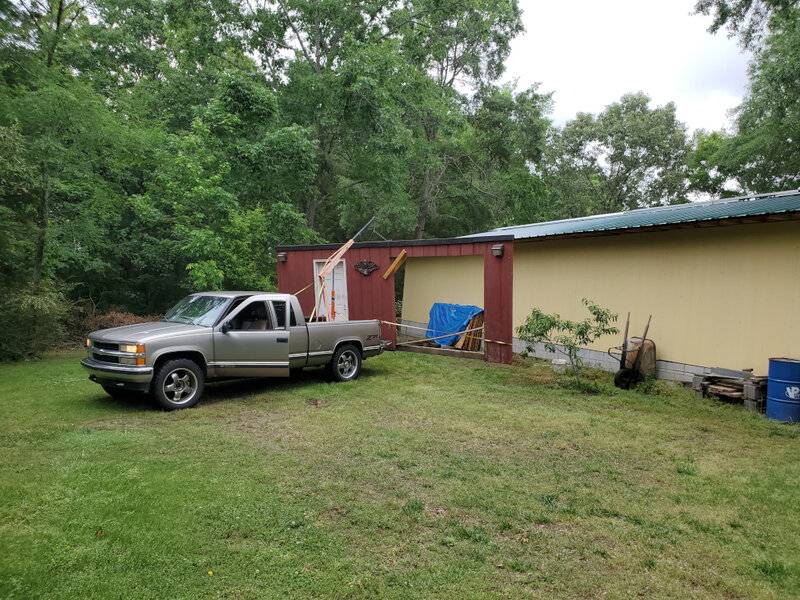

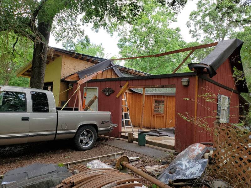

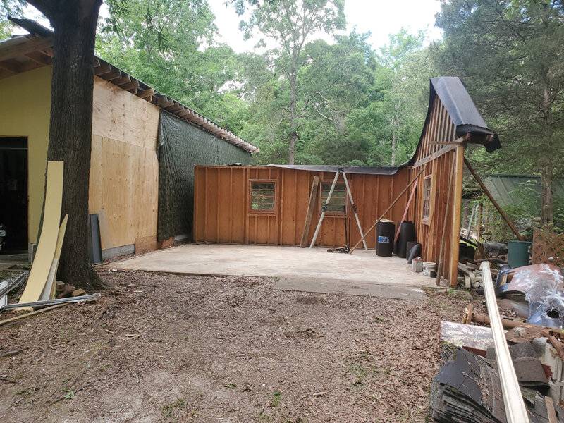

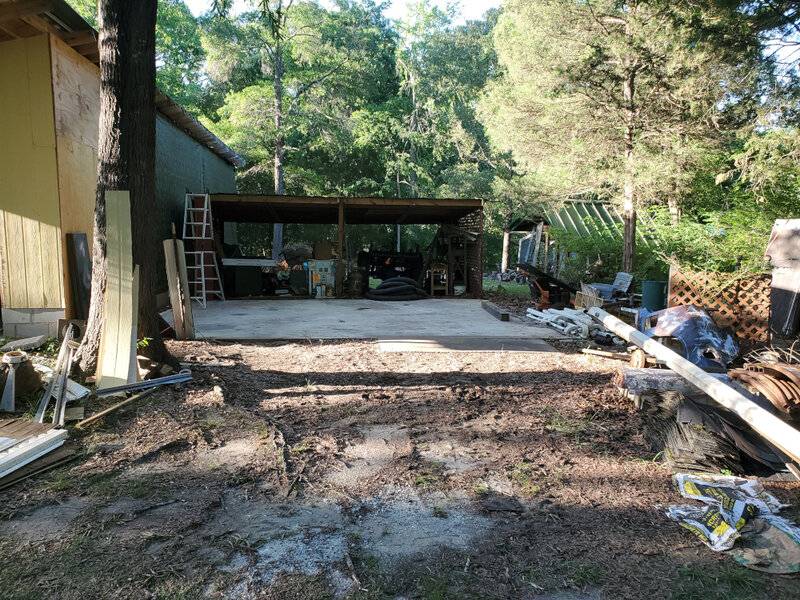

Project Titus - The move has begun . . .

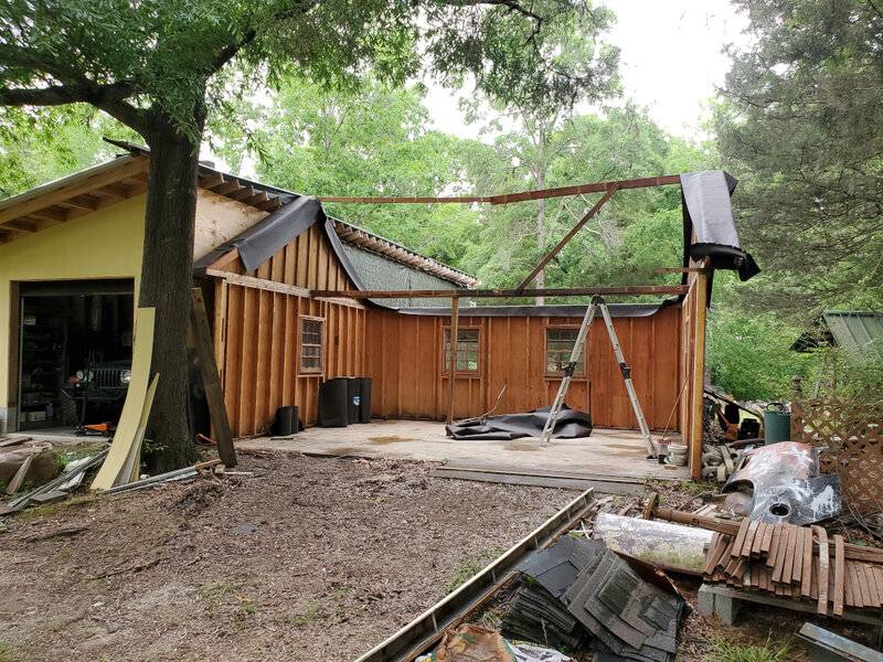

Just a quick little teaser . . . the move has begun . . .

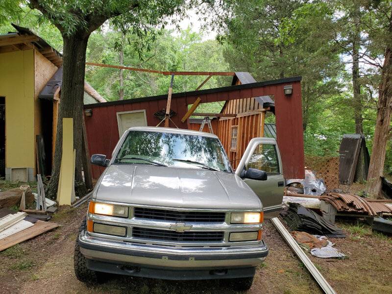

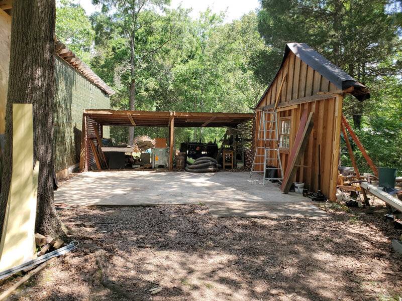

Interestingly . . . The first wall that I have access to on the "old shop" is the LAST wall
that will need to be installed in the new location . . . it will need to be moved and stored . . .
The next question . . . Uh, where ? ! ? !

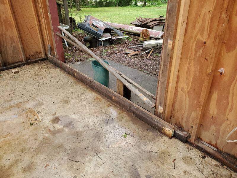

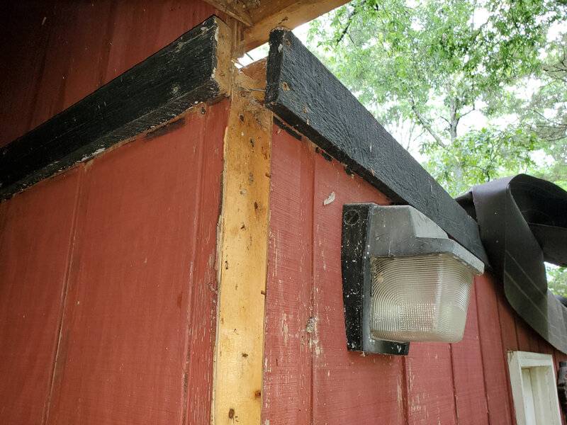

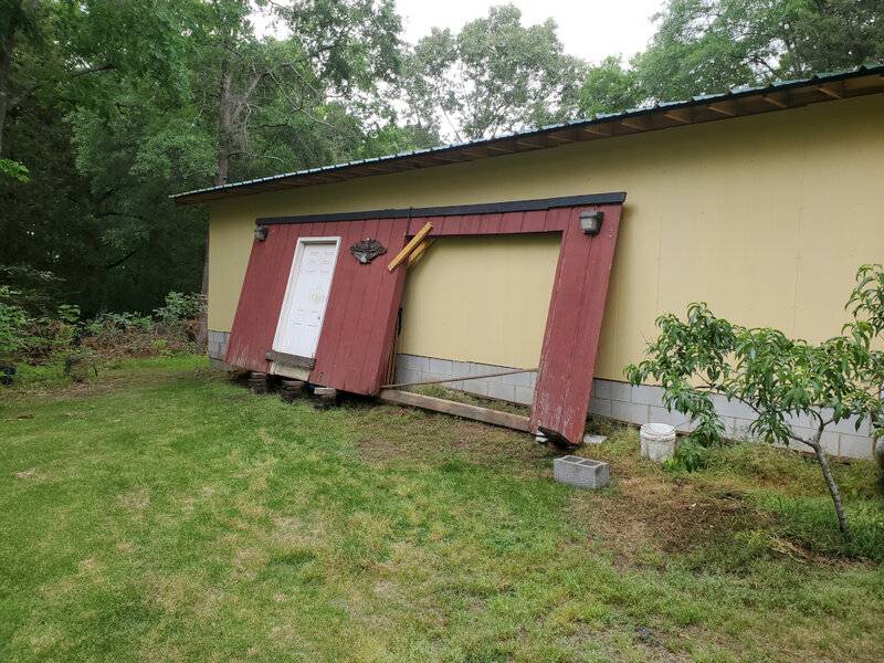

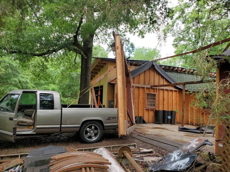

But first . . . the walls need to be separated - so the front wall can be moved . . .
Got the wall separated . . . now . . . it's ready for moving . . . wish me luck . . .

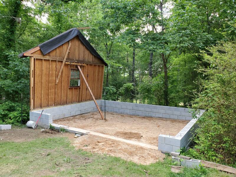

Well . . . proof is in the picture . . . the front wall has been moved . . .
And . . . found a pretty good place to store it ( I think ) . . . the bracing worked pretty well too ! !
Got a lot of things left to do . . . and 3 more walls that will need to be moved too . . .
More later . . .

Project Titus - For the record:
The front wall of the shop, and the storing of the wall was ALL accomplished by myself . . . did not have any help in the process . . .
How ? ! ? !
More later . . .

First step - the mound of ABC stone was in the way ( it really needs to be compacted ) one step atta time . . .
Got it all moved around and left a "ramp" to allow access to the foundation area for the walls to be set in place
Got the last of the cinder block walls filled with concrete, and had a little left over . . . so left a memento for later

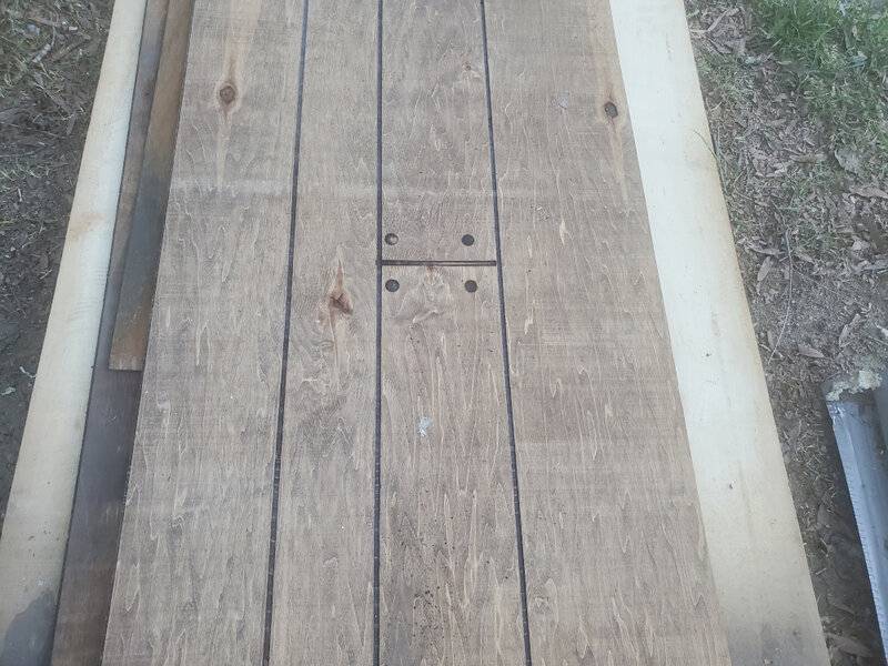

If anyone ever tears down this building, they'll find this in the foundation crush and run under the slab . . .
For those of you that might not know from some of my other threads . . .
BSH is a monogram that I use on my projects - Brick Sh*t House - cause that's how I build things . . .
And of course . . . had to add the year . . .
Knew that the walls were probably not going to fit under this tree - so some trimming was necessary . . .
And . . . the left side wall has been moved . . . that was quite the chore ( had a friend help with that one )
And . . . The left wall has been set in place on the new foundation . . . and the verdict is . . .
Every bolt hole lined up perfectly ( amazing ) and the wall is bolted in place . . . whew . . . what a chore
What you see here is "temporary" supports - there is one around back too - to hold the wall in place
( the bolts are NOT enough to keep and hold this wall in place - not by a long shot . . . )
What was done for more "permanent" bracing - was to utilize the other anchor bolts to help hold the wall in place
And that worked like a champ - once the back wall gets in place, things will stabilize a a whole better . . .

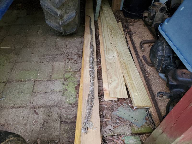

Next part of the project to tackle . . . was the back wall . . . and in the process of separating the wall
Found this in the lean-to on the back of the shop - 6' black snake skin . . . he's a big 'un ! ! !
The rear wall was a bit more of a challenge . . . for several reasons . . .
- The lean-to on the back was tied into the back of the shop with joist hangers - so I had to something about that
- the 6 x 6 on the left was added - and the 4 x 4 in the middle was added ( had to think of these things )
- my biggest concern . . . the right wall - with nothing left to hold it in place - my concern was stabilizing it
- added the 6 x 6 on the inside - with the brace to the 2 x 4 studs
- added multiple 2 x 6 braces on the back side to hold it the other direction
- plus added a ratchet strap from a hook in the wall - to a tree to help hold it in place
Think that I've got it secured pretty well . . . until it can get moved to it's new location . . . ( hopefully soon )

Project Titus . . . Inquiring minds - want to know . . . You sure you're ready for this ? ? ?
I assume . . . everyone is "curious" as to how the walls got moved . . . so . . . here's picture proof . . .
Starting with the front wall . . . it was basically moved to a storage location to get to the other walls . . .
Believe it or not . . . this is how it was done . . . With the help of my redneck wrecker . . .
Trying to get that wall maneuvered around that tree - and the junk . . . by myself . . . took a bit of time
Had to try and "guess" the balance point of a wall with a people door and another 8 foot garage door
From the pic - you can see my first attempt was low on the far side and high on the near side . . .
Literally move the hook on the cherry picker over 2 chain links . . . and it balanced . . .
Could not believe that I guessed the balance point on that will within 2 chain links ! ! ! Got lucky ! ! !
Was able to use a ratchet strap to move and hold the wall, where it was needed, to get by the tree . . .
Slowly . . . worked my way around all the obstacles . . . to get it moved out . . .
Had a stack of all the roofing plywood on the side . . . perfect place to locate the wall (for the time being)
Yeah . . . believe it or not . . . that's HOW it was done . . .

Project Titus . . . Pretty successful day after work . . .
Can't complain . . . the pictures speak for themselves . . .
The old shop location is now bare . . .
And the new shop location is sporting (3) new walls . . .
This has added a lot of strength to the structure . . . that makes me feel much better . . .
Next step . . . add the blocks for the front wall and get it in place . . . and work on roof trusses . . .
