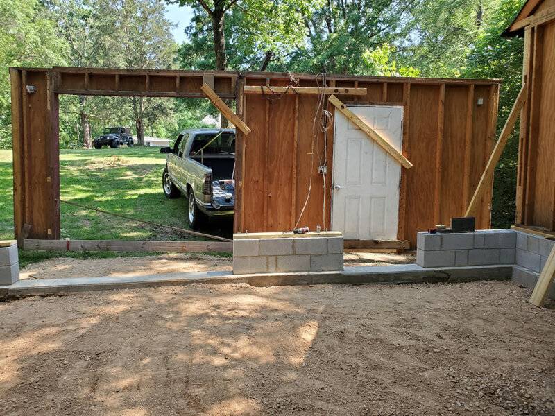

Here's a pic of me moving the first tall wall with my truck . . . it was quite the task - I did have a helper for this.
Even got the wall all the way down to the foundation . . . abut that's where things changed . . .

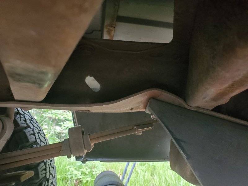

It was quite apparent the my "set-up" was not going to be able to work for a couple reasons
- my truck does not have the mobility that would be need to get the wall in place
- the wall was very heavy and I was worried about what "could" happen if this route was attempted
- the engine lift was not going to be able to lift the wall high enough to get it on the bolts . . .
So . . . it was time to resort to Plan B . . . after getting it almost there . . .
Had to call in the big guns to assist with placing these wall . . . A neighbor assisted with this . . .
( had it done in about 15-20 minutes - cost me a 12 pack of beer and a pack of cigarettes )

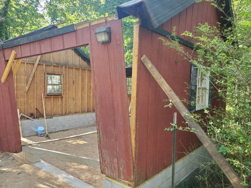

The shop was technically help down, although I said it was not . . . but it was only held in place with concrete nails
When the backhoe lifted this wall up . . . the pulled right through the wood . . . so it was not very good.

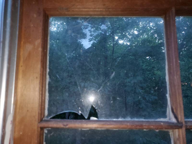

If you look back a couple pictures, with my truck and the wall at the foundation
- there is a brace in the back of the wall - holding the wall so we could swap from my truck to the tractor
- Did not get the brace moved quite in time . . . and put it through one of my windows . . . Argh ! !

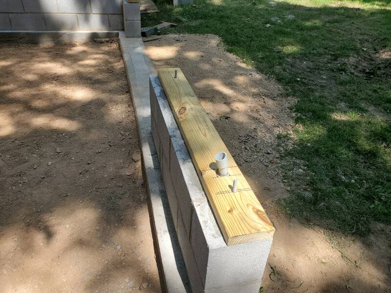

Getting ready . . . get the sill plates fitting over the bolts and conduit . . .
That turned out pretty good . . .

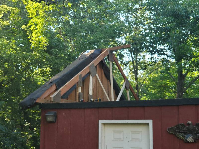

On March 25 . . . I started the footings in this new location after clearing the land . . .
On May 3rd - I started stripping the insulation out of the building . . .
And on May 20 . . . the building is completely moved . . .
That's 17 days to completely remove the roofing, plywood, trusses, dismantle the building and get it moved.

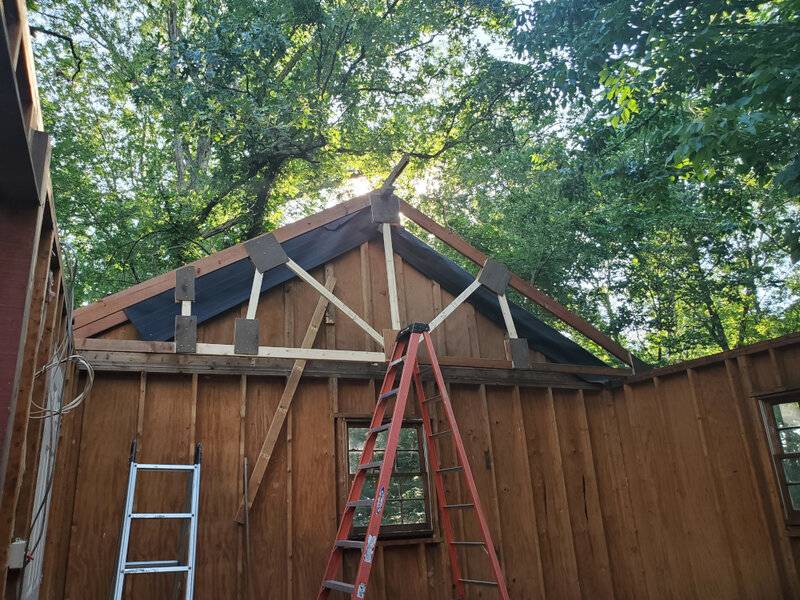

Now that the walls are all in place, it's ready for the roof trusses - however . . .
It did not have "real" trusses - just 2 - half trusses nailed to 2x4's at the top and bottom . . .
So . . . I'll be taking the 2 - half trusses and making them into a true truss . . . ( or that's the plan )
Spent most of the day, running around looking for supplies, returning stuff I got and didn't like.
And trying to find the best stuff, and way, to get these things built in my true BSH fashion . . .

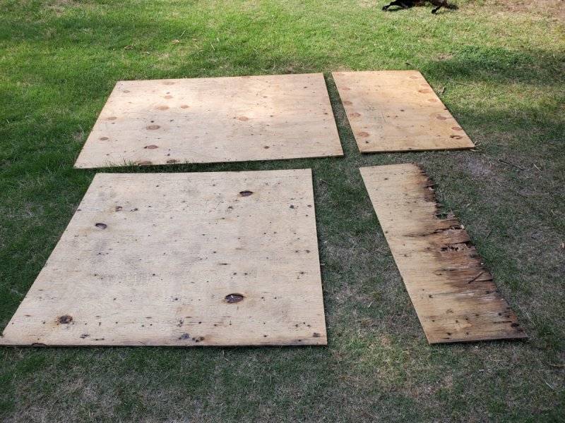

Took (2) of the 4 x 8 sheets of plywood and got them ripped on the table saw into 1' shares and other shapes
- these will add the structural support at the joints where the pieces meet
Good news . . . got this wonderful slab to use for assembling the trusses . . . first the layout . . .
- the 2 x 4 in the center is to replace the ones that were there, top and bottom, that they were nailed into.

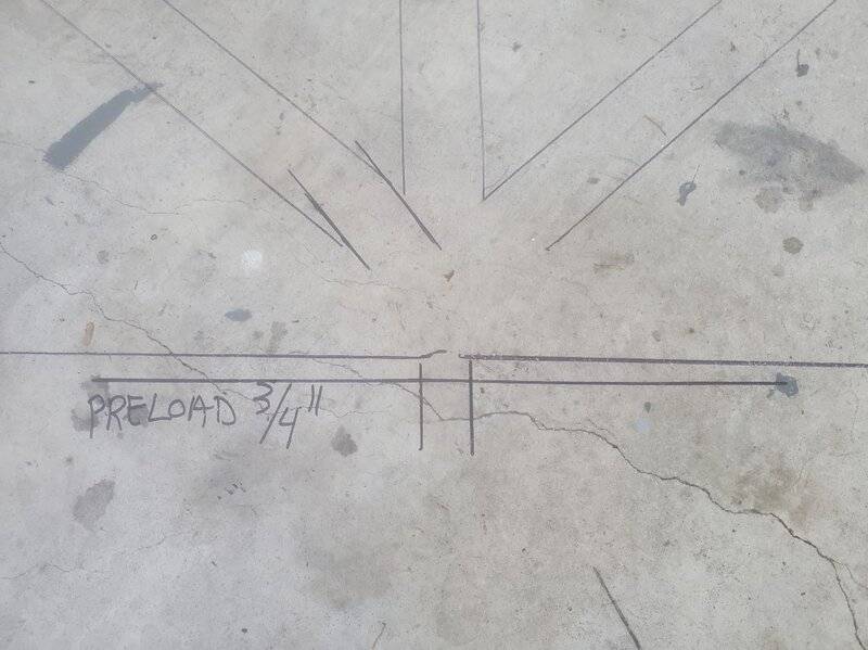

- after I got the layout - ran a string from the bottom outside points to find where they were level . . .
- next step - added 3/4" of preload to the bottom of the truss
- one it was all set up, marked the corners, the bottom preload location, and all the cross members on the pad
This is layout that I'm going to use . . . should work out just fine . . .

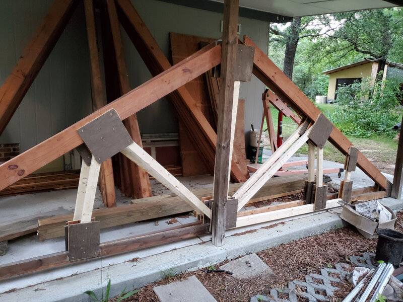

After a lot of running around, cutting plywood and getting ready . . . actually got 2 done . . .
Only 14 more to do and they'll be ready to get installed . . .

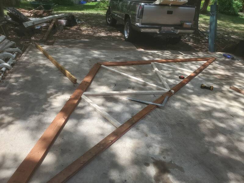

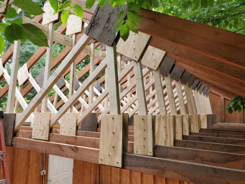

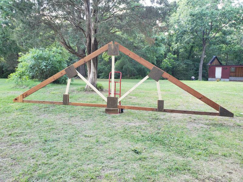

To make the trusses "somewhat" uniform in size and shape . . . I drew the plans on my concrete slab . . .
Was able to work on a couple - could only get 1 built after work . . . and rain was always possible this week
Spent part of today getting, preparing, and cutting a bunch supplies - think I've got everything I need now
- - - second thought - will probably need more screws as I bought out the store . . .
Found this to be a pretty good way of moving these things . . . but 19' makes it dodge the trees . . .

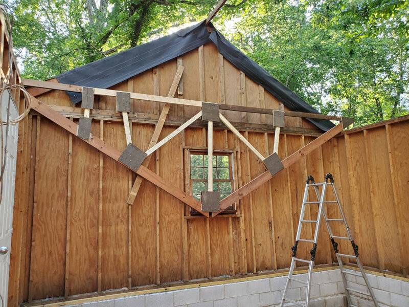

Pre staging . . . the first roof truss . . . ready to get it up in place . . .
This part was a bit tricky . . . but I got it done . . . now "just swing it up into position" . . . right . . . .
Actually . . . that's exactly the way the thing went . . . just had to come up with a "plan" . . .
Wow . . . 1 down . . . and only 15 more to go . . . but some still need to be built . . . yet . . .
Got 5 more completed, and already pre-staged . . .and ready to get put up into place . . .
Now that I've got the first one done . . . "maybe" these will go a little faster . . . NO Promises . . .
And in the process of working on this . . . found some other areas that are in need of a little repair . . .

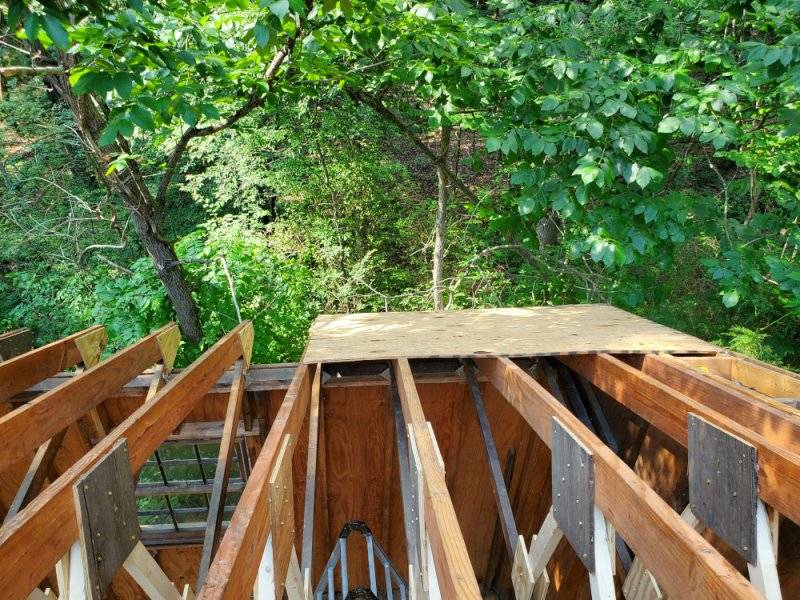

Got a long 3 day weekend . . . and I'll swap between building them . . . and installing them . . .
And "hopefully" . . . get to installing some of the decking on the top, will be reusing the plywood that came off.
Actually remembered to number them so that they can go back in the same spots . . . (same with the trusses)
Going to be a busy weekend . . .
Even though it's "just" a moved shop, I can't just throw it up, I'm working on truing things up, making them more structurally sound, adding hurricane straps (that were not there in the first place), and just trying to make this better than it was . . . and make it last . . .

Truss #1 installed . . .
Truss #2 installed . . .
Truss #3 installed . . .
Truss #4 installed . . .
How far was I able to get on this project this weekend . . . keep watching . . .
More later . . .

First of all . . . All 16 of the roof trusses have been completed, installed, and secured in place.
The first piece of plywood was installed . . . after a little set-back - they got some mold on them
They were washed with a 3-1 Clorox/Water mix, and brushed it all off . . .
Got a plan figured out . . . and continued with getting the first 6 pieces (of 12) on the back of the building . . .
Another view of the progress . . .

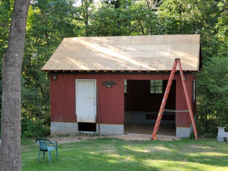

Trying to get the front of this building done - got rain in the forecast for Wednesday . . . and would like it covered
All of the good pieces of the roof decking are now in place . . . the missing (2) pieces are in less than desirable shape
The top 2 are the bad panels . . .

So . . . time for some roof decking Tetris . . . ( the bottom sheet was removed from the roof )
The plan . . .
- use the bottom sheet to cut the bigger piece of decking - get it whole and complete
- use the middle sheet to cut the smaller piece of decking - get it whole
- the top sheet will be saved in case it's needed elsewhere . . .
Here's the cuts . . . the scraps . . . and the good "replacement" panels for the roof
Which allowed me to get the whole front of the building roof completed today . .
After showing you this . . . and looking at the project . . . the right side was dismantled to investigate a problem
Still trying to figure out how the roof right side is a bit out of kilter . . .

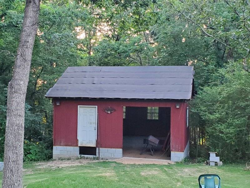

Now protected from rain . . . I hope . . .
Got the tar paper on the roof of this building to protect it . . .
Got "most" of the right side fixed, still got a section in the back, very bottom, that still needs some attention.

That building looks even smaller sitting out there by itself.
Yeah . . . it kinda does . . . but inside it looks so much bigger
- taller ceilings
- no center support blocking the middle of the shop
- and my "new" doggie door to fit my next Great Dane . . .
And . . . plans are to move some other things down in that area . . . keep watching . . .

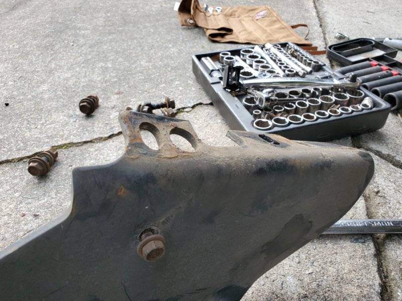

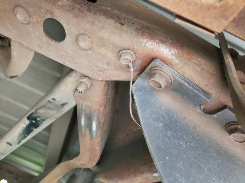

Here's the details of the accident . . . and truck damage . . .
Not too bad as he hit the receiver and it took the blunt of the force . . .
Don't think that it's supposed to be pointing in that direction . . .
Under the truck and the frame rails . . . folded up quite a bit . . .
Really wonder how fast he was driving and he never hit his brakes . . .
folded it up pretty good . . . wow . . . amazing . . .
Don't think it's supposed to be looking like that either . . . what do you think ? ?
Got the estimate from the insurance company so I can get started on fixing it now . . .
