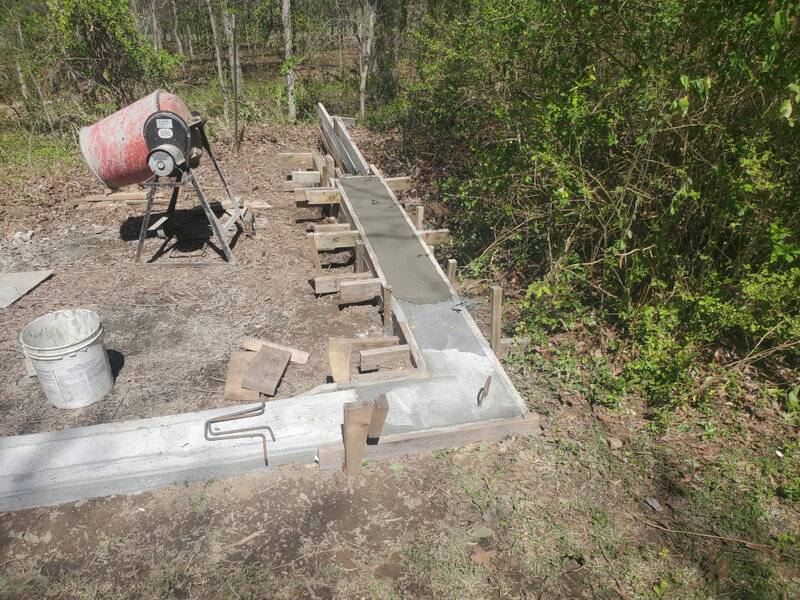

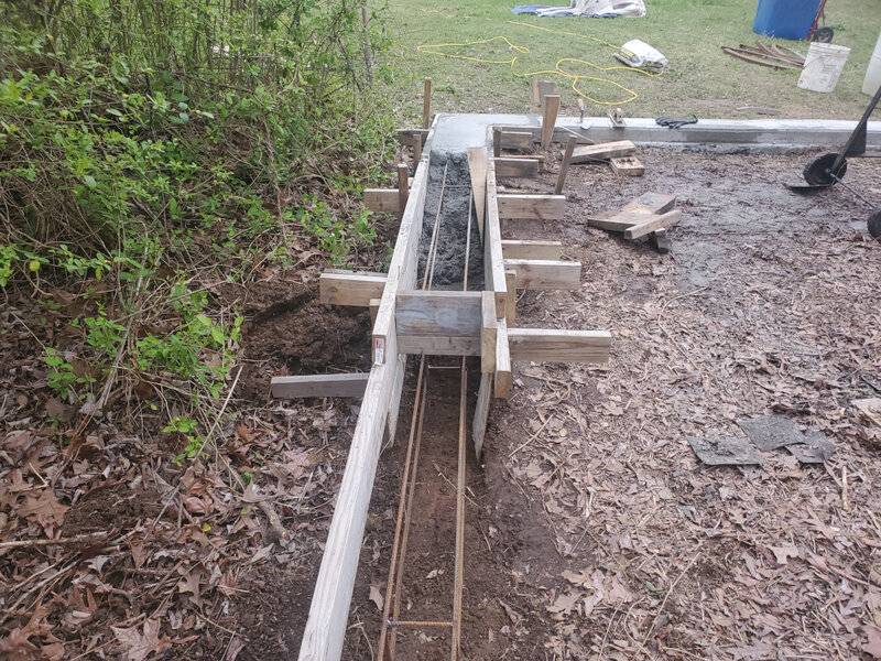

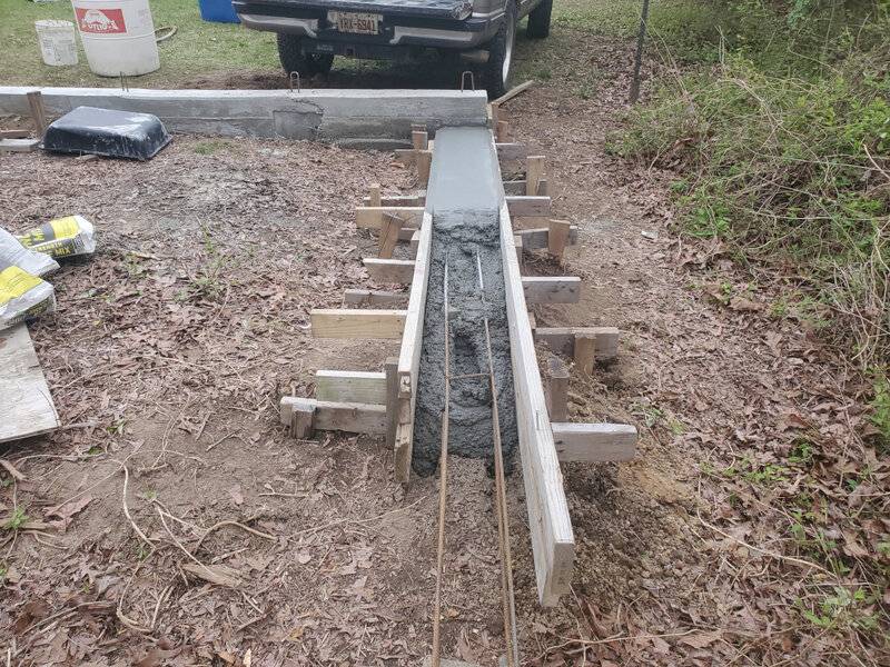

Here's the setup as I wok on the footers . . . set up to pour right into the forms ( not carry that heavy stuff )
Got a lot of this side done, need to get some more forms set up for the rest of the footer now . . .

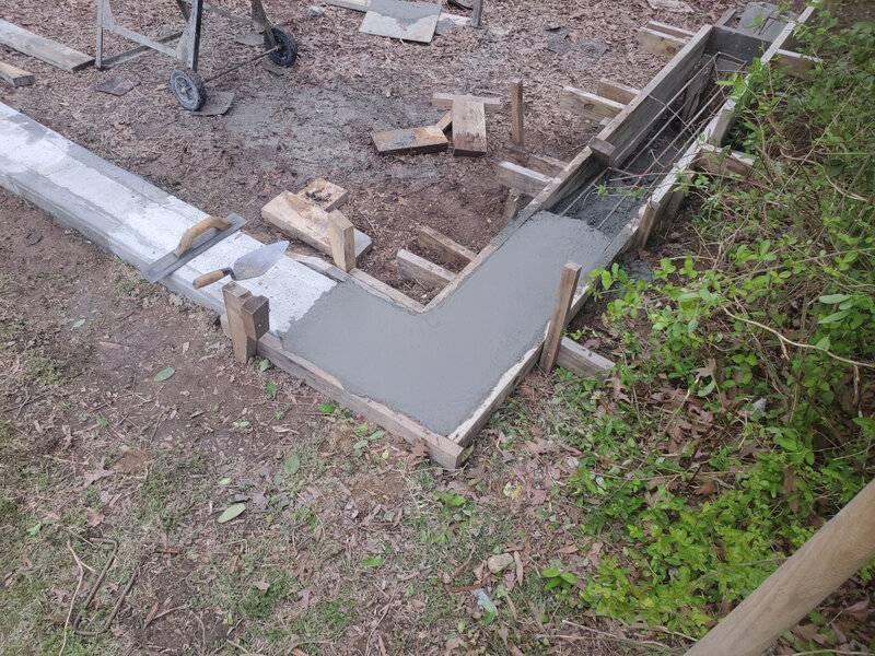

Got both of the front corners done now and heading o down the sides . . .

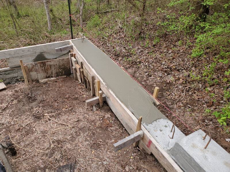

Had to put another step on the other side to accommodate the slope of the land . . .
A better view of the step . . . and the footers are now halfway done . . .
Work will continue as the forms are built, and the concrete is poured . . . one step at a time . . .

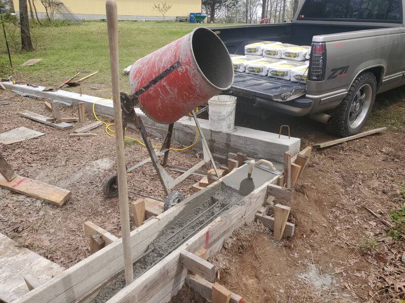

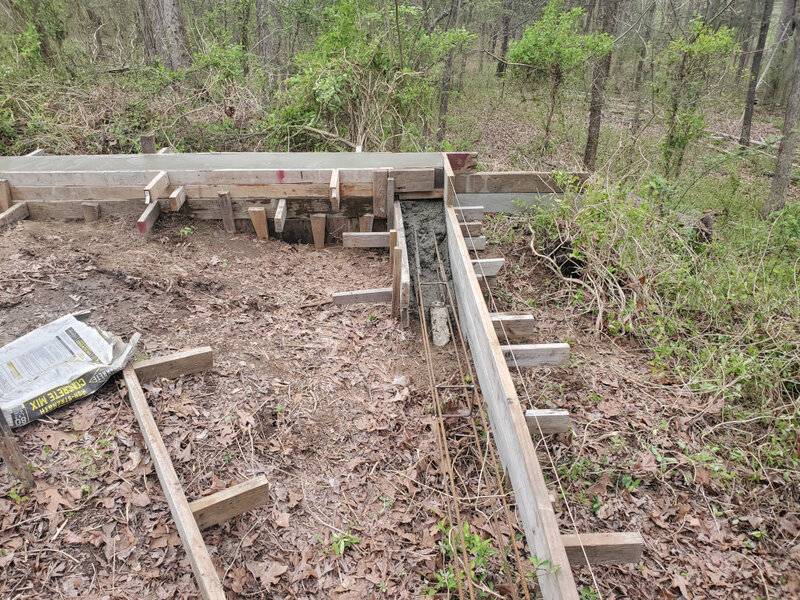

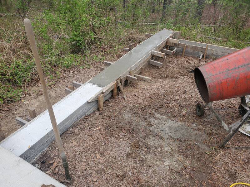

So onto the other side . . .
Was making such good progress . . . came to this side to get some more concrete poured . . .
DUH . . . in all the "excitement" . . . I'd forgot to make the rebar cages . . . ARGH ! ! !
So clean out the mixer - and go build the cages . . . and then get back to it . . .

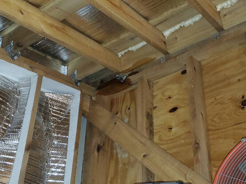

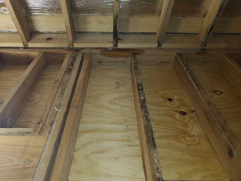

Had a little bit of rain this week . . . and found that I've got a few leaks . . .
The way I'm doing this build is driven by the fact that I've got 1 shop in the way.
So the metal roofing is not intended to be installed for long periods of time this way . . . and I'm trying my best to "waterproof" what I have until the rest of the roof gets in place to help seal everything up properly . . .
all small leaks . . . location 1 . . .
Location 2 . . .
Location 3 . . .
Location 4 . . .

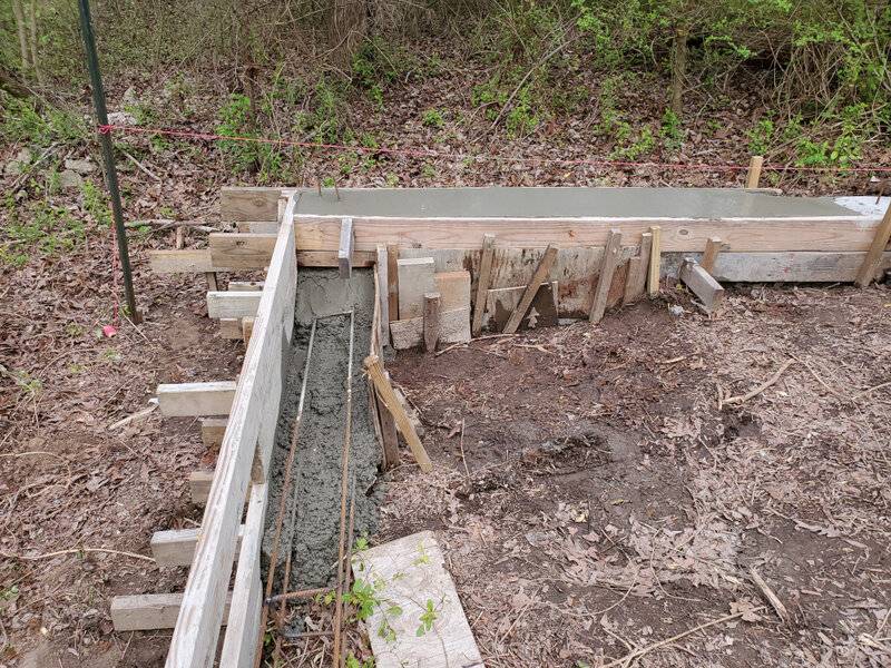

So . . . with some time after work today ( Friday ) . . . I got another rebar cage built and installed,
and some concrete mixed and poured . . .
Worked on the next section and made it around another corner . . .
Now we're on the backstretch . . . and heading home . . .

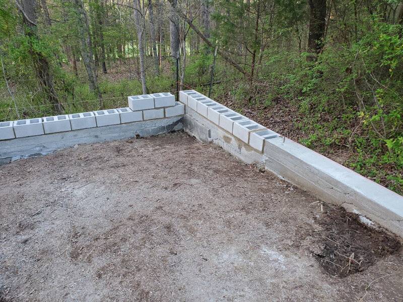

Bringing it all up to one level . . .

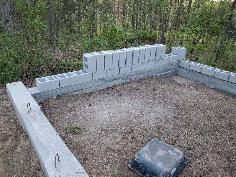

With the 2 drops that I had to do, now I've got to bring them all up to level . . .
The back wall had a double drop, so I've got one level completed . . .

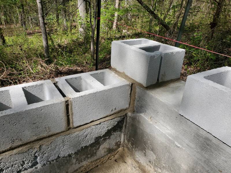

And I also go the two back corners mortared in place . . . and they are spot on for their measurements.
Side wall are 18' 1 " . . . Back walls are 22' 1" . . . and the diagonal is 28' 6 1/2 " . . .

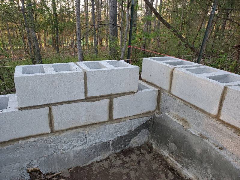

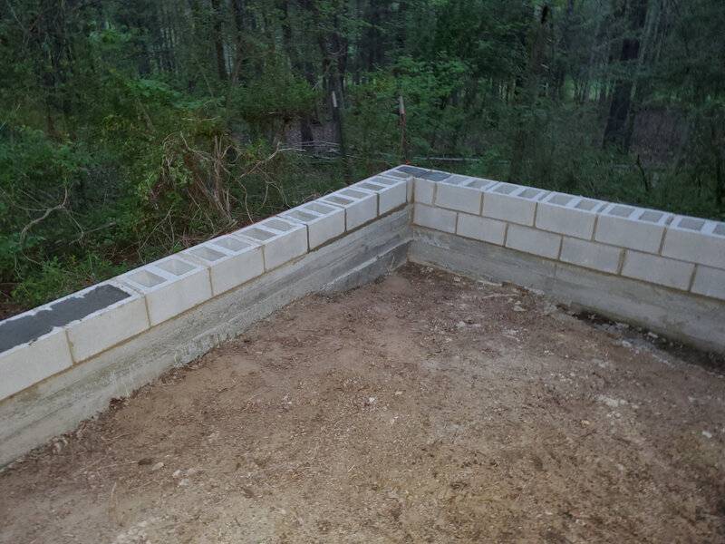

ERROR on my part . . .
Missed the fact that the corner blocks "should" have been rotated 90 degrees to get my running bond . . .
So . . . I'll just have to piece a half block in (both side) to make it work . . . it can be fixed . . .
As you can see, the side wall is now up to level . . . and I've started on the back wall . . .
Got all my supplies . . . and ready to get the back wall, and this other side wall done tomorrow . . .
Hate when I do that . . . mess up . . . but it can be corrected, just was too far along when I realized.
Didn't want to break the block free as it was already setting and in the proper location and measurements . . .

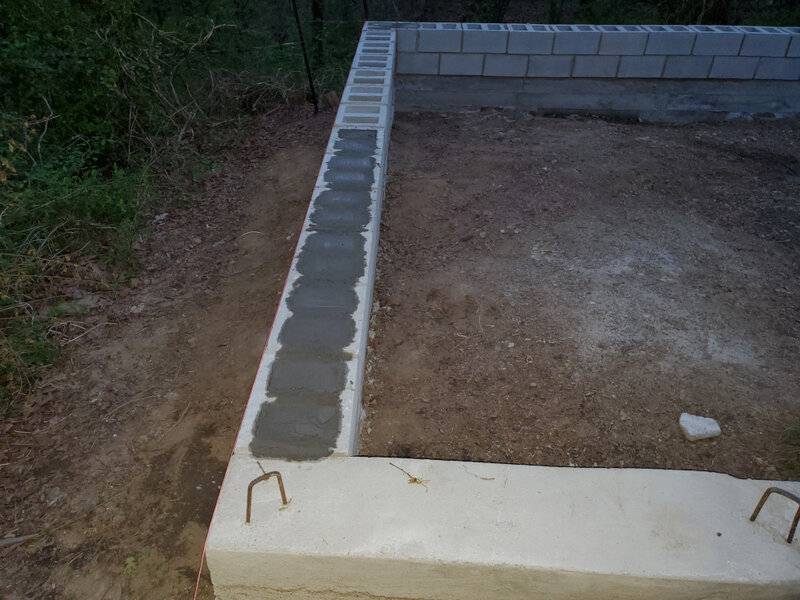

Saturday after lunch, mixed up a batch of mortar to finish this left side wall . . . and I was short . . . ARGH.
You can see the last 3 blocks have wet mortar . . . they were done Sunday night to complete the 12" blocks
Also emptied out my supply of concrete mix and filled all the openings in the blocks that I could . . .

- finished filling all the 12" blocks with concrete
- finished most of the 2 courses of 8" blocks . . .
- got some of them filled 1/2 way with concrete . . .
This side wall was only 1 course tall . . .
But this side is completed . . . and around the front too . . .
Got home from work today . . . and finished up this second course . . . only 1 1/2 block needed to complete it . . .
