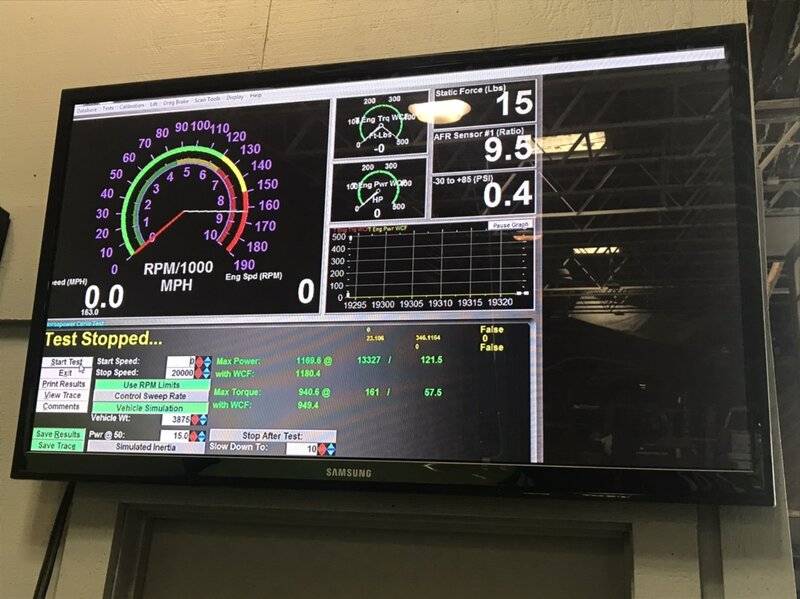

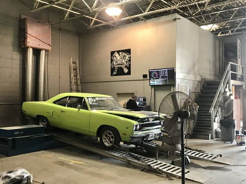

Forced induction guys, where ya at?
Dyno day to sort some things out
F58A7836-1ED6-45C1-AF78-2DDA10025DF8.jpeg 0C8E396E-38BC-4FC1-9CAD-B19837C94EAF.jpeg
great #'s congrats
Excellent numbers! My build is still in the tuning stages, but I got to drive it a bit last summer. If I can make it to 15# this year and it seems happy, I'll dyno it. I expect it will make 750+ to the wheel easy enough, maybe a bit more.
