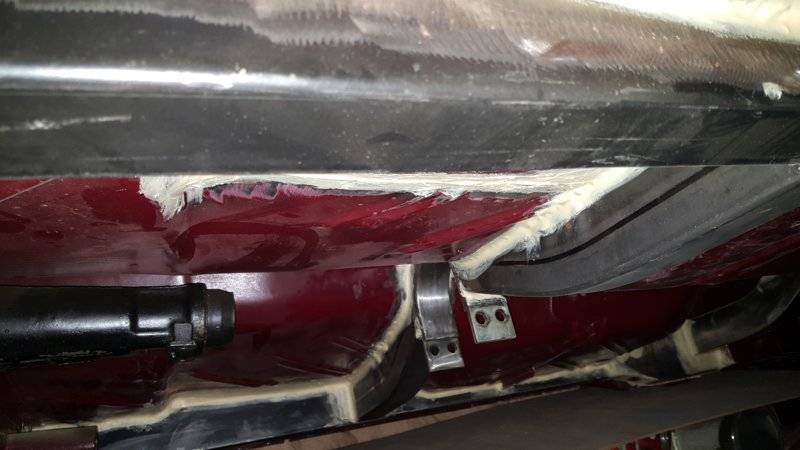

Installed weld in on my 65 coronet convertible, I brought it back east from a western state but roof was rotted so it filled w/water when it rained - I put new floor panel in & sliced them front to rear, welded solid front & back after relocation spring kits and super stock spring mounts , I only spot welded floor pans every 1-1/2" then sealed/bonded with urethane adhesive to seal and give a neat finish, I also added 2 additional 2×3 crossmembers rocker to rocker and reconfigured front/tranny mount area for strength & front and rear shaft safety loops , convertible is equipped with torque boxes already - I installed front & mid plates , now I'm trying to talk myself into front rail bars to my firewall and lower rad support ? ( I really like working on my toy, probably more than driving it ) , what fun !! Stronger the better for my 440 Max clone !!
