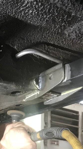

We did 2"x2" in my '63. We cut open the front of the rear framerails and slid them in a bit for overlap before welding. We also welded a plate to the front crossmember to attach the tubing. It was amazing how much difference it made! I can put a jack under any corner and still open the doors! I don't like cutting up a solid car more than you need to but this is one of those mods that do nothing but improve a car.
To make that a bit better, if you open the front of the rear subframe, slide the 2x? in 3-4 inches with a hole drilled on each side of the stock subframe & do a rosset weld each side of the subframe to the 2x? inside in addition to the weld at the front opening on the rear subframe. Really stiff.

I have done what you describe countless times....not going into the floor. A section of 2 x 4 sq. tubing welded from the rear to the front.....it's pretty straight forward and any decent fabrication shop could do it easily. They fit pretty close to the floor and "Can" be tack welded to it if desired, but not mandatory. Just be absolutely sure the car is level and supported under the wheels or suspension as it would sitting on a level floor and you'll be amazed at the difference. It's a simple job and would be the first thing we would recommend. Good luck with your project.

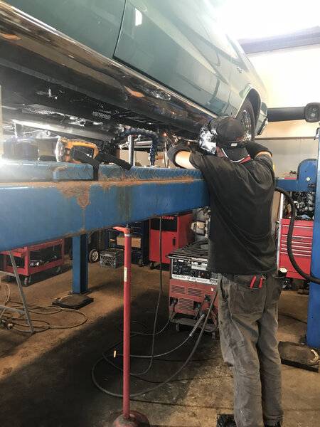

I've owned the Dart for about seven years and recently updated the interior. While the seats and carpet were out I had USCT SFCs welded in. It's been back on the road for two weeks and its a noticeable difference. In the beginning I thought it was me just expecting to feel a difference. Yesterday I took the Dart on its first long trip, 75 miles roundtrip to and from work. I'm on the freeway and I look at the speedo and I'm doing 85 mph. In the past, 85 felt like 85 with all the squeaks and moans. Yesterday, not a peep. BTW, the Dart has a 360/380 hp crate motor so you don't need mega hp or torque to appreciate SFCs.

I can send you instructions. In a nut shell get a pair of 2x3 stock fish plate the sides of the sub frames. Fit the stock into subs then cut 2 holes on each side mig the plates to the out side of the subs. Fish plate front and cut two inch hole and rossette weld the plates to subs.

I weld all of mine to the floor, to me it makes for a far more solid/strong. I know that with my Cuda which has a USCT SFCs on it they are as solid as any part of the factory frame.
