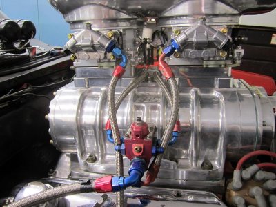

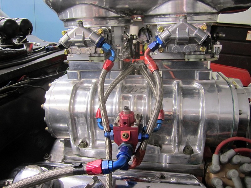

Plan your system for where you want to end up.You can NEVER have too big a fuel pump when using a regulator and maybe a return line.
I've got this feeling that you look at threads and think "hmmm.... where can I throw a picture of my badass ride at" :thinker:
at least that's what I'd do if I had your car :headbang:
Unless you plan to make a lot of HP I'd save yourself the trouble and just replace the 5/16" line if the original is damaged. If no damage then leave it there.
I'm with Meep-Meep, you can run quite a bit of hp with 5/16 line. Spend your money on go fast stuff :jerk: til you need more fuel.
Since it's my only old car,what else would I have pictures of??
My opinions might not always be right,,,,,,,,,but they're mine.:icon_kidra:
Hay if I had it I'd be throwin it up everywhere too.
showoff. lol
