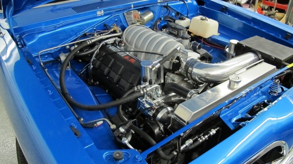

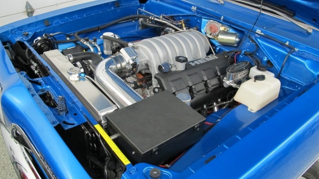

I used the Corvette regulator for my 6.1 "SRT8CUDA" Barracuda project. I'm using the FAST system and I added the optional fuel pressure transducer. It feeds the actual fuel pressure (at the rail) into the FAST box which adjusts the injector duty cycle to automatically compensate if the pressure goes higher or lower than the reference pressure of 58 psi. I'm reading about 55-56 psi at the rail while cruising so it is obvious that the regulator is not always holding at 58psi. I still have some more street tuning to do but I'm getting pretty close I think.

How were you able to connect the -6an fitting to the OEM Hemi fuel rail?
Russel fittings makes an adapter, its listed for gym crap, but it works on the Hemi.
