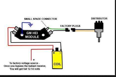

Best & cheapest fix is to get a GM 4 pin HEI for a few bucks & use your present dist to trigger it. The coil you have maybe ok to use with HEI.
yes I thought about that last night I was going to look into the GM unit to see if it would work with the MSD billet which I assume is good. The magnetic pickup should be comparable?
