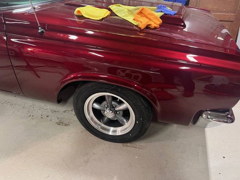

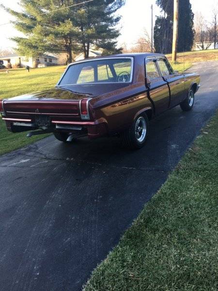

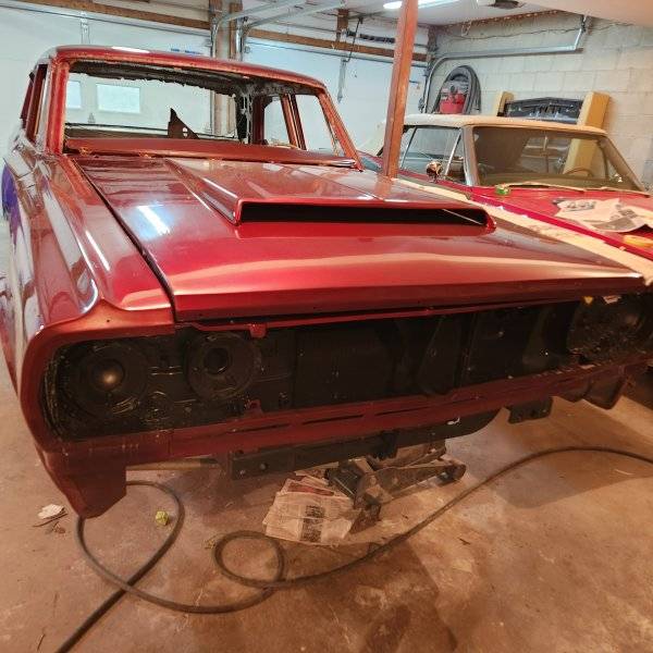

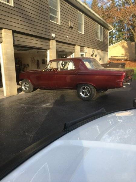

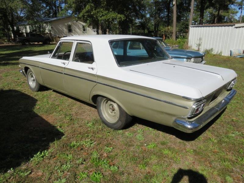

I love the 65 Coronet, and have had 5-6 over the years. Love your 65 More door!! especially in the maroon my favorite all time color!! Here's a pic of my 64 More door Bel. It is getting a satin black roof, mags for the rear, and I will probably fab another MW scoop for it out of 20 ga mild steel.
