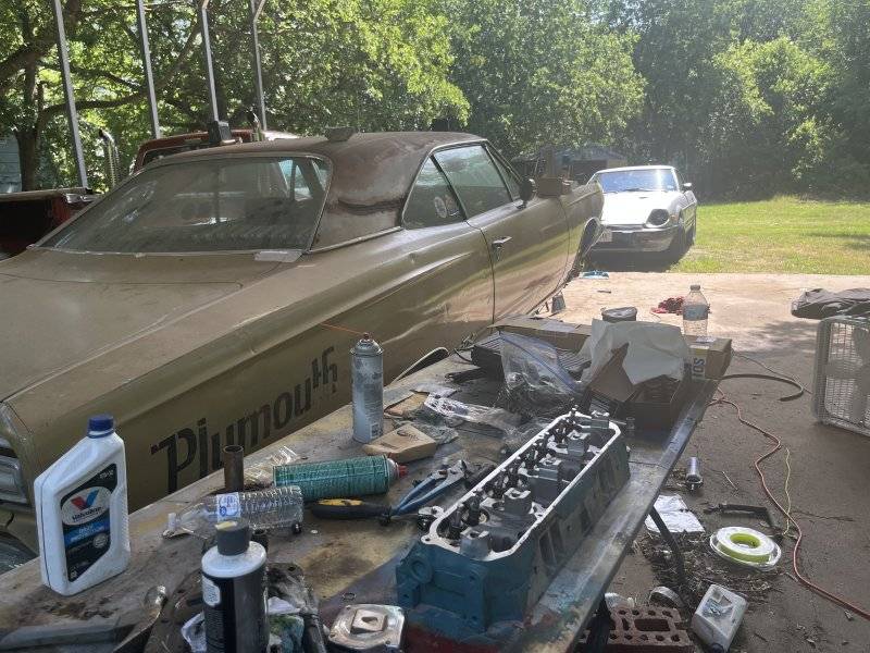

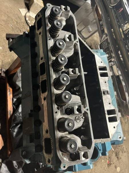

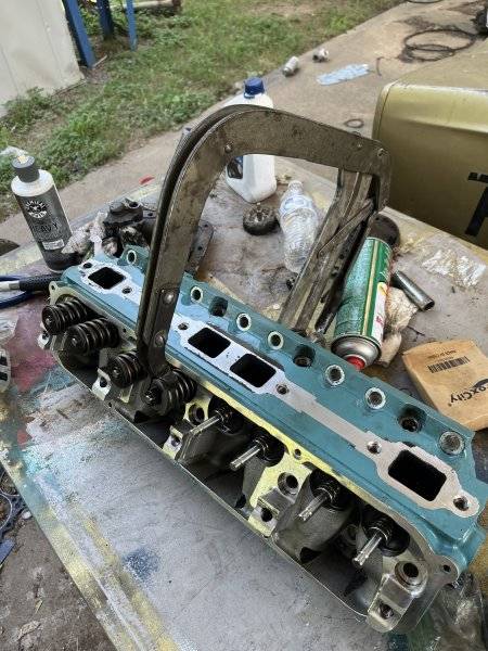

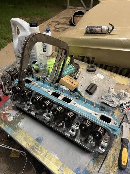

What a great day. Took my lil red express to work, came home and got the valve seals on one head done and bolted the head back on. I don’t know if it was late, I just didn’t see it or what’s going on, but apparently I have a head bolt missing :BangHead:. I stole one from the other head just to get it done though.

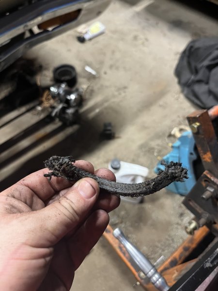

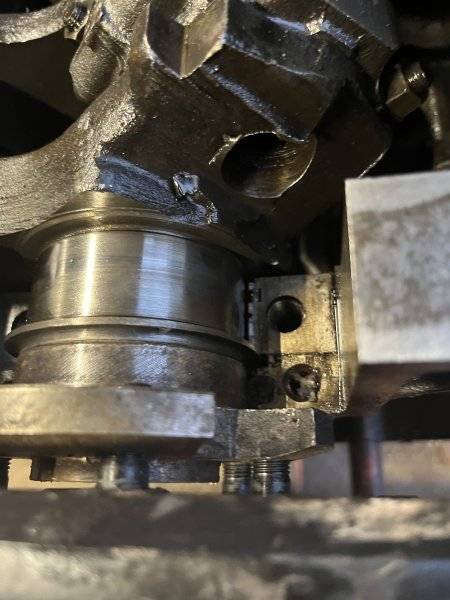

Alright time for the next battle, and the entire reason I pulled the engine. The one. The only. The dreaded real main seal!! :lol:
Well poo. I either lost the new seal, or I forgot to order one. Either way I am unfortunately done for tonight. Still getting the old seal out was a major achievement :drinks:

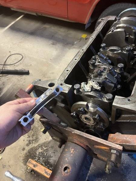

So case in point, I didn’t take the crank completely out, I just unbolted the main caps and lifted it enough to slide it in, probably not the best way, but that’s how I did it. Now it seems number 7 piston is hitting the counter weight. How do I fix that?
Maybe I'm fuzzy from the medication I'm on but why take out the crank? You can replace bearings with the crank in place.
I had a rear main leak when I reinstalled my engine in the red car last year. I just pulled out the seal retainer and fixed what was wrong.
@Kern Dog , I hope you are doing better.
I’m replacing the rear main seal. I’ve had help replacing one in another car with the engine in. But it’s a pain, and I wanted to change the cam, so pulling the engine made more sense. I tried to not touch the crank, just pull the seal, which was the original rope, put the new one in. But after spending a couple day’s fighting it, it was really squished in there, probably why it was leaking, I had to give in and get the crank off it

OOoops! I forgot that you had a "rope" seal in there. I have never actually used one in all of my years so it didn't occur to me the difficulty of removal of one.
Well damn it, it was just a flywheel bolt. It's always stupidly obvious things, and then when you come back and find it, makes you want to bang your head against the wall. Good thing my carport doesn’t have walls

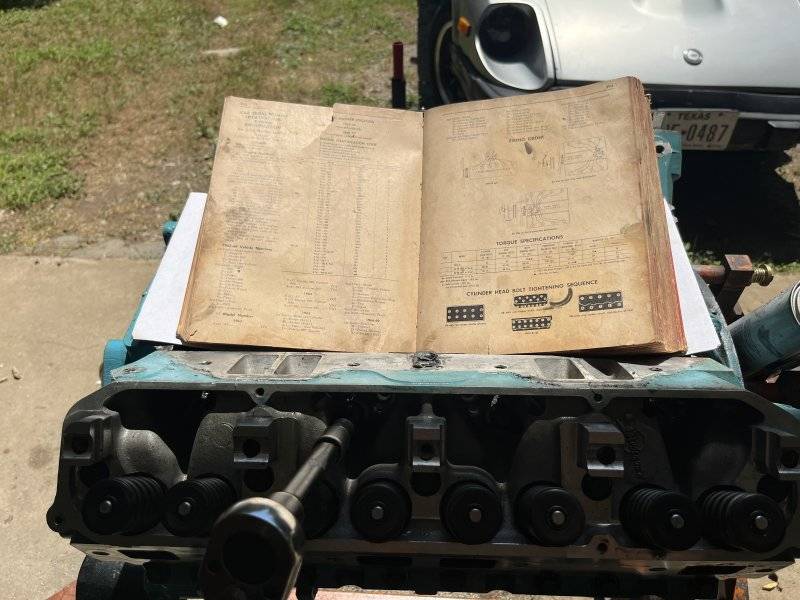

Valve springs changed, head torqued down. Time to hibernate until this evening. Using a 1970 chiltons manual my grandfather bought new. Unfortunately he’s no longer with us, but his knowledge always will be
